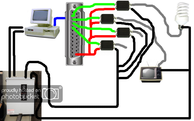

I'm just new here and I have a question. Is it possible for me to have a 220 volts switch using a 3 volts signal? What I'm trying to accomplish is, to switch my room lights on/off using the parallel port DB25 of my computer.

It is indeed possible.
Typically you would use an optocoupler to trigger a triac.
It's not quite that simple, and it's not something you should try unless you have experience working with mains voltages.

It is somewhat safer to use the low voltage output to cause a relay to close, and use the relay to switch power.
However, the relay will require more power than you likely have available on that signal output, so you will require a separate power supply. The optocoupler will only require that your signal output can supply (say) 10mA.

Uhuh... I hope I got it right. I'll use optocoupler to switch my lights on/off.
Instead of using this one
I'll be using this one
By the way, my concept is this...

Last night I arrived to an article at wikipedia [http://en.wikipedia.org/wiki/Opto-isolator] which describes what Opto-isolator is. Then ended up consulting the google and arrived here [http://www.electronics-tutorials.ws/blog/optocoupler.html]... And this image struck me
it says photo-transistor, can this handle 220volts? (Sorry, I'm a newbie)

The photo triac could be the right component for the job. See for example here: http://www.semicon.toshiba.co.jp/docs/catalog/en/BCE0034_catalog.pdf
Besides being able to handle 220 V, you have to take into account the current you want to switch.

I said it wasn't that simple, right? :)
At the very least you'd ned a series resistance before the optocoupler (you may need another source of power as well in some cases.
AND the optocoupler can't switch a lot of current, so you'd need to use it to switch a meatier device (like a triac).
Oh, another option is a SSR (solid state relay).
(And Harald's suggestion is also good)
There may be other things you need to worry about depending on the load. Also, you're playing with voltages that can kill you so I doubt your college engineering department is going to say "sure, experiment in your dorm room!" :)

Thanks. But I'm more interested in switching the lights thru a remote device (like android...) I think parallel port db25 can handle it. It has 16 output (well, typically 8 but depending on the configuration). Anyway, thanks for the first link.

You will not need a lot of hacking. Connect GND from the printer port to GND of a USB cable. Connect the controlling signal from the printer port to VUSB (+ of the USB cable). Do not connect D+ and D- (data lines) of the USB cable.
Now when you program your controlling signal of the printer port to LOW, the voltage on the USB cable will be ~0V. Thus the extension cord will switch off.
When you program the controlling signal to High, the extension cord sees ~3V...5V on the USB and will turn on.
The only thing I wasn't able to figure out from the description of the extension cord is how much current is drawn from the USB cable to activate the switching mechanism. You will want to find that out before you invest in the extension cord.
Note: for someone not experienced in handling high voltages and currents (that doesn't necessarily imply any of the contributors to this thread :D ) this may be one of the safest way to go about this. Handling voltages as high as 115 V or 230 V is very dangerous and can be lethal. If you don't know what you do, better leave your hands off.

No, please reread my post. Nowhere did I state that the USB cable should be connected to a USB port. In fact, you may definitely not connect this one cable to any USB port of the PC. You need it only to adapt the logic signal from the printer port to the USB port of the extension cord.
The simple way to avoid any wrong connection would be to cut off the PC-side of the USB cable which makes it easy wiring this end up to the printer port. You now have no longer the USB connector to plug into the PC,
Remember, this all wokrs under the (reasonable) assumption that the extension cord only looks for USB power. Otherwise you'd need controlling software on the computer. But the description doesn't say so. It only says that all devices plugged into the extension cord will be switched on as soon as the Computer is switched on which can be easily detected by looking at the USB power suppl:
PC off -> no USB supply
PC on -> USB power supply available
All I propose is to mimic this behaviour by (ab-)using the parallel port pins.

Just to butt in.
If I were doing this and I was tempted to use a parallel port, I would get a USB to parallel port adapter.
Safer for your computer, easier to replace, and has a known source of 5V.
