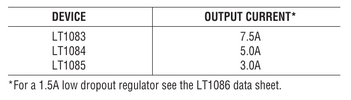

Hello,
If you need an even higher current as 3 Amp, there are some LT regulators that go upto 7.5 Amp:
  • LT1083_LT1084_LT1085.pdf
