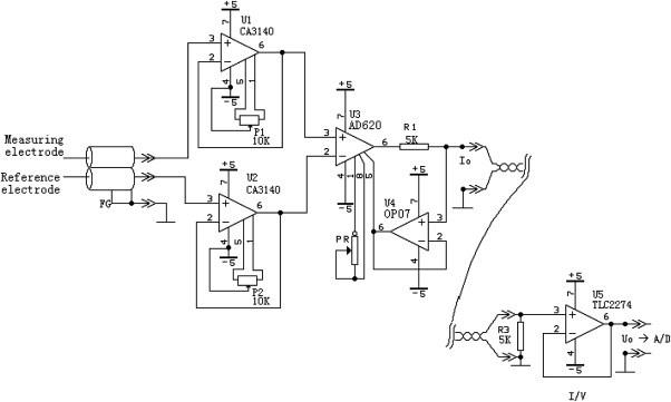

Dear all,
I'm an art student, I'm building a circuit that monitors electrical signals in plants, and I'm trying to read it with an Arduino.
The circuit I found is this:
Description: "The signal from the electrode was transmitted into a CA3140 impedance converter,which is an integrated circuit operational amplifier that provides very high input impedance, very low input current, and high speed performance (Intersil Corporation), and is then connected to an AD620 amplifier. After amplification, the amplitude range of the electrical signals was 4000mV. In the greenhouse, the distance from the detection site to the computer is 30m, so a voltage to current converter (V/I ) is used so that the signal could be transferred reliably. After the long distance transfer, the current signal is converted back into a voltage signal by an I/V converter."
In my case, I have an Arduino instead of a computer, and it is near to the plant, so I assume that
- I don't need the V/I I/V
- I have to use an Op Amp Summing Amplifier for arduino, like here:
http://masteringelectronicsdesign.com/measure-a-bipolar-signal-with-an-arduino-board/
Do you have any advice on what would be the best way to adapt the circuit? How to choose the right OPAMP? I tried AD820 with no success.
Thanks a lot in advance!

The CA3140 is being used for its high input impedance. You should use that opamp or an equivalent high impedance amplifier for the front end.
Since you don't want/need the noise immunity of the current output, remove the complete circuit to the right of the AD620s input pins (2 and 3), leaving only the two CA3140 plus the respective passive compnents.
Use a difference amplifier to compute the diference between the outputs of the two CA3140 amplifiers. A tutorial on difference amplifiers is here. You should use a low offset opam for this section to ensure stability.
Your next issue is that the output of the difference amplifier can be both positive and negative. The Arduino's analog input requires between 0...+5V. It cannot handle negative signals. Therefore you need to create a virtual zero and have the signal swing around that level. What this means is:
- Set an arbitrary level (her 2.5V would be suitable) as reference for 0. Voltages >2.5V are then considered positive, voltages below 2.5V are considered negative (V=Vin-2.5V). You now add 2.5V to the output of the difference amplifier. Your output voltage is then:Vout=2.5V+(Vmeasure - Vreference). This voltage is input to the arduino.
- Connect Vout to the Arduino's ADC input, thus Vadc=Vout.
- In the arduino compute Vdiff=Vadc-2.5V=Vout-2.5V (since Vout=Vadc of the arduino) = 2.5V+(Vmeasure - Vreference)-2.5V = Vmeasure - Vreference.
The arbitrary 2.5V zero reference votage has thus been eliminated.
A suitable circuit for adding the 2.5V reference voltage is a summing amplifier[/URL. You put that circuit after the difference amplifier from above.
Note that the summing amplifier is inverting!. Therefore yu need to add -2.5V to create a +2.5V output offset. You may also want to swap the inputs of the difference amplifier in order to keep the difference in correct polarity after the summing amplifier. Alternatively you can swap the sign with the math routine of the arduino.
The opAmps for the difference and the summing amplifier are not critical, even a humble LM324 could be sed.
