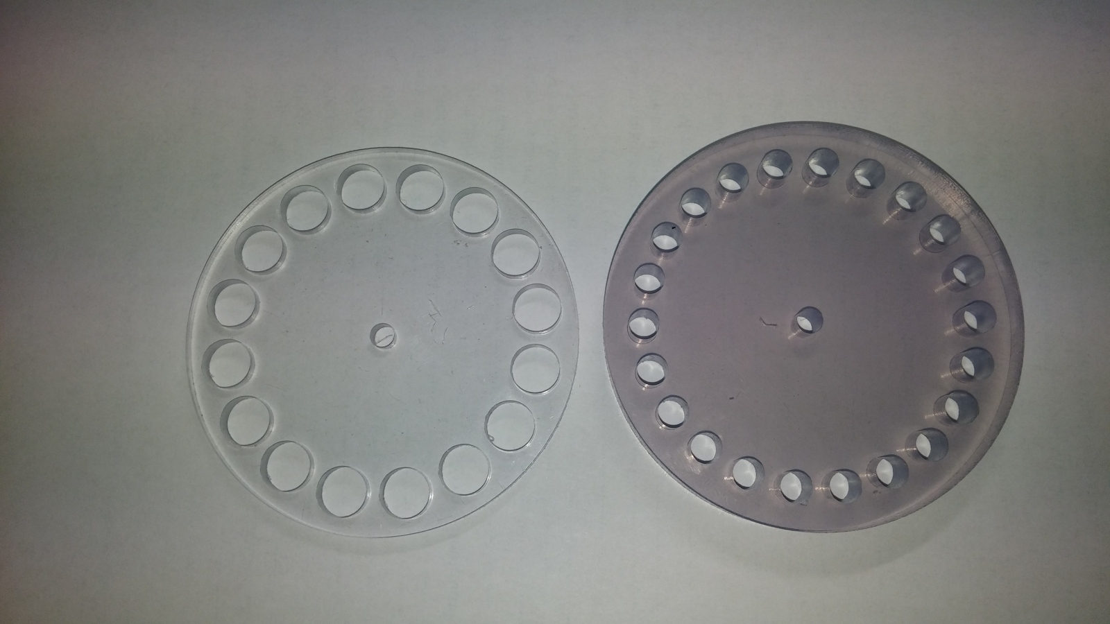

Yeah, i saw Halbach array, but i have only cylindrical magnets now, so there are only two positions for the magnets. What is stronger than N52 ? Maybe bigger N52. There are another device with battery and i want to comunicate with him (thats why i need wireless). Perfect would be 8 pulses in one rotation from RF, 4 pulses are satisfactory, but i will happy if i make at least 1 pulse per rotation. Faster rotation would help, but the average cyclist pedals at about 60 rpm, and advanced cyclists pedal at much higher cadences, from at least 80 rpm to more than 100 rpm. So i can't make experiments with 200rpm for example...Can one coil cover 2 magnets, one of P and other of N ? Will paint few variants of magnets and coils with solidworks for forum members opinions. I have another ring (waiting for bigger magnets for testing).
Need to find correct coils positions, and correct coil sizes. There is AC, circuit requires DC. Another problem how to rectify such low voltages. With shottkey there are about 0.6V voltage drop. Found this http://digitaldiy.io/general-electronics/552-a-no-voltage-drop-bridge-rectifier.html , but I have doubts about that "perfect" bridge.

I think the sine on oscilloscope was not perfect because of not ideal positioning of coils. And it is bad, that coils are differents ? Because when i winding it, there are a lot of turns, and i do not count it.

Do you say that this arrangement:
would work better than this one ?
[img=http://s11.postimg.org/vdb4dq5lr/image.jpg]
Take a look at the top arrangement. There is a huge improvement that can be made.
Look at the axis of rotation, and the path the magnets will take when they pass each coil.
If the magnets spin clockwise, they will travel 'across' the first coil, and 'along' the second coil, then 'across' the third at a different angle.
You want each and every coil to have the same orientation in relation to the path of the magnet.

Gryd3, great advice ! Maybe then the signal would be with less noise and more magnitude ! It is very expensive to do differents magnets holders from PVC for every idea. I think will do PVC holder for coils, then i will achieve perfect orientation and minimal airgap between magnets, no matter how it costs... Naybe someone have advices for coils winding ? How to wind all coils identically ?

One thought about that orientation. Lets say i positioned coils that the magnets will pass it with same angle. But...I think the coil area is smaller than post #27 second picture. This will affect output. Or i'm wrong here ?
I don't know quite enough details to determine if and how the cross section area of the coil will affect the output...
Of course, you could try making a couple of sample coils to find out:
Take the plastic casing from a Pen and wrap the wire around that as an example, then try the same thing with the casing from a marker or highlighter.
Cheap components. Will cost you wire, and maybe a few cents for the pen/marker.
Here's where it gets tricky though... the same number of turns in a smaller coil will have a different inductance and length of wire than the larger diameter... again, I'm not quite familiar enough to determine exactly how this will affect performance. I know about enough to know that more turns will provide a higher voltage output, and that the coils should be wired in parallel if you were to use the arrangement in the second image on post #27.
