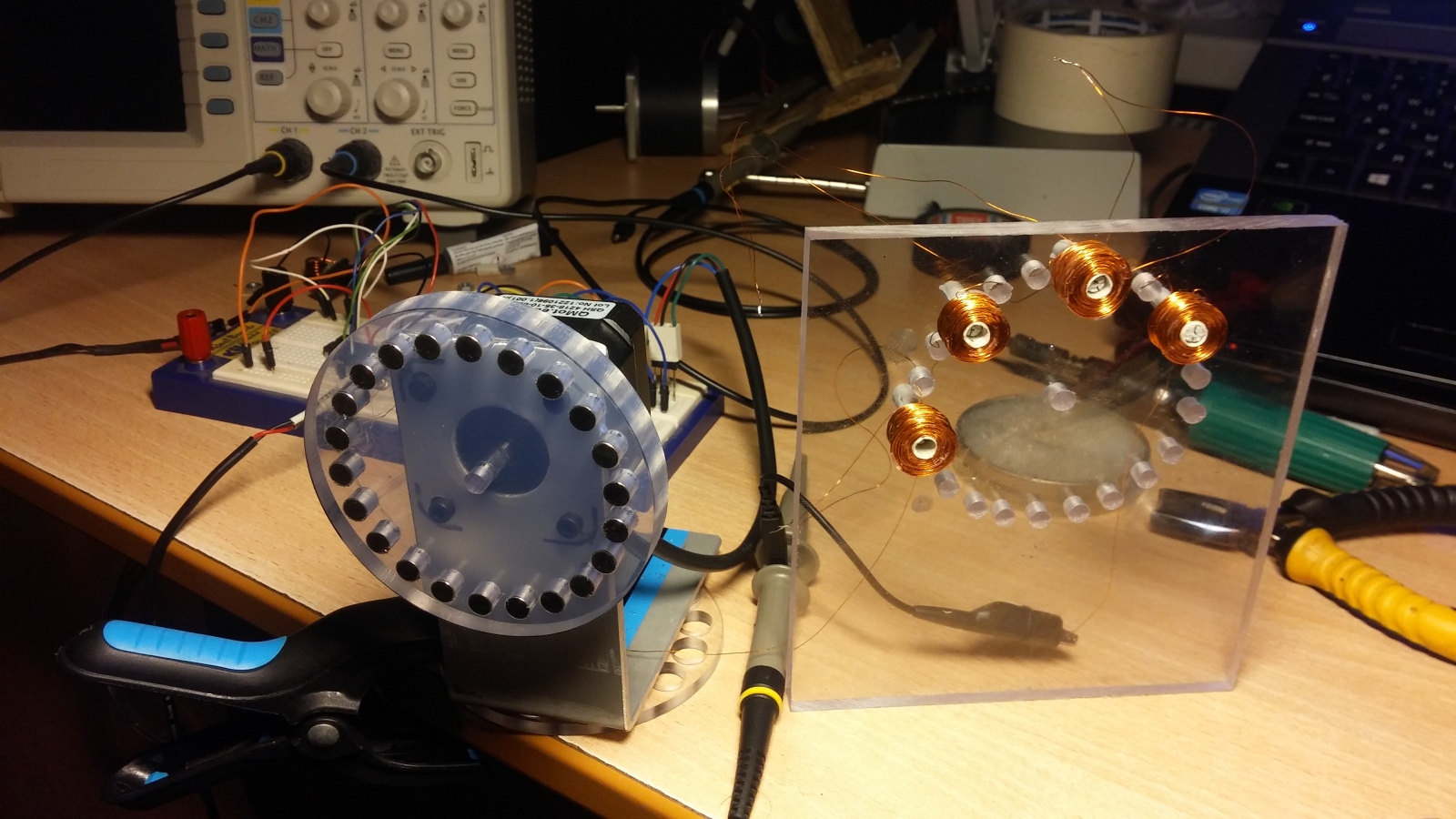

Here is my setup. 22pcs Neodynium N52 6x10mm magnets around PVC 80x10mm circle. Every second magnet is reversed direction. Want to see magnetic field lines. Can anybody help to do that with QiuckField software ? :)

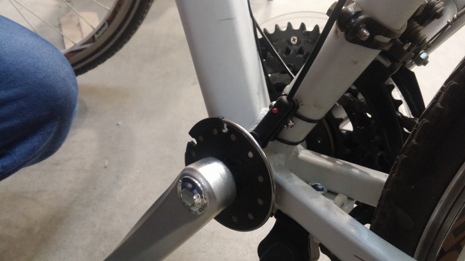

So...Starting from the beggining. I have "thing" which need pulses to work. Now the sensor looks like this:

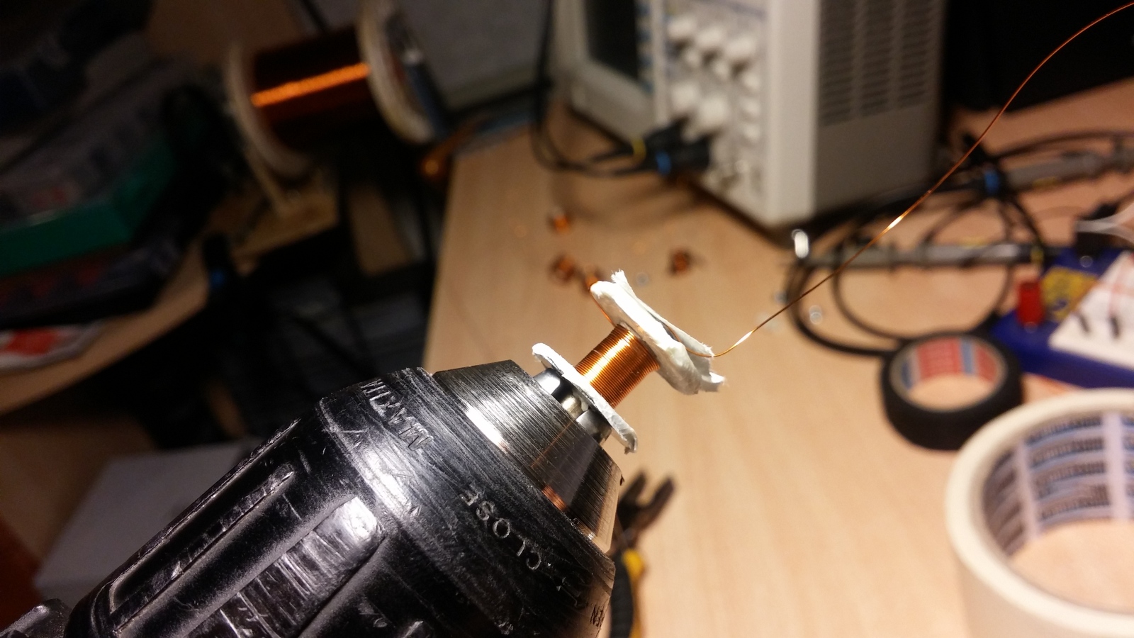

I want to do same thing WITHOUT battery and WIRELESS, or there can be battery, but it must be charged when axis is rotating. My idea is : magnets + coils act as generator for low power MSP430 or Atmega328P, that will send signal using low power RF module. Of course, there power management circuit is needed. Now i'm making some experiments, because lot of things are still unclear. Tried to wind few coils with 0.2mm thick cooper wire:
Whole setup consist of stepper motor that rotates about 1 revolution per second, 22pcs N52 neodynium magnets (6x10mm) in plastic round holder (diameter 80mm) and my winded coils. Photo:

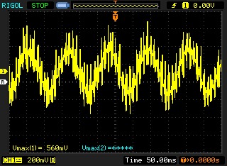

Every second magnet is reversed, so pattern is N P N P N P.... Voltage curve that I got today with 4 coils:
560mV AC was the maximum voltage. Before tried I extpected to get at least > 1V. The cooper coils should be in a half circle (because of construction on bike).
So...i need help with it. How to get more power from that setup ? How to calculate size of coils for that magnet construction, and what should be position each coil in view of magnets. Sorry for my poor english, hope it can be understanded :)

To make more power... You need stronger magnets, more turns on the coils, or a faster rotation.
Considering your bench setup (Good job by the way)
You should make a few different pickups with different cores, and different number of windings to see which performs better for your target speed.
Additionally, try getting them closer together.
Edit: Try re-arranging the magnets.
http://en.wikipedia.org/wiki/Halbach_array
Will strengthen the field on one side of the array.

1-Looking at pictures there appears to be no core. Putting in an iron or ferrite core should give a big increase.
2- If using more than 1 coil, then
use 2 set exactly the same spacing as the magnets
magnets alternate polarity
join the backs of the coils with more iron or ferrite
if possible join the backs of the magnets with ferrite
3- If you still need more voltage, increase the number of turns (use very fine wire)
