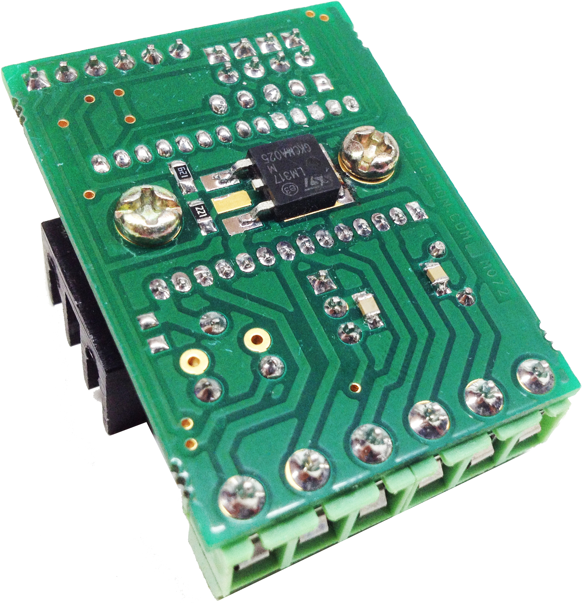

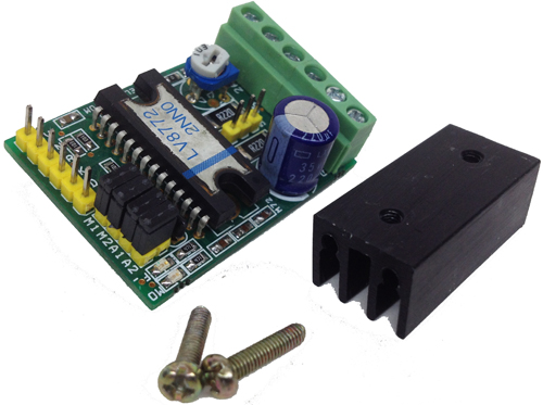

Tiny Board has been designed around LV8772 IC from On-Semi. This driver is capable of micro-step drive and supports 4W 1-2 phase excitation.
PIC
Tiny Board has been designed around LV8772 IC from On-Semi. This driver is capable of micro-step drive and supports 4W 1-2 phase excitation. It has Low on Resistance with motor current selectable in four steps. The board is equipped with unusual condition warning LED and input Pulse Monitor LED. It is most suitable for the drive of a stepping motor for OA, amusements, hobby CNC, 3D printers, automatic machines, linear guides, motion control systems, XY gantry, Camera focus and zoom controller, Mini camera Pan Tilt Head.

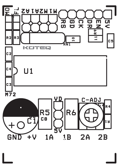

Connections
CN1: Power Supply In
CN2: Bipolar Stepper Motor Connections
CN6: Control Signal Inputs ( All inputs are TTL Level)
  • Pin1 5V :  DC Aux ( Output)
  • Pin 2 ENB : Enable ( Default set to Enable , Required low input (Pull Down) to disable)
  • Pin3 CK : Clock input to excite the motor ( Pulse Inputs)
  • Pin 4 : GND Ground Signal
  • Pin5 : RS : Reset input
PR1: Onboard Preset (Potentiometer) to set the Current
D1 : Fault LED
D2 : Pulse Monitor LED
CN5 : Aux. Power Supply Output , Supply 24V, 5V Regulated, Ground
M1, M2 : Jumpers to set the Micro-stepping
A1,A2: To Set the Motor Holding Current  (A1=ATT1, A2=ATT2)
