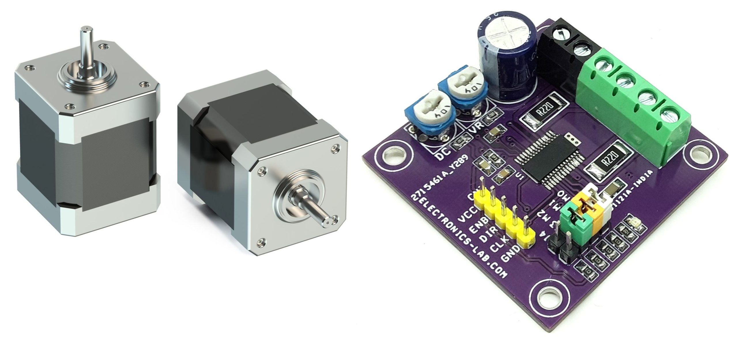

High-performance, High-reliability Bipolar Stepper Motor Driver

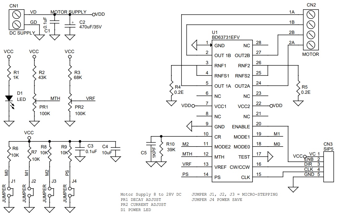

The project presented here is a bipolar stepper motor driver. It is based on BD63731EFV chip which is a low-consumption driver that is driven by a PWM signal.
The project presented here is a bipolar stepper motor driver. It is based on BD63731EFV chip which is a low-consumption driver that is driven by a PWM signal. The power supply voltage of the project is 8 to 28V DC, and the rated output current is 3A. CLK-IN driving mode is adopted for the input interface, and excitation mode is corresponding to FULL STEP mode (2 types), HALF STEP mode (2 types), QUARTER STEP mode (2 types), 1/8 STEP mode, and 1/16 STEP mode via a built-in DAC. In terms of current decay, the SLOW DECAY/FAST DECAY ratio may be set without any limitation, and all available modes may be controlled in the most appropriate way. In addition, the power supply may be driven by one single system, which simplifies the design.
- Motor Supply 8 to 28V DC
- Rated Output Current 3.0 A
- Low ON Resistance DMOS Output
- CLK-IN Drive Mode
- PWM Constant Current (other oscillation)
- Built-in Spike Noise Cancel Function (external noise filter is unnecessary)
- FULL STEP (2 types), HALF STEP (2 types),
- QUARTER STEP (2 types), 1/8 STEP, 1/16 STEP Functionality
- Freely Timing Excitation Mode Switch
- Current Decay Mode Switch (linearly variable SLOW/FAST DECAY ratio)
- Normal Rotation & Reverse Rotation Switching Function
- Power Save Function (PS Jumper J4)
- Built-in Logic Input Pull-down Resistor
- Power-on Reset Function
- Thermal Shutdown Circuit (TSD)
- Over-current Protection Circuit (OCP)
- Under Voltage Lock Out Circuit (UVLO)
- Over Voltage Lock Out Circuit (OVLO)
- Protects Against Malfunction when Power Supply is Disconnected (Ghost Supply Prevention Function)
- Adjacent Pins Short Protection
- Microminiature, Ultra-thin and High Heat-radiation (exposed metal type) Package
- PCB Dimensions 45.72 x 45.09mm

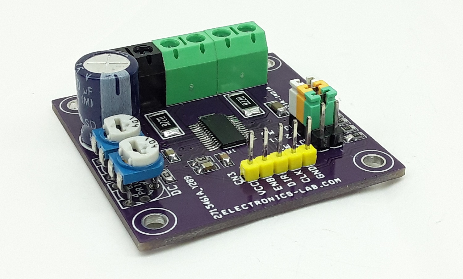

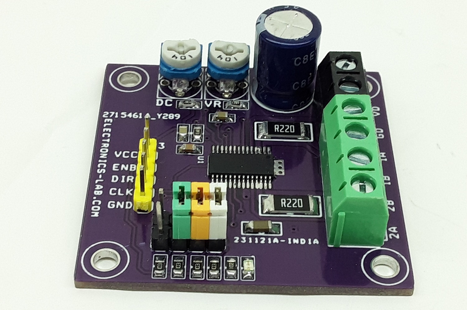

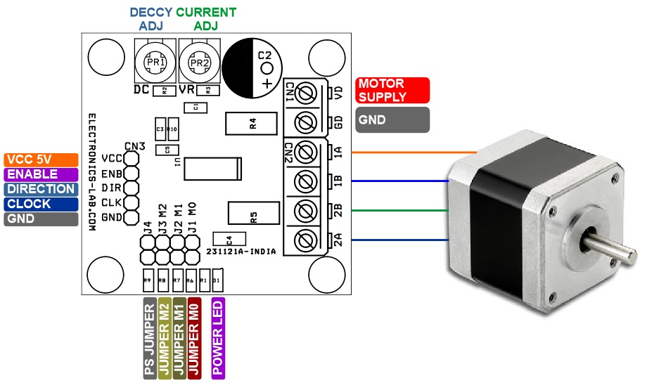

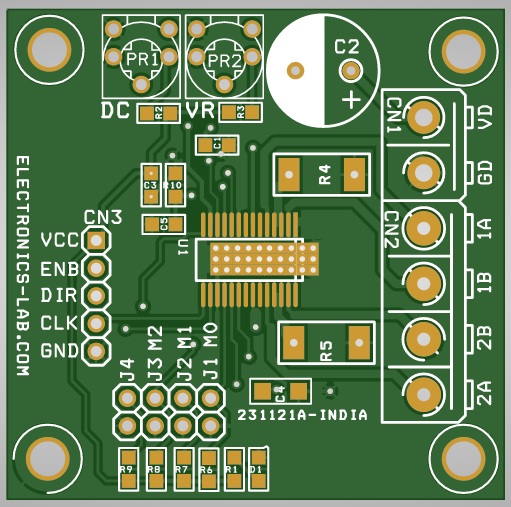

Micro-stepping can be set using the following Jumpers, J1=Mode 0, J2=Mode 1, J3=Mode 2 (Jumper Open = High, Jumper Closed = Low)
- Mode 0=Low, Mode 1=Low, Mode 2=Low >> Full Step A
- Mode 0=High, Mode 1=Low, Mode 2=Low >> Half Step A
- Mode 0=Low, Mode 1=High, Mode 2=Low >> Half Step B
- Mode 0=High, Mode 1=High, Mode 2=Low >> Quarter Step A
- Mode 0=Low, Mode 1=Low, Mode 2=High >> Full Step B
- Mode 0=High, Mode 1=Low, Mode 2=High >> Quarter Step B
- Mode 0=Low, Mode 1=Low, Mode 2=Low >> 1/8 Step
- Mode 0=High, Mode 1=High, Mode 2=High >> 1/16 Step
Connector CN3
- Pin1 = VCC 5V Logic Supply In
- Pin2= Enable (Pull High= Enable, Low = Disabled)
- Pin3= Motor Direction (High=CCW, Low CW)
- Pin4= Motor Clock Input (Pulse Input)
- Pin5= GND
Connector CN2: Bipolar Stepper Motor Connections
Connector CN1: Motor Supply Input 8 to 28V DC
LED D1 = Power LED
PR2 Trimmer Potentiometer: Motor Current Adjustment = 0 to 3V
Jumper J4 PS/Power Save Jumper J4
The PS pin can make circuit in standby state and make motor output OPEN. In the standby state, the translator circuit is RESET (initialized) and the electrical angle is initialized. When PS=L to H, be careful because there is a delay of 40 μs (Max) before it is returned from standby state to normal state and the motor output becomes ACTIVE
PR1 Trimmer Potentiometer: Decay Adjust
- 0 to 0.3V Slow Decay
- 4V to 1V Mix Decay
- 5V to 2V Fast Decay
- 1V to 3.5V Auto Decay

Schematic

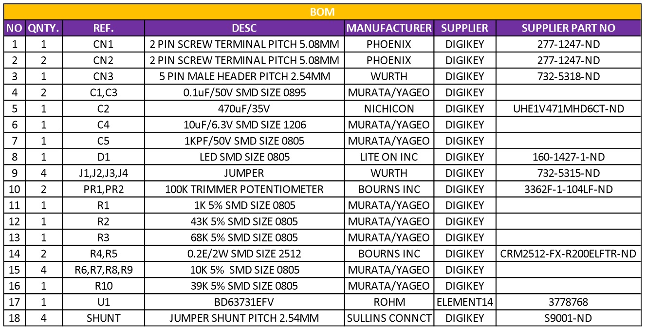

Parts List
| NO | QNTY. | REF. | DESC | MANUFACTURER | SUPPLIER | PART NO |
| 1 | 1 | CN1 | 2 PIN SCREW TERMINAL PITCH 5.08MM | PHOENIX | DIGIKEY | 277-1247-ND |
| 2 | 2 | CN2 | 2 PIN SCREW TERMINAL PITCH 5.08MM | PHOENIX | DIGIKEY | 277-1247-ND |
| 3 | 1 | CN3 | 5 PIN MALE HEADER PITCH 2.54MM | WURTH | DIGIKEY | 732-5318-ND |
| 4 | 2 | C1,C3 | 0.1uF/50V SMD SIZE 0895 | MURATA/YAGEO | DIGIKEY | |
| 5 | 1 | C2 | 470uF/35V | NICHICON | DIGIKEY | UHE1V471MHD6CT-ND |
| 6 | 1 | C4 | 10uF/6.3V SMD SIZE 1206 | MURATA/YAGEO | DIGIKEY | |
| 7 | 1 | C5 | 1KPF/50V SMD SIZE 0805 | MURATA/YAGEO | DIGIKEY | |
| 8 | 1 | D1 | LED SMD SIZE 0805 | LITE ON INC | DIGIKEY | 160-1427-1-ND |
| 9 | 4 | J1,J2,J3,J4 | JUMPER | WURTH | DIGIKEY | 732-5315-ND |
| 10 | 2 | PR1,PR2 | 100K TRIMMER POTENTIOMETER | BOURNS INC | DIGIKEY | 3362F-1-104LF-ND |
| 11 | 1 | R1 | 1K 5% SMD SIZE 0805 | MURATA/YAGEO | DIGIKEY | |
| 12 | 1 | R2 | 43K 5% SMD SIZE 0805 | MURATA/YAGEO | DIGIKEY | |
| 13 | 1 | R3 | 68K 5% SMD SIZE 0805 | MURATA/YAGEO | DIGIKEY | |
| 14 | 2 | R4,R5 | 0.2E/2W SMD SIZE 2512 | BOURNS INC | DIGIKEY | CRM2512-FX-R200ELFTR-ND |
| 15 | 4 | R6,R7,R8,R9 | 10K 5% SMD SIZE 0805 | MURATA/YAGEO | DIGIKEY | |
| 16 | 1 | R10 | 39K 5% SMD SIZE 0805 | MURATA/YAGEO | DIGIKEY | |
| 17 | 1 | U1 | BD63731EFV | ROHM | ELEMENT14 | 3778768 |
| 18 | 4 | SHUNT | JUMPER SHUNT PITCH 2.54MM | SULLINS CONNCT | DIGIKEY | S9001-ND |
Connections

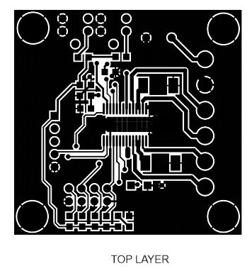

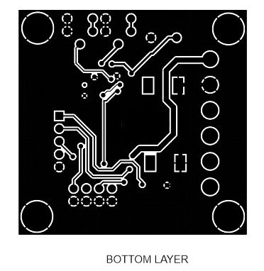

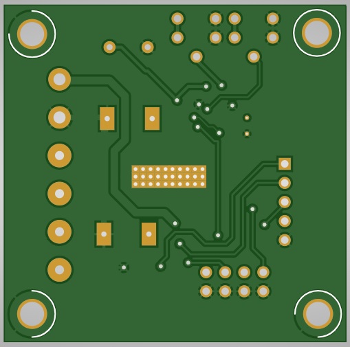

Gerber View

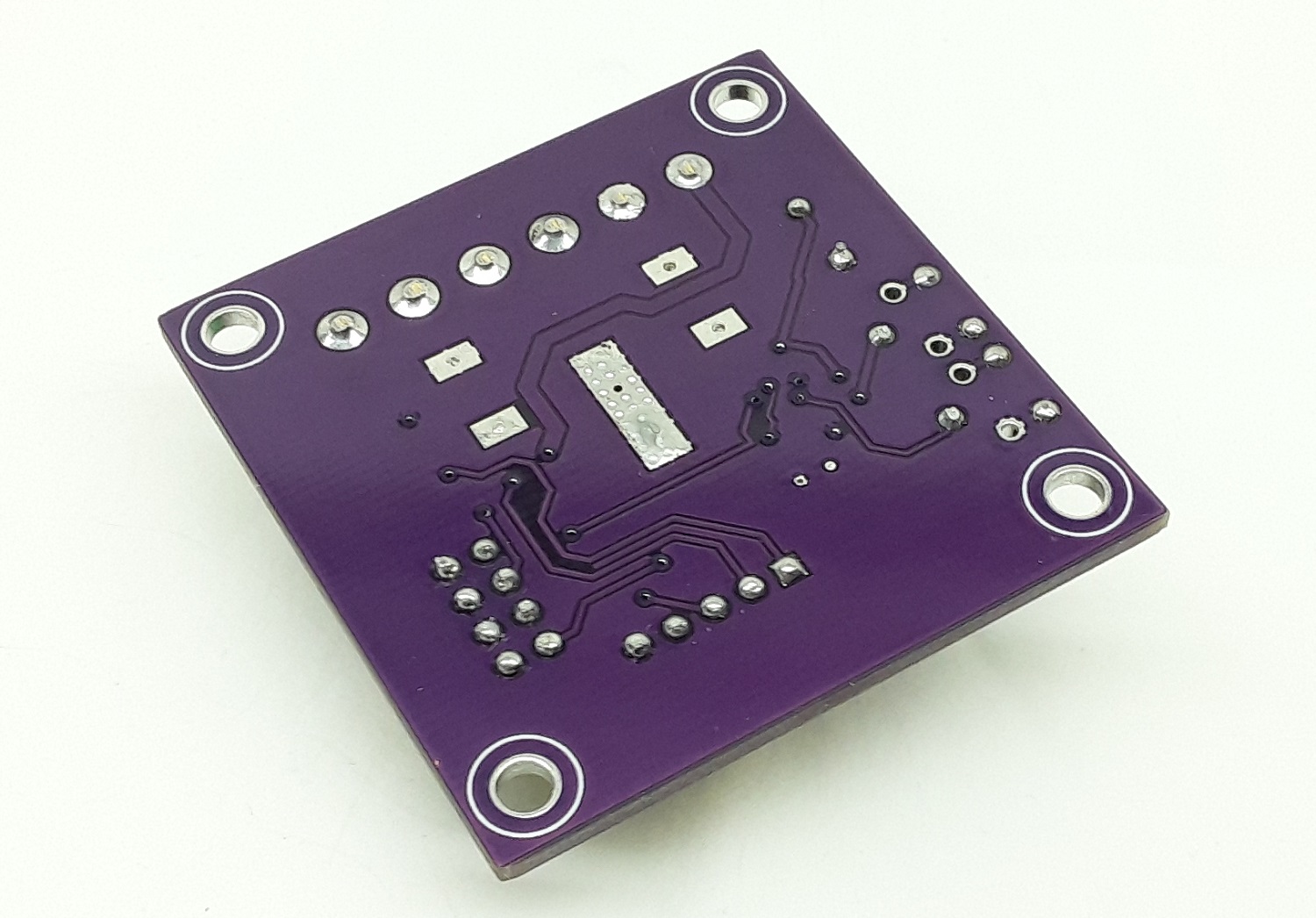

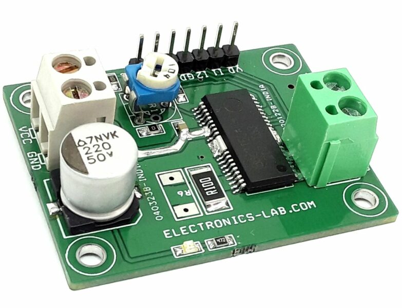

Photos
