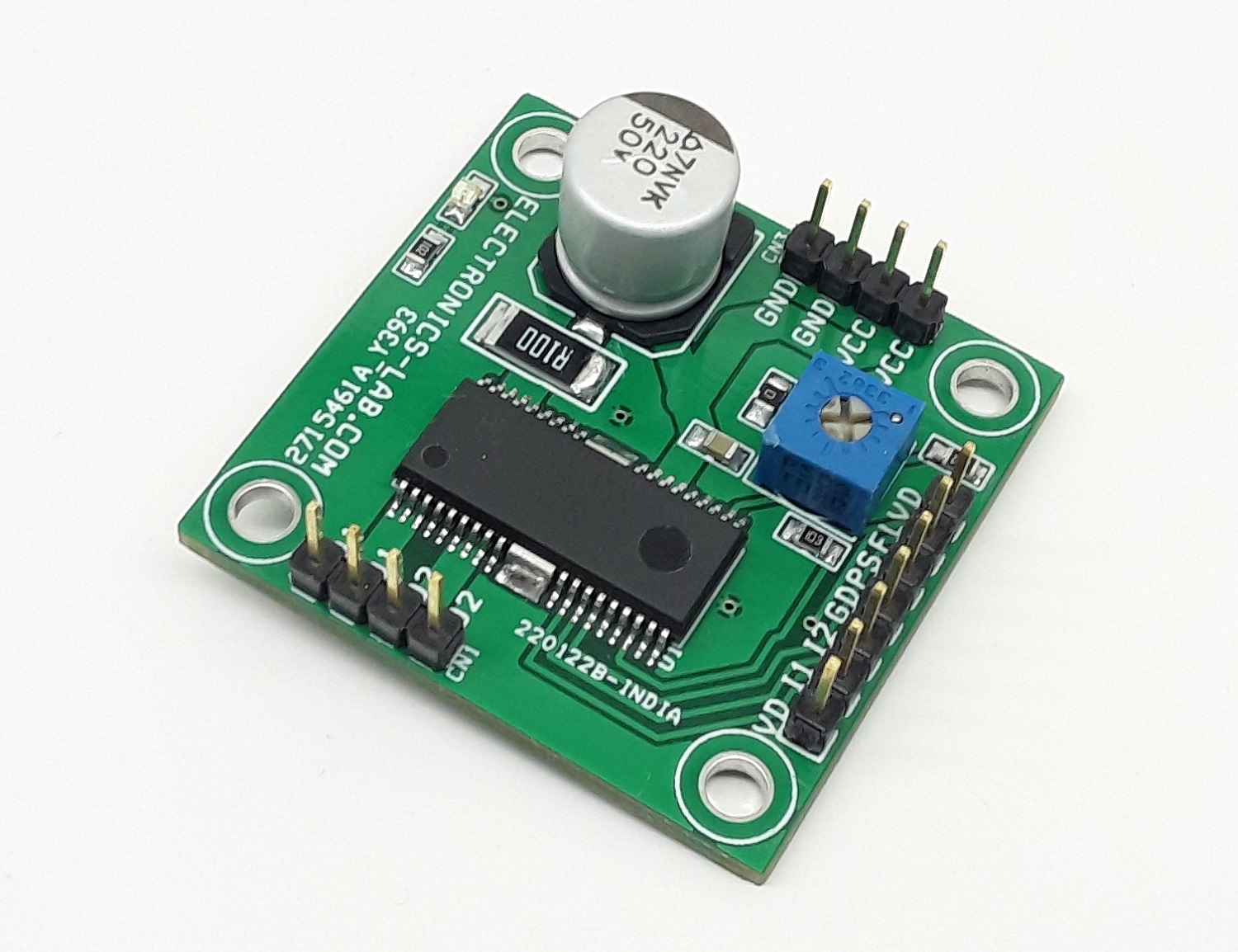

High Performance – High Reliability 50V DC Brush Motor Driver

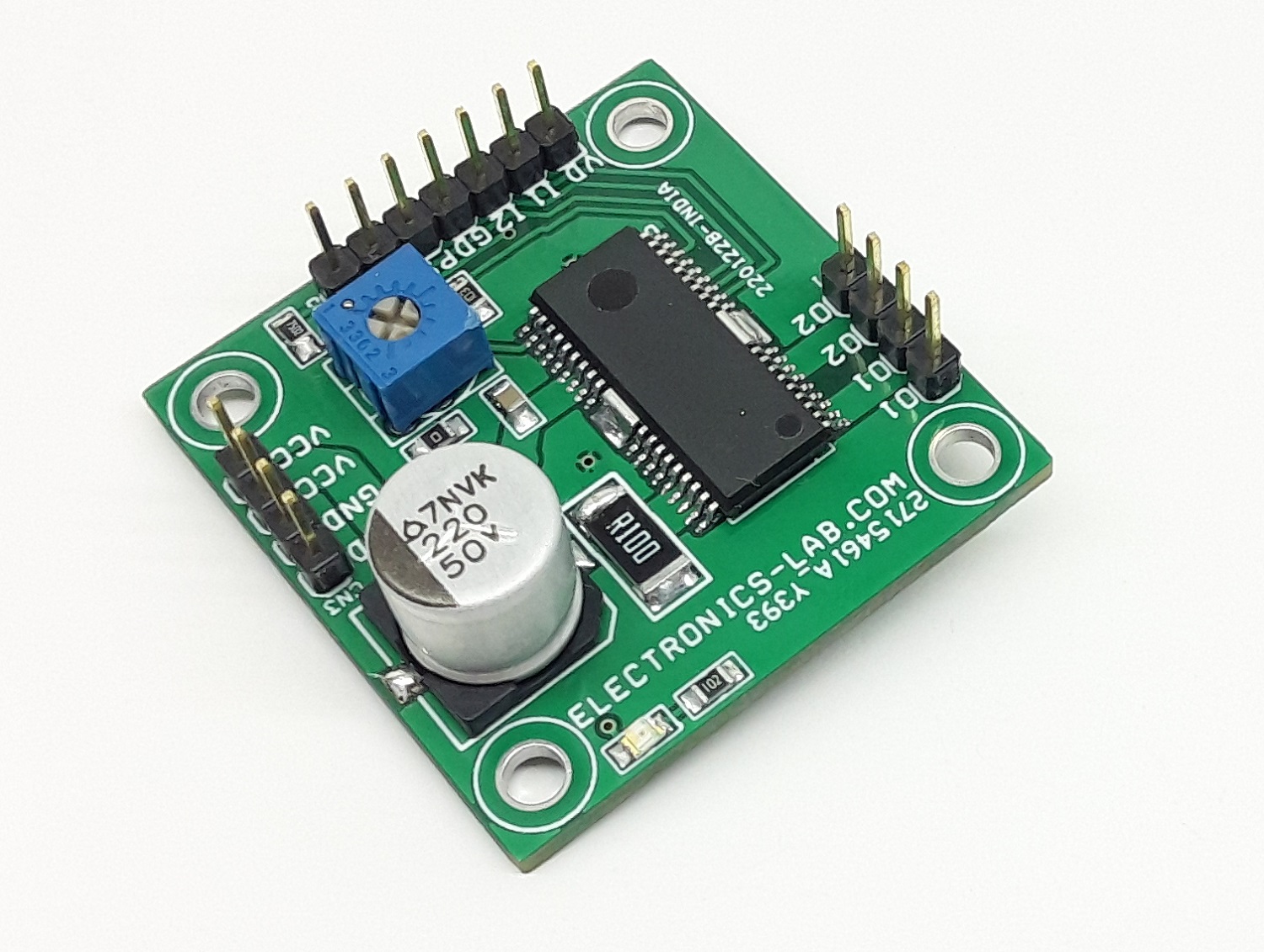

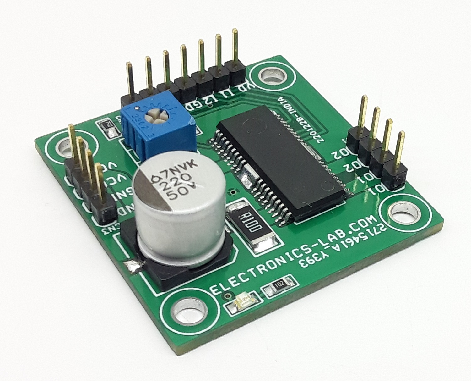

This is a powerful yet small size low profile brushed DC motor drive system with a few key features like adjustable constant current control, direction control, brake controls, Alert output, PWM for speed control etc. BD63130AFM chip is the heart of the project which is an H-bridge motor driver for the DC brush motor.
This is a powerful yet small size low profile brushed DC motor drive system with a few key features like adjustable constant current control, direction control, brake controls, Alert output, PWM for speed control etc. BD63130AFM chip is the heart of the project which is an H-bridge motor driver for the DC brush motor. This driver can facilitate low power consumption by direct PWM or PWM constant current control. There are various built-in protection circuits in this IC. It is possible to output an abnormal detection signal for Wired-OR that notifies each protection circuit operation, and this contributes to set high reliability.
Constant Current Mode or Direct PWM Mode Selection

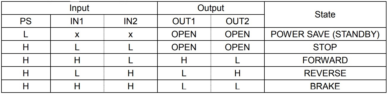

- Constant Current Mode: By default, this project works in constant current mode. Constant current can be set using Trimmer Potentiometer PR1. Use Input1 and Input2 of CN2 to control the Motor Forward, Reverse, and Brake, Refer to Table 1 for input logic.
- PWM Mode: Replace the resistor R1 with 0 Ohms. Adjust the PR1 trimmer potentiometer to 1 to 2V. Use Input 1 and Input 2 as external PWM/Logic Input, Maximum Allowable PWM frequency 100Khz. Refer to table 4 for input signals.
- Single Power Supply Input Range 8 to 46V DC (rated voltage of 50V)
- Rated Output Current (peak): 3.0A(4.0A)
- Low ON-Resistance DMOS Output
- Forward, Reverse, Brake, Open Function
- Power Save Function
- External PWM Control – PWM Control Mode
- PWM Constant Current Control Adjustable (current limit function)
- Built-in Spike Noise Cancel Function (external noise filter is unnecessary)
- Built-in Logic Input Pull-down Resistor
- Cross-conduction Prevention Circuit
- Output Detection Signal during Abnormal states (Wired-OR)
- Thermal Shutdown Circuit (TSD)
- Over-current Protection Circuit (OCP)
- Under Voltage Lockout Circuit (UVLO)
- Over Voltage Lockout Circuit (OVLO)
- Ghost Supply Prevention (protects against malfunction when the power supply is disconnected)

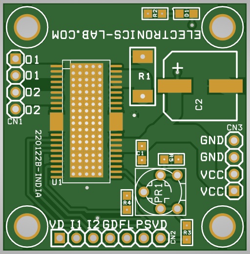

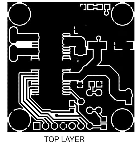

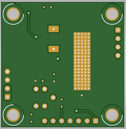

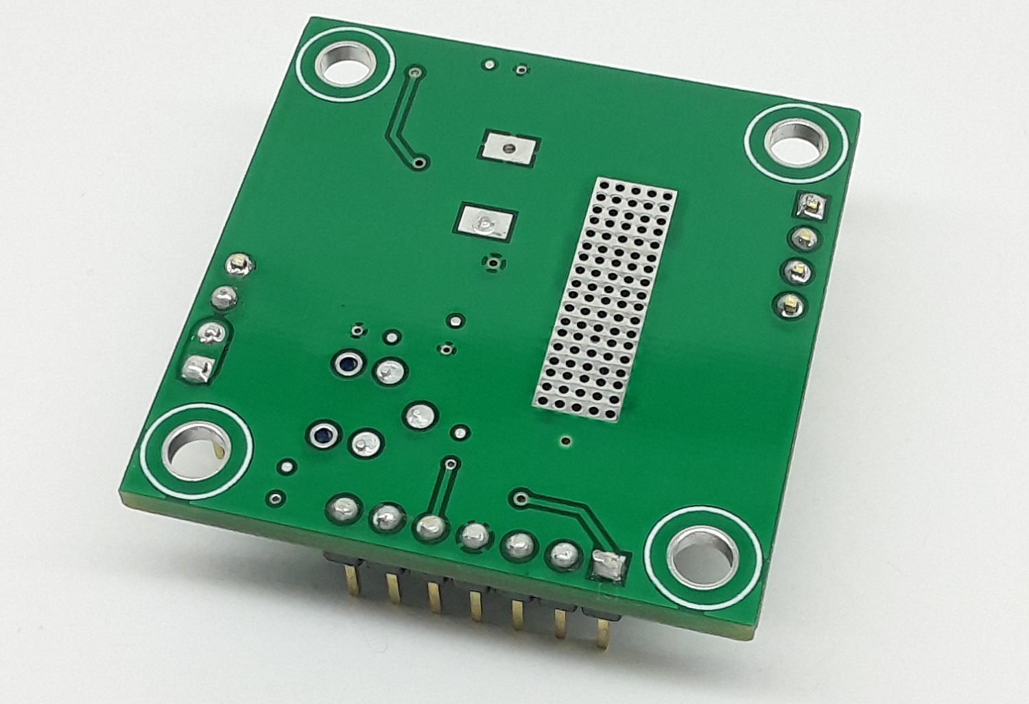

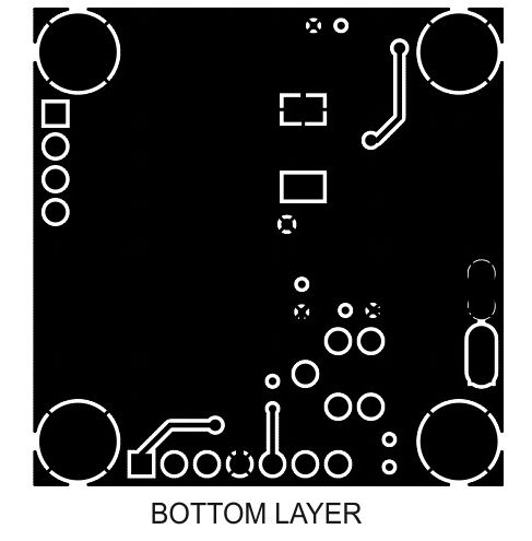

- PCB dimensions: 37.47 x 36.83 mm

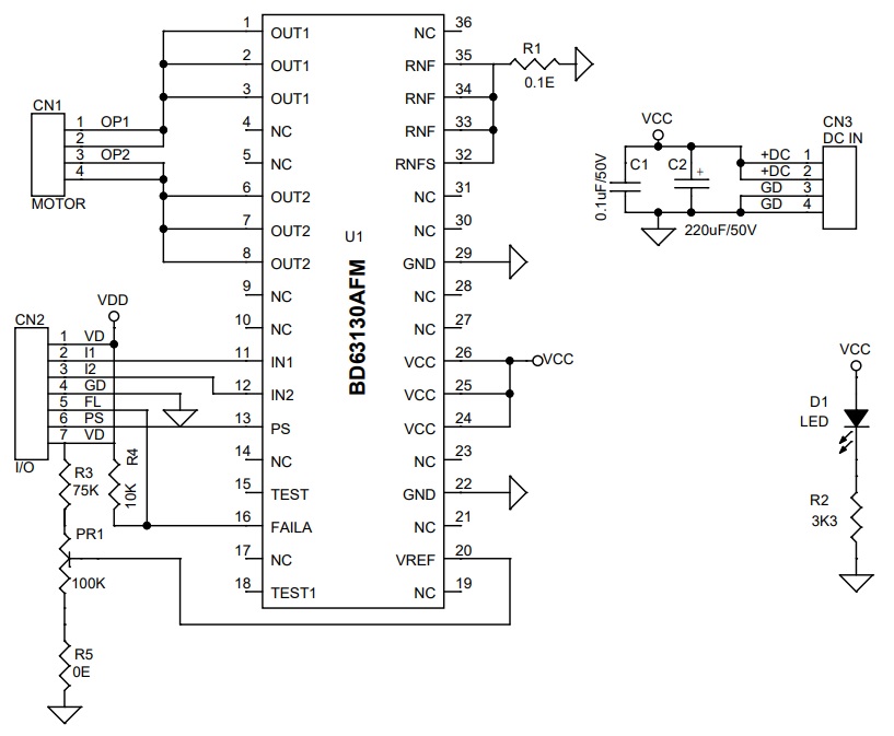

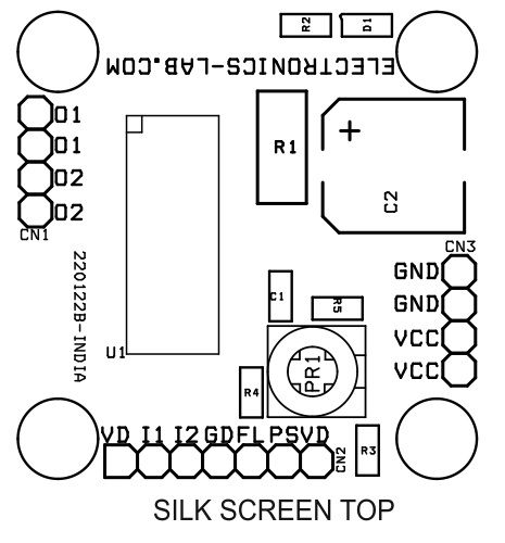

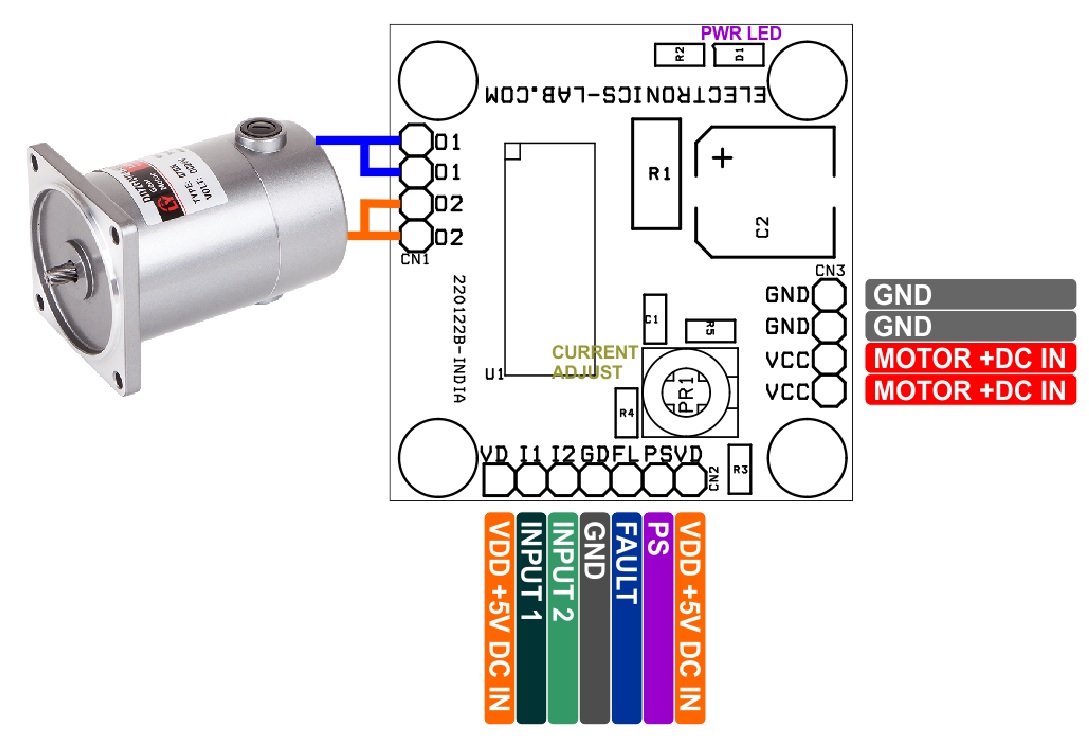

Inputs and Outputs CN2
- Pin1: VDD 5V DC @ 10-20mA- Input
- Pin2: Input 1 PWM Input or Logic H/L input Constant for Current Mode
- Pin3: Input 1 PWM Input or Logic H/L input Constant for Current Mode
- Pin4: GND
- Pin5: Fault
- Pin5: PS
- Pin7: VDD 5V DC @ 10-20mA – Input
CN3 Motor Supply Input
- Pin1: +DC 8 to 46V Motor Supply
- Pin2: +DC 8 to 46V Motor Supply
- Pin3: GND
- Pin4: GND
CN4 DC Bushed Motor
- Pin1: Motor 1 (Output1)
- Pin2: Motor 1 (Output1)
- Pin3: Motor 2 (Output2)
- Pin4: Motor 2 (Output2)
- Constant Current Adjust
LED D1: Power LED

Input1 and Input2 (Refer Table-1)
IN1, IN2/ H Bridge Control Pin It decides the output logic for H-bridge

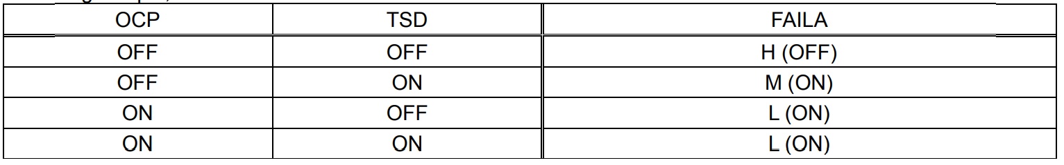

FAILA/ Fault Signal Output Pin (Refer to Table 2)
FAILA outputs an abnormality detection signal when Over-Current Protection (OCP) or Thermal Shutdown (TSD) operates. Even if Under Voltage Lock Out (UVLO) or Over Voltage Lock Out (OVLO) operates, the FAILA signal doesn’t turn abnormality detection signal (i.e., high). This signal can be connected to the microcomputer and the system can be shut down. This pin is an open-drain type, and a Pull-up resistor R4 is used. Normal output is High, this pin goes low when fault condition arises.

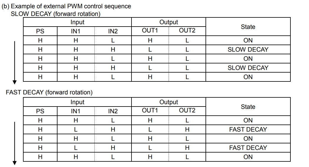

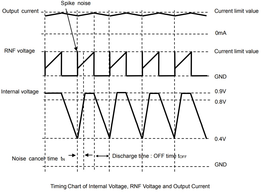

PWM Constant Current Control (Table 3)
This function can limit the peak current such as switching current in driving the DC brush motor.
- Current Control Operation: The output current increases due to the output transistor being turned on. When the voltage on the RNF pin, the output current is converted it due to connecting the external resistance to the RNF pin, reaches the voltage value set by the VREF input voltage, the current limit comparator engages and enters current decay mode. Thereafter the output turned on again after a period of time determined by the CR pin. The process repeats itself constantly.
- Blank Time (Fixed in Internal Circuit): In order to avoid misdetection of the current detection comparator due to RNF spikes that occur when the output turns ON, the internal voltage between 0.4V and 0.8V is provided as minimum ON time (tONMIN 1.5µs Typ). During this time, the current detection is disabled after the output transistor is turned on. This allows for a constant-current drive without the need for an external filter.
- Internal Timer (Fixed in Internal Circuit): Repeat charging and discharging between 0.4V to 0.9V internal voltage determined by IC internal circuit. When internal voltage is changed charge from discharge, the output is then ON from the current decay mode.
Schematic

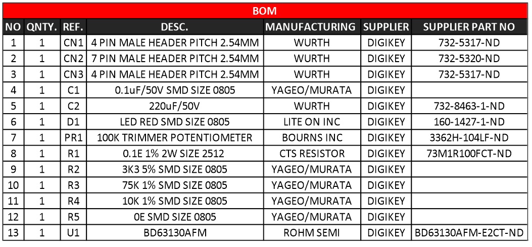

Parts List
| NO | QNTY. | REF. | DESC. | MANUFACTURING | SUPPLIER | PART NO |
| 1 | 1 | CN1 | 4 PIN MALE HEADER PITCH 2.54MM | WURTH | DIGIKEY | 732-5317-ND |
| 2 | 1 | CN2 | 7 PIN MALE HEADER PITCH 2.54MM | WURTH | DIGIKEY | 732-5320-ND |
| 3 | 1 | CN3 | 4 PIN MALE HEADER PITCH 2.54MM | WURTH | DIGIKEY | 732-5317-ND |
| 4 | 1 | C1 | 0.1uF/50V SMD SIZE 0805 | YAGEO/MURATA | DIGIKEY | |
| 5 | 1 | C2 | 220uF/50V | WURTH | DIGIKEY | 732-8463-1-ND |
| 6 | 1 | D1 | LED RED SMD SIZE 0805 | LITE ON INC | DIGIKEY | 160-1427-1-ND |
| 7 | 1 | PR1 | 100K TRIMMER POTENTIOMETER | BOURNS INC | DIGIKEY | 3362H-104LF-ND |
| 8 | 1 | R1 | 0.1E 1% 2W SIZE 2512 | CTS RESISTOR | DIGIKEY | 73M1R100FCT-ND |
| 9 | 1 | R2 | 3K3 5% SMD SIZE 0805 | YAGEO/MURATA | DIGIKEY | |
| 10 | 1 | R3 | 75K 1% SMD SIZE 0805 | YAGEO/MURATA | DIGIKEY | |
| 11 | 1 | R4 | 10K 1% SMD SIZE 0805 | YAGEO/MURATA | DIGIKEY | |
| 12 | 1 | R5 | 0E SMD SIZE 0805 | YAGEO/MURATA | DIGIKEY | |
| 13 | 1 | U1 | BD63130AFM | ROHM SEMI | DIGIKEY | BD63130AFM-E2CT-ND |
