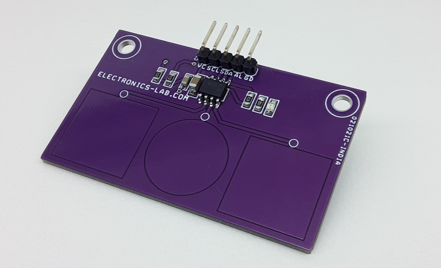

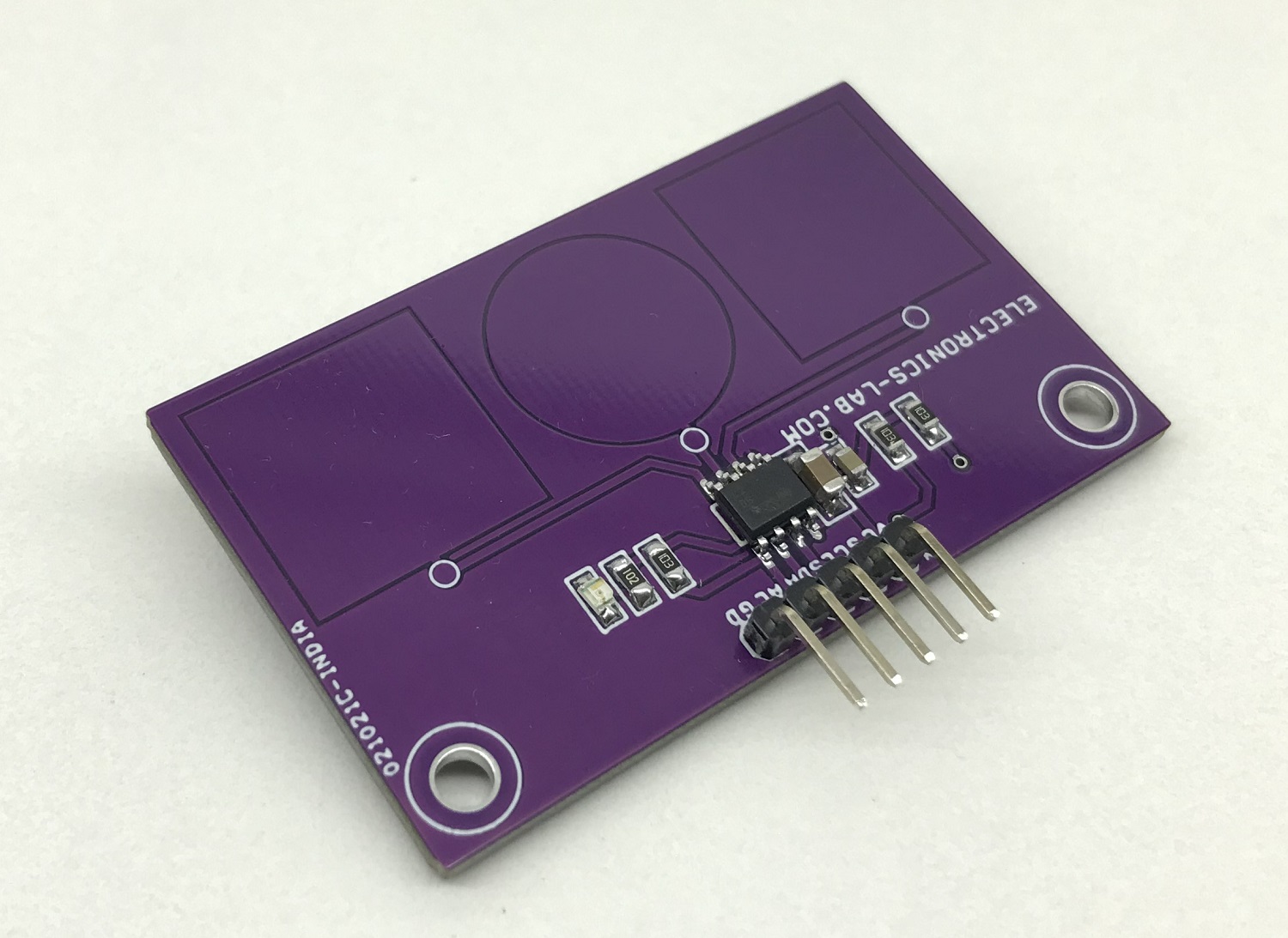

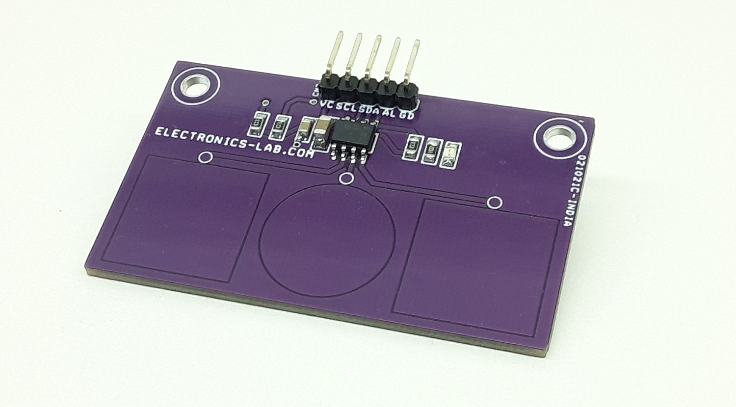

The project described here is a 3 channel capacitive touch sensor based on CAP1203 chip from Microchip which is a multiple-channel capacitive touch sensor controller. It has 3 x individual capacitive touch sensor inputs with programmable sensitivity for use in touch sensor applications.
The project described here is a 3 channel capacitive touch sensor based on CAP1203 chip from Microchip which is a multiple-channel capacitive touch sensor controller. It has 3 x individual capacitive touch sensor inputs with programmable sensitivity for use in touch sensor applications. 3 x touchpads are provided on PCB to detect the touch. Each sensor input is calibrated to compensate for system parasitic capacitance and automatically recalibrated to compensate for gradual environmental changes. The CAP1203 includes Multiple Pattern Touch recognition that allows the user to select a specific set of buttons to be touched simultaneously. If this pattern is detected, a status bit is set and an interrupt is generated. The CAP1203 has Active and Standby states, each with its own sensor input configuration controls. Power consumption in the Standby state is dependent on the number of sensor inputs enabled as well as averaging, sampling time, and cycle time. Deep Sleep is the lowest power state available, drawing 5µA (typical) of current. In this state, no sensor inputs are active, and communications will wake the device.

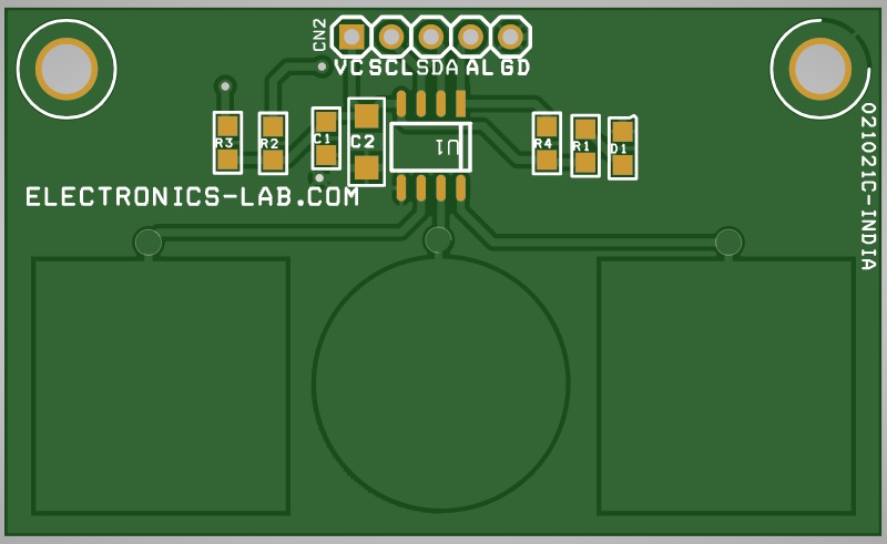

Connections Connector CN2
  • Pin1 VCC 3.3V or 5V DC
  • Pin2 SCL (Arduino UNO Analog Pin A5)
  • Pin 3 SDA (Arduino UNO Analog Pin A4)
  • Pin 4 Alert Interrupt Output for SMBus
  • Pin 5 GND

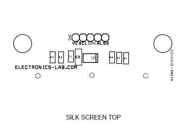

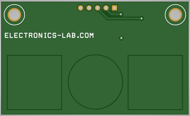

  • PCB Dimensions 56.19MM X 33.90MM

NOQNTY.REF.DESC.MANUFACTURERSUPPLIERSUPPLIER PART NO
11CN25 PIN MALE HEADER PITCH 2.54MMWURTHDIGIKEY732-5318-ND
21C10.1uF/50V SMD SIZE 0805MURATA/YAGEODIGIKEY
31C210uF/6.3V SMD SIZE 1206MURATA/YAGEODIGIKEY
41D1LED RED SMD SIZE 0805LITE ON INCDIGIKEY160-1427-1-ND
51R11K 5% SMD SIZE 0805MURATA/YAGEODIGIKEY
63R2,R3,R410K 5% SMD SIZE 0805MURATA/YAGEODIGIKEY
71U1CAP1203 SOIC8MICROCHIPDIGIKEYCAP1203-1-SN-ND
