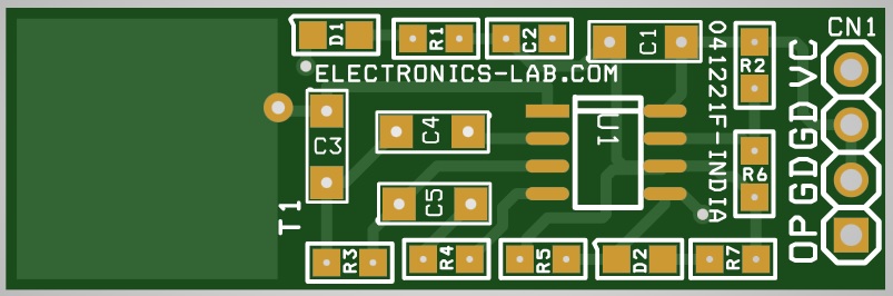

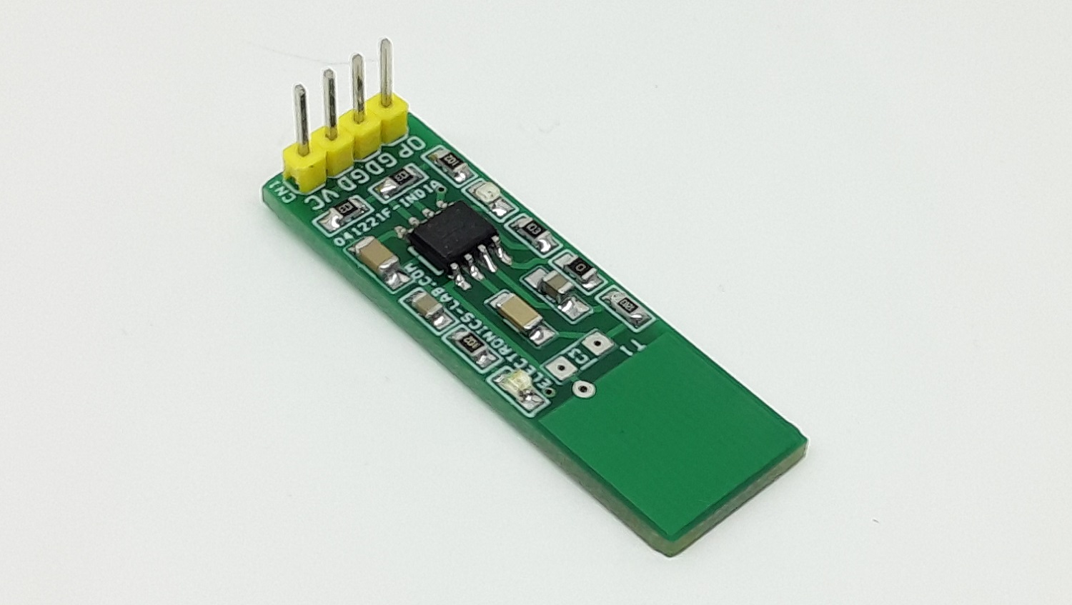

This is a single key device featuring a touch ON (Momentary) output. The project is built using the LM2907 chip.
This is a single key device featuring a touch ON (Momentary) output. The project is built using the LM2907 chip. The board provides stable sensing and has a wide working power supply range 5V to 12V DC and consumes 20mA. D1 power LED, D2 function LED.
Touch sensors are used in many applications, from remote controls, LED light controls to appliance control panels. This is a simple solution to replace a mechanical button and can be implemented in a wide variety of applications. The sensor provides a great user experience. It is easy and more convenient to use as it has no moving mechanical parts.
- Supply 5V to 12V DC @ 20mA
- D1 Power LED
- D2 Function LED, indicates when Sense
- Sensor Output Normally High – Goes Low when triggered
- Sensor Output TTL 5V when Supply 5V, Output 12V When Input Supply 12V
- PCB Dimensions 40.48 x 13.02 mm

Parts List
| NO | QNTY. | REF. | DESC | MANUFACTURER | SUPPLIER | PART NO |
| 1 | 1 | CN1 | 4 PIN MALE HEADER PITCH 2.54MM | WURTH | DIGIKEY | 732-5317-ND |
| 2 | 1 | C1 | 10uF/16V SMD SIZE 1206 | MURATA/YAGEO | DIGIKEY | |
| 3 | 2 | C2 | 0.1uF/50V SMD SIZE 0805 | MURATA/YAGEO | DIGIKEY | |
| 4 | 1 | C3 | DNP | |||
| 5 | 1 | C5 | 0.47uF/25V SMD SIZE 1206 | MURATA/YAGEO | DIGIKEY | |
| 6 | 2 | D1,D2 | LED SMD SIZE 0805 | LITE ON INC | DIGIKEY | 160-1427-1-ND |
| 7 | 2 | R1,R7 | 1K 5% SMD SIZE 0895 | MURATA/YAGEO | DIGIKEY | |
| 8 | 3 | R2,R5,R6 | 10K 5% SMD SIZE 0805 | MURATA/YAGEO | DIGIKEY | |
| 9 | 1 | R3 | 120K 5% SMD SIZE 0805 | MURATA/YAGEO | DIGIKEY | |
| 10 | 1 | R4 | 0E SMD SIZE 0805 | MURATA/YAGEO | DIGIKEY | |
| 11 | 1 | U1 | LM2907-N-8 SMD SO8 | TI | DIGIKEY | LM2907M-8-ND |
| 12 | 1 | C4 | 0.1uF/50V SMD SIZE 1206 | MURATA/YAGEO | DIGIKEY |
