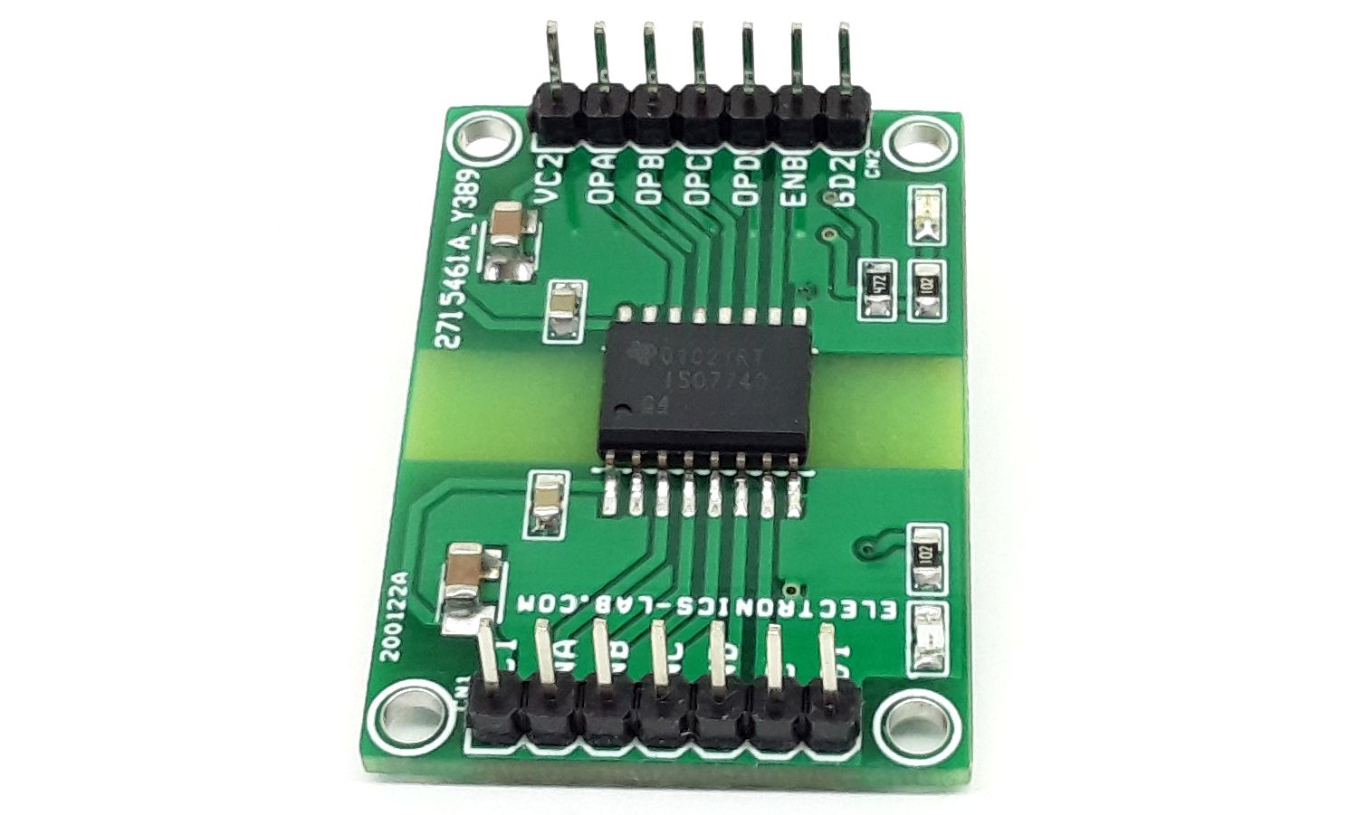

The project described here is a high-performance, quad-channel digital isolator with a 5000VRMS isolation rating as per UL1577. The ISO7740 IC provides high electromagnetic immunity and low emissions at low power consumption while isolating CMOS or LVCMOS digital I/O s.

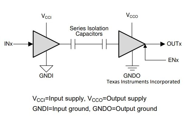

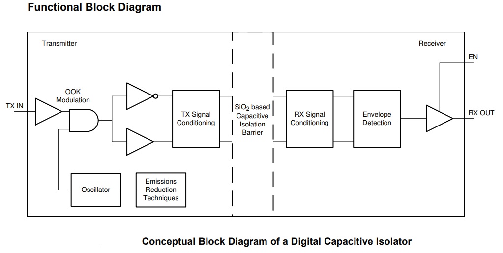

The project described here is a high-performance, quad-channel digital isolator with a 5000VRMS isolation rating as per UL1577. The ISO7740 IC provides high electromagnetic immunity and low emissions at low power consumption while isolating CMOS or LVCMOS digital I/O s. Each isolation channel has a logic input and output buffer separated by a double capacitive silicon dioxide (SiO2) insulation barrier. The project comes with enable pins that can be used to put the respective outputs in high impedance for multi-master driving applications and to reduce power consumption. The project is based on the ISO7740 chip that has all four channels in the same direction. If the input power or signal is lost, the output becomes high by default.
Used in conjunction with isolated power supplies, this project helps reduce noise currents on data buses, such as RS-485, RS-232, and CAN, or other interfaces, from entering the local ground and interfering with or damaging sensitive circuitry. Through innovative chip design and layout techniques, electromagnetic compatibility of the ISO7740 device has been significantly enhanced to ease system-level ESD, EFT, surge, and emissions compliance.

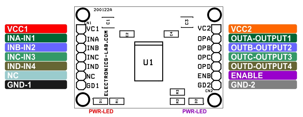

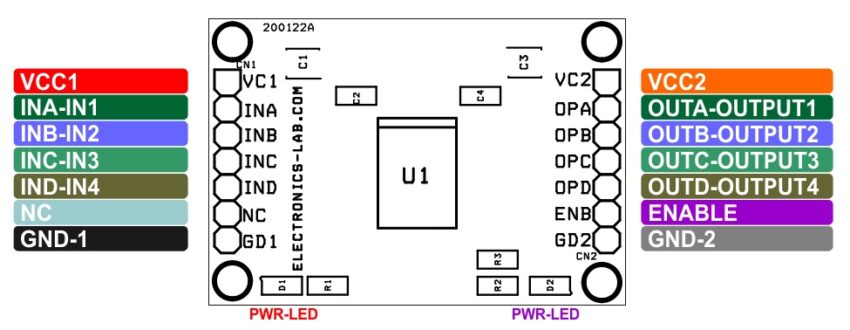

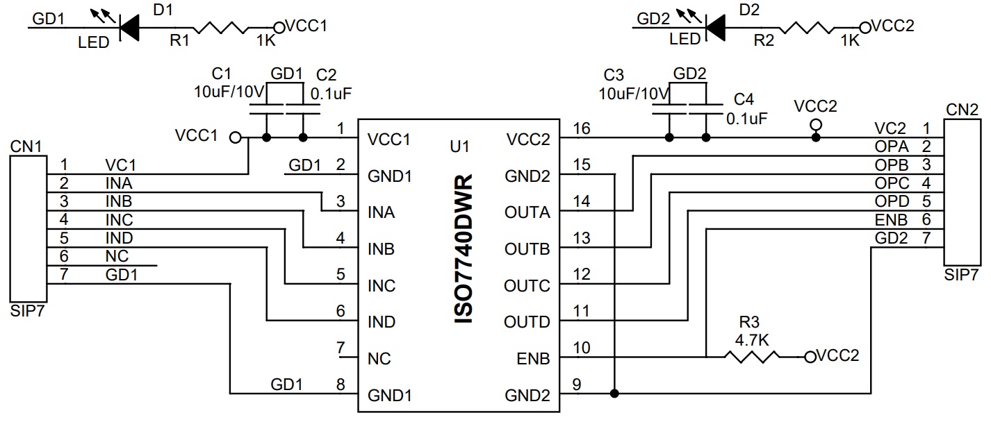

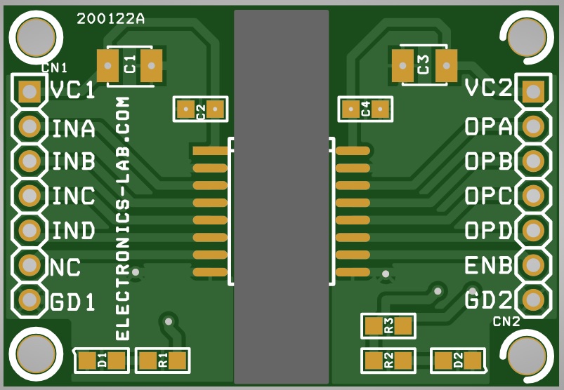

Connections and Other Details

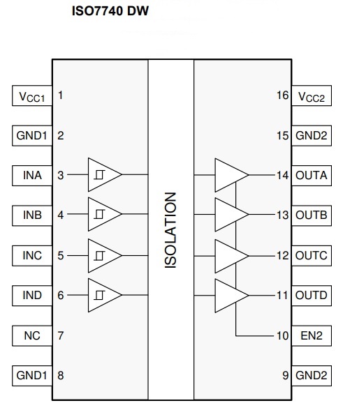

  • CN1: Pin1= VCC1 (VCC Input Side 2.25V TO 5.5V), Pin2= Input 1, Pin3=Input 2, Pin4= Input 3, Pin5= Input 4, Pin6= NC (Not Connected), GND1
  • CN2: Pin1=VCC2 (VCC Output Side 2.25V to 5.5V), Pin2=Output 1, Pin3=Output 2, Pin4=Output 3, Pin5=Output 4, Pin6=Enable, Pin7=GND2
  • LED D1 Power LED Input Side
  • LED D2 Power LED Output Side
Note: The project is by default enabled, and all outputs are normally HIGH. Connecting ENABLE pin to GND disables the outputs and outputs go LOW.
  • Wide Supply Range: 2.25 V to 5.5 V Output Side
  • Wide Supply Range: 2.25 V to 5.5 V Input Side
  • Level Translation Range: 2.25V to 5.5V
  • 2 x Power LED Input Side and Output Side

  • PCB Dimensions 40.64 x 27.94 mm
  • 5 x 4 mm Mounting Holes
Schematic

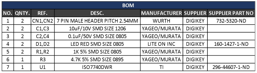

Parts List
NO.QNTY.REF.DESC.MANUFACTURERSUPPLIERPART NO
12CN1,CN27 PIN MALE HEADER PITCH 2.54MMWURTHDIGIKEY732-5320-ND
22C1,C310uF/10V SMD SIZE 1206YAGEO/MURATADIGIKEY
32C2,C40.1uF/50V SMD SIZE 0805YAGEO/MURATADIGIKEY
42D1,D2LED RED SMD SIZE 0805LITE ON INCDIGIKEY160-1427-1-ND
52R1,R21K 5% SMD SIZE 0805YAGEO/MURATADIGIKEY
61R34.7K 5% SMD SIZE 0895YAGEO/MURATADIGIKEY
71U1ISO7740DWRTIDIGIKEY296-44607-1-ND

Block Diagram

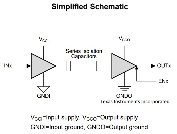

Simplified Schematic

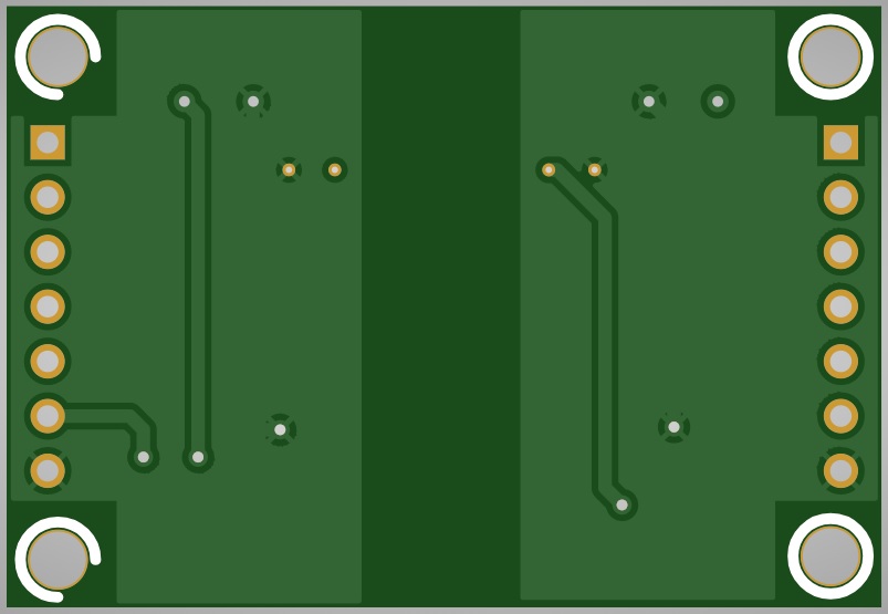

Gerber View

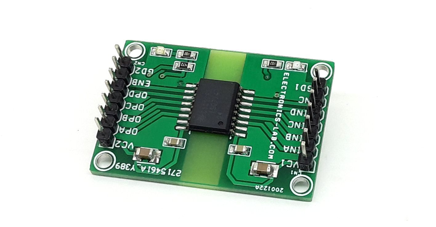

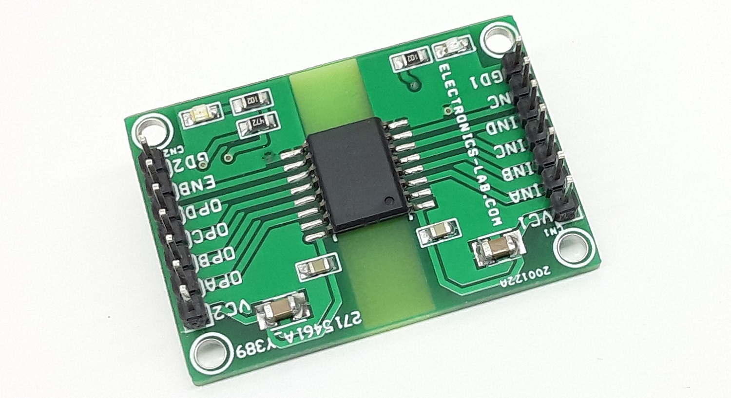

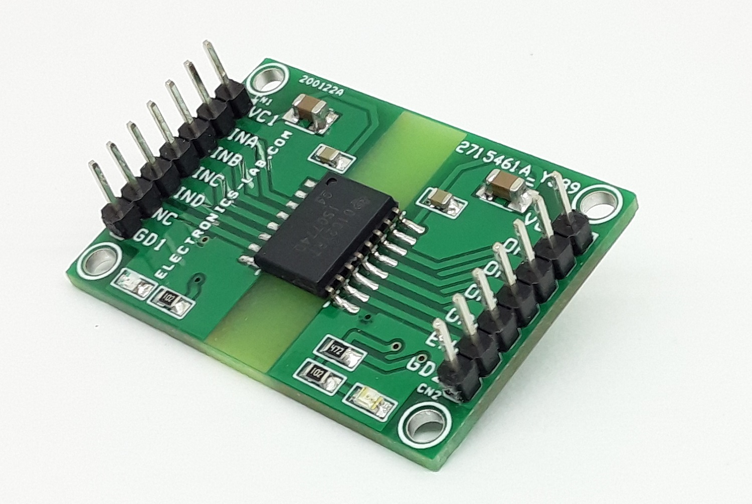

Photos
