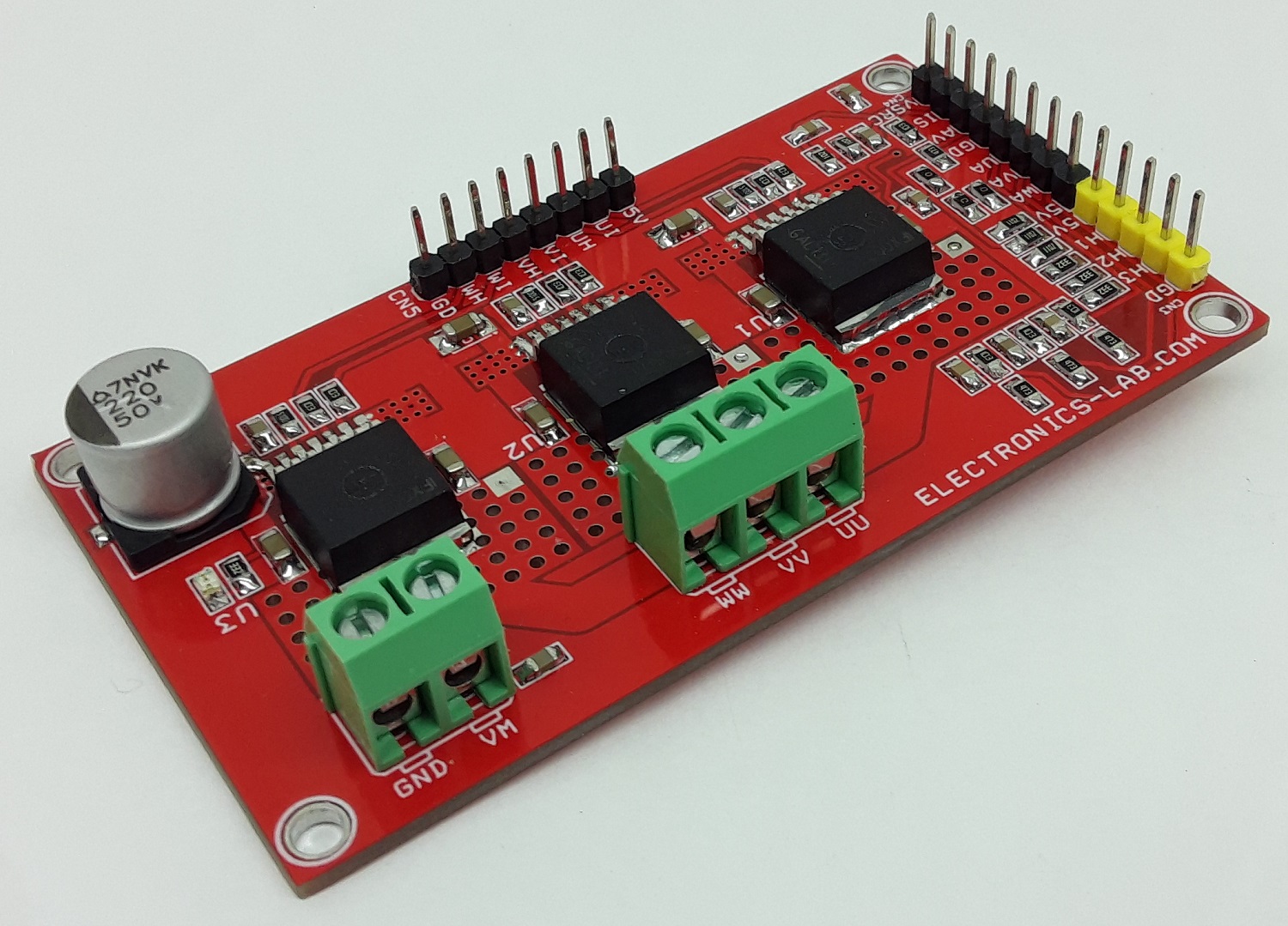

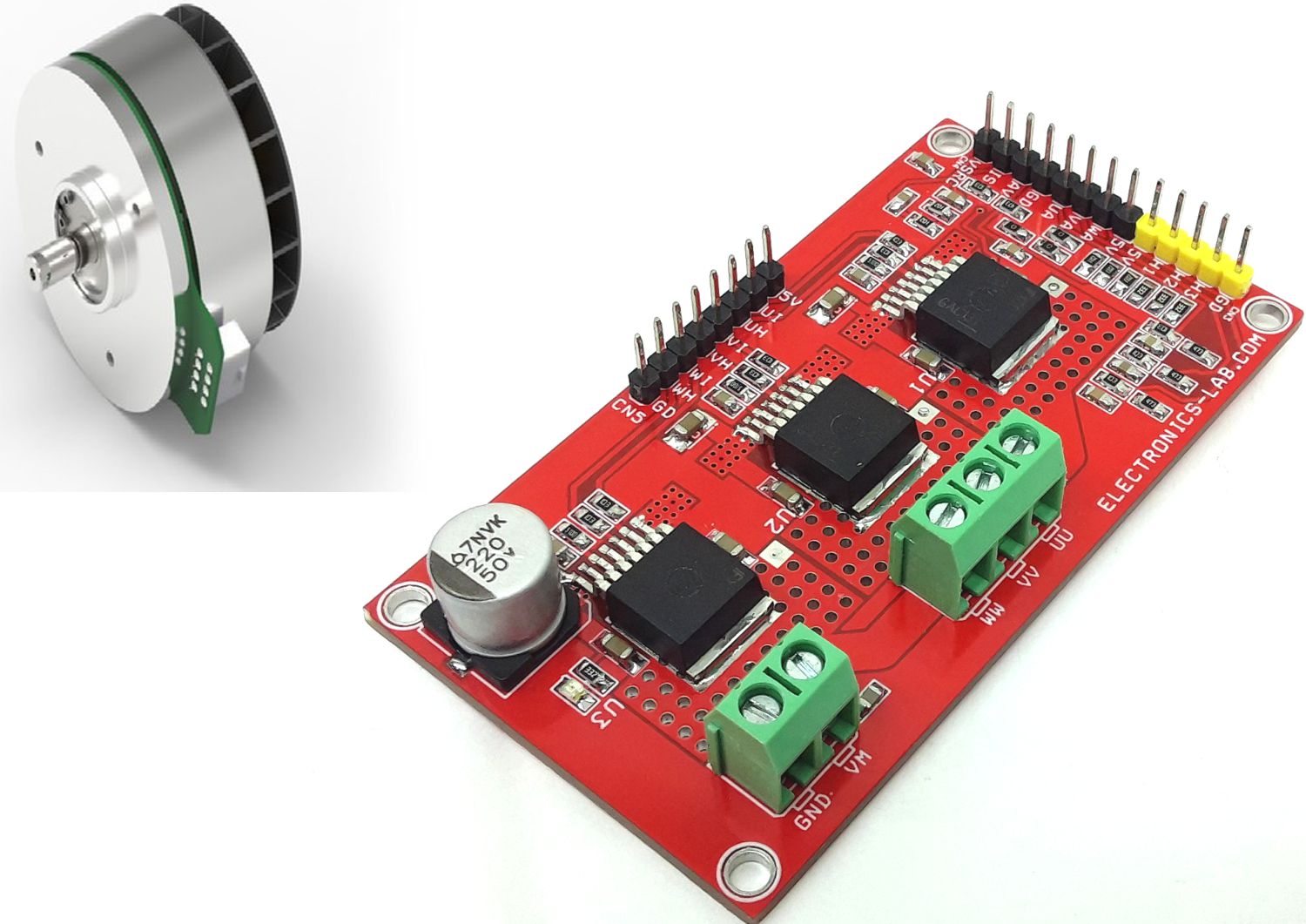

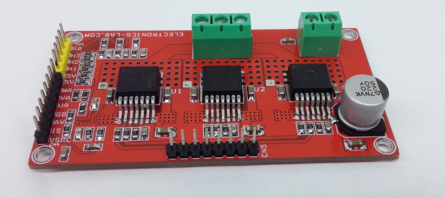

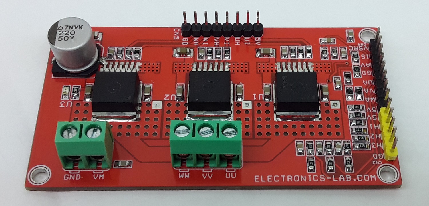

This BLDC motor driver board is equipped with a smart IFX007T half-bridge. The BLDC motor control project is capable to drive one BLDC motor.
This BLDC motor driver board is equipped with a smart IFX007T half-bridge. The BLDC motor control project is capable to drive one BLDC motor. Alternatively, it can be used to drive one or two bi-directional DC motors (H-Bridge configuration, cascaded to support the second motor) or up to three uni-directional DC motors (half-bridge configuration). The implemented integrated IFX007T half-bridges can be controlled by a PWM via the IN Pin. Interfacing to a microcontroller or Arduino is easy by the integrated driver IC which features logic level inputs, diagnosis with current sense, slew rate adjustment, and dead time generation, etc. The three IFX007T half-bridges are also fully protected against over-temperature, under-voltage, overcurrent, and short circuit events. The project is capable of high-frequency PWM e.g., 30Khz. All inputs are logic level, current sense outputs are for diagnosis purposes, and slew rates are adjustable using R7, R8, R9. This is able to be used for fast and inexpensive prototyping of (BL)DC motor control, easy testing of half-and full-bridge motor control Status flag diagnosis with current sense capability, Over-temperature shut down with latch behavior and under-voltage shut down. It is advisable to use forced cool air to control the temperature of the IFX007 chip.

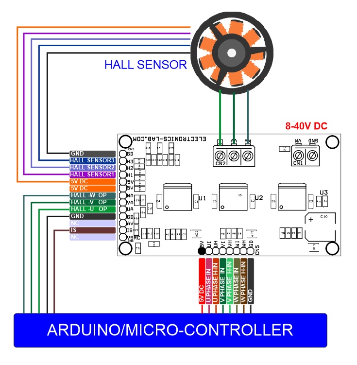

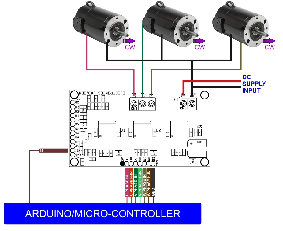

Arduino Code is provided to test the board. The user will be able to drive a single brushed DC motor with speed control function.

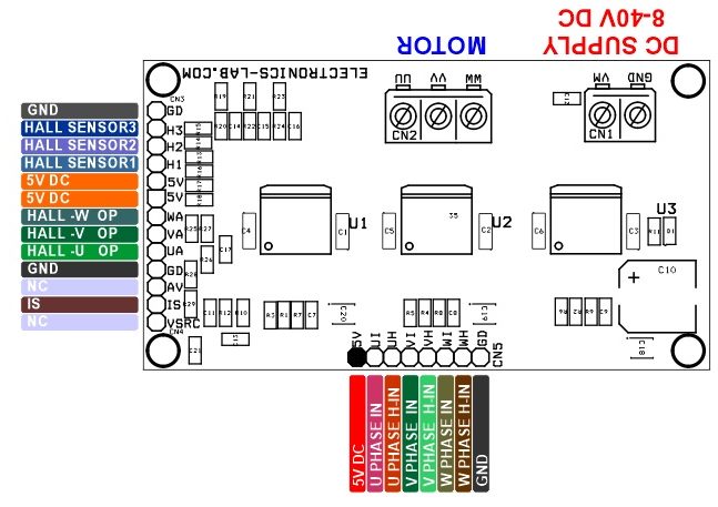

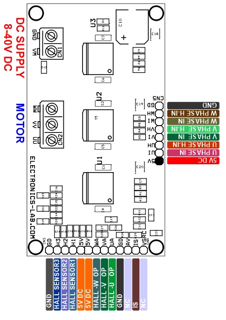

- Connections: Arduino Digital Pin D5 = VH Pin 5 of Connector CN5, Arduino Digital Pin D10 = VI Pin 4 of Connector CN5, Arduino GND = GND Pin 8 of CN5, Motor Supply 8 to 40V DC = CN1
Brushed or BLDC Motor Control
- One BLDC Motor with Hall Sensor or FOC
- Three Unidirectional Brushed DC Motor
- One Bidirectional and One Unidirectional

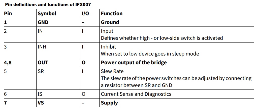

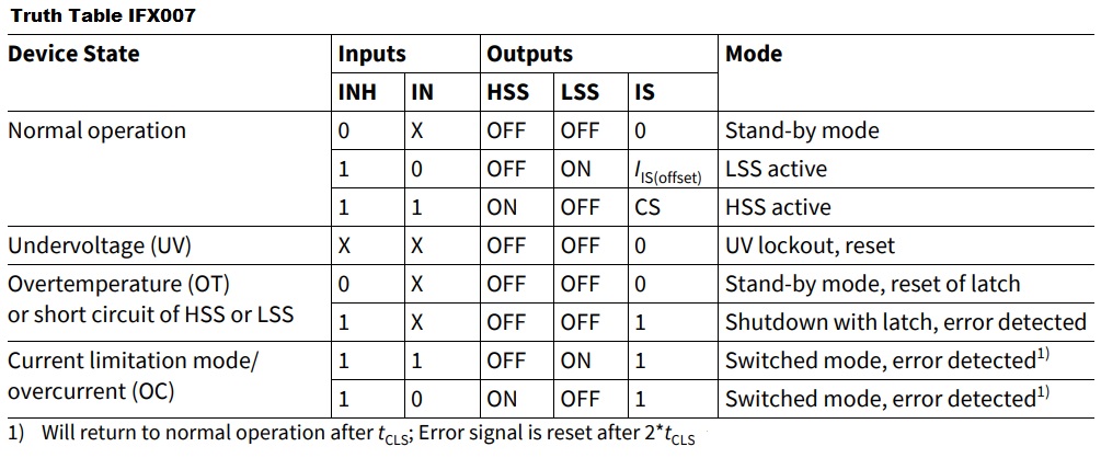

Input circuit
The control inputs IN and INH consist of TTL/CMOS compatible Schmitt triggers with hysteresis which controls the integrated gate drivers for the MOSFETs. Setting the INH pin to high enables the device. In this condition, one of the two power switches is switched on depending on the status of the IN pin. To deactivate both switches, the INH pin has to be set to low. No external driver is needed. The IFX007T can be interfaced directly to a microcontroller.
Deadtime generation
In bridge applications it has to be assured that the high-side and low-side MOSFET are not conducting at the same time, connecting directly the battery voltage to GND. This is assured by a circuit in the driver IC, generating a so-called dead time between switching off one MOSFET and switching on the other. The dead
time generated in the driver IC is automatically adjusted to the selected slew rate
Adjustable slew rate (Adjustable Using External Resistor R7, R8, R9) Refer Data Sheet of IFX007 for more Info
In order to optimize electromagnetic emission, the switching speed of the MOSFETs is adjustable by an external resistor R7, R8, R9. The slew rate pin SR allows the user to optimize the balance between emission and power dissipation within his own application by connecting an external resistor RSR to GND.

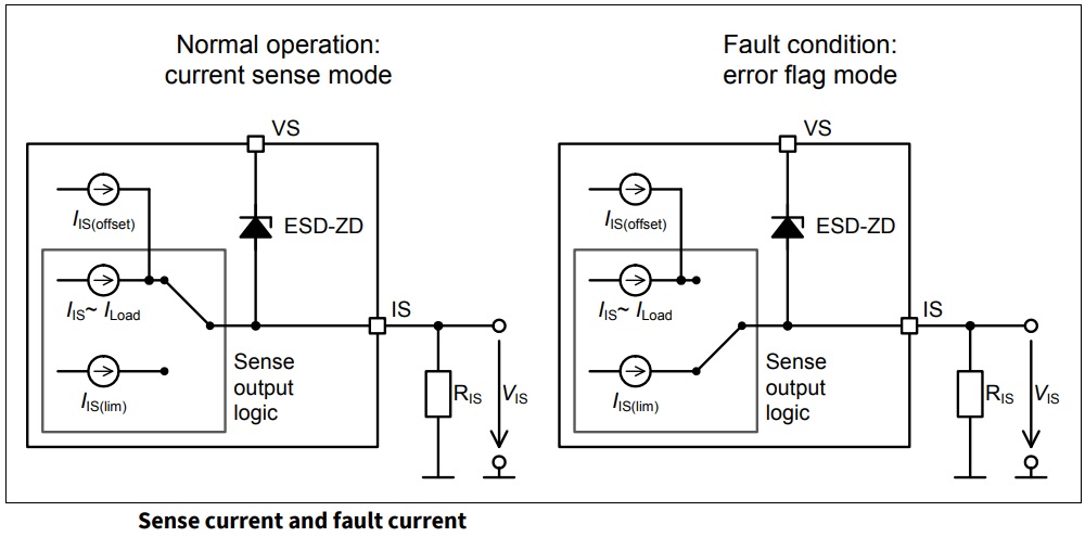

The sense pin IS is used as a combined current sense and error flag output. In normal operation (current sense mode), a current source is connected to the status pin, which delivers a current proportional to the forward load current flowing through the active high-side switch.

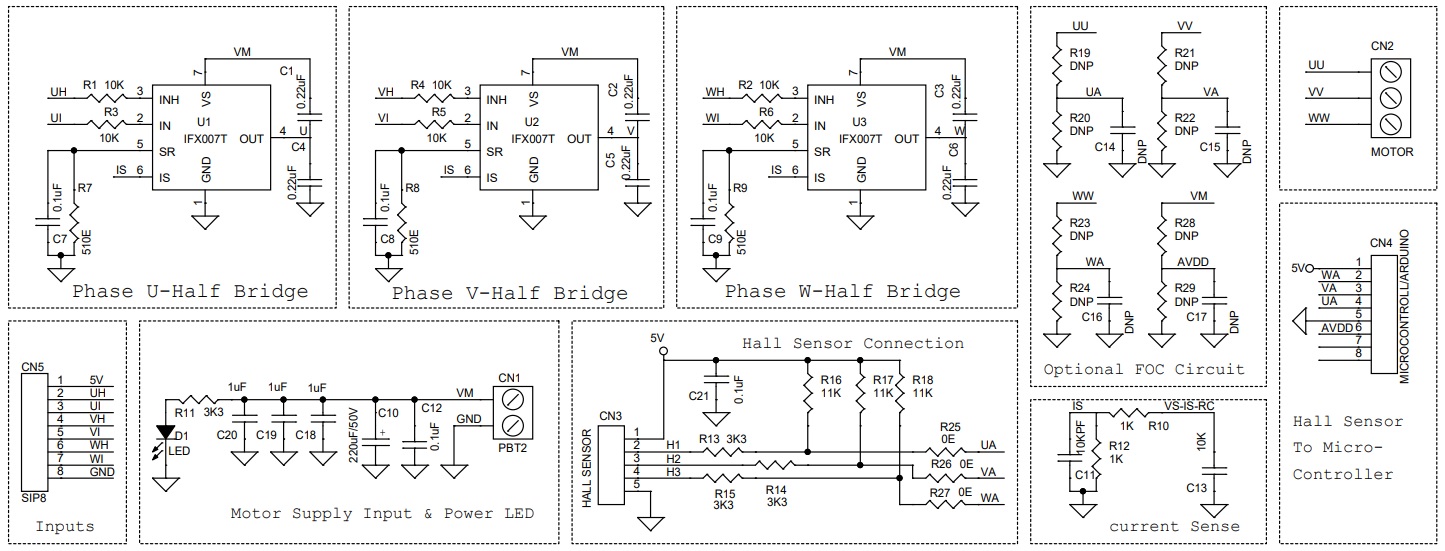

Schematic

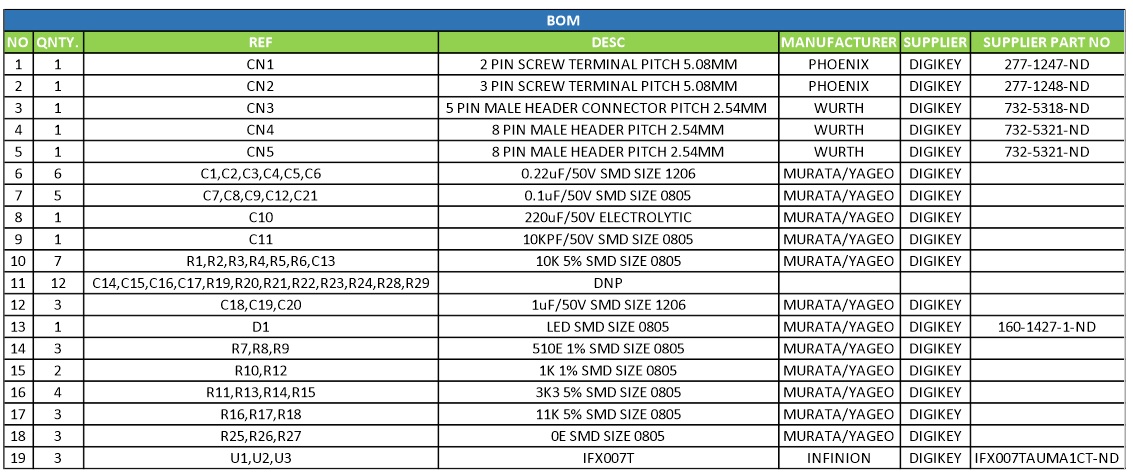

Parts List
| NO | QNTY. | REF | DESC | MANUFACTURER | SUPPLIER | PART NO |
| 1 | 1 | CN1 | 2 PIN SCREW TERMINAL PITCH 5.08MM | PHOENIX | DIGIKEY | 277-1247-ND |
| 2 | 1 | CN2 | 3 PIN SCREW TERMINAL PITCH 5.08MM | PHOENIX | DIGIKEY | 277-1248-ND |
| 3 | 1 | CN3 | 5 PIN MALE HEADER CONNECTOR PITCH 2.54MM | WURTH | DIGIKEY | 732-5318-ND |
| 4 | 1 | CN4 | 8 PIN MALE HEADER PITCH 2.54MM | WURTH | DIGIKEY | 732-5321-ND |
| 5 | 1 | CN5 | 8 PIN MALE HEADER PITCH 2.54MM | WURTH | DIGIKEY | 732-5321-ND |
| 6 | 6 | C1,C2,C3,C4,C5,C6 | 0.22uF/50V SMD SIZE 1206 | MURATA/YAGEO | DIGIKEY | |
| 7 | 5 | C7,C8,C9,C12,C21 | 0.1uF/50V SMD SIZE 0805 | MURATA/YAGEO | DIGIKEY | |
| 8 | 1 | C10 | 220uF/50V ELECTROLYTIC | MURATA/YAGEO | DIGIKEY | |
| 9 | 1 | C11 | 10KPF/50V SMD SIZE 0805 | MURATA/YAGEO | DIGIKEY | |
| 10 | 7 | R1,R2,R3,R4,R5,R6,C13 | 10K 5% SMD SIZE 0805 | MURATA/YAGEO | DIGIKEY | |
| 11 | 12 | C14,C15,C16,C17 | DNP | |||
| R19,R20,R21,R22 | DNP | |||||
| R23,R24,R28,R29 | DNP | |||||
| 12 | 3 | C18,C19,C20 | 1uF/50V SMD SIZE 1206 | MURATA/YAGEO | DIGIKEY | |
| 13 | 1 | D1 | LED SMD SIZE 0805 | MURATA/YAGEO | DIGIKEY | 160-1427-1-ND |
| 14 | 3 | R7,R8,R9 | 510E 1% SMD SIZE 0805 | MURATA/YAGEO | DIGIKEY | |
| 15 | 2 | R10,R12 | 1K 1% SMD SIZE 0805 | MURATA/YAGEO | DIGIKEY | |
| 16 | 4 | R11,R13,R14,R15 | 3K3 5% SMD SIZE 0805 | MURATA/YAGEO | DIGIKEY | |
| 17 | 3 | R16,R17,R18 | 11K 5% SMD SIZE 0805 | MURATA/YAGEO | DIGIKEY | |
| 18 | 3 | R25,R26,R27 | 0E SMD SIZE 0805 | MURATA/YAGEO | DIGIKEY | |
| 19 | 3 | U1,U2,U3 | IFX007T | INFINION | DIGIKEY | IFX007TAUMA1CT-ND |
Connections
