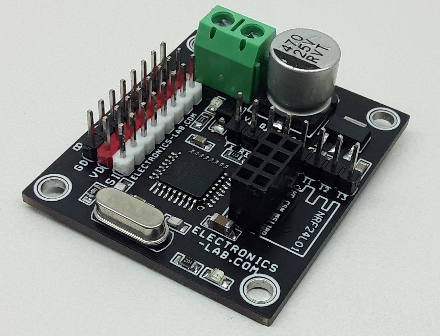

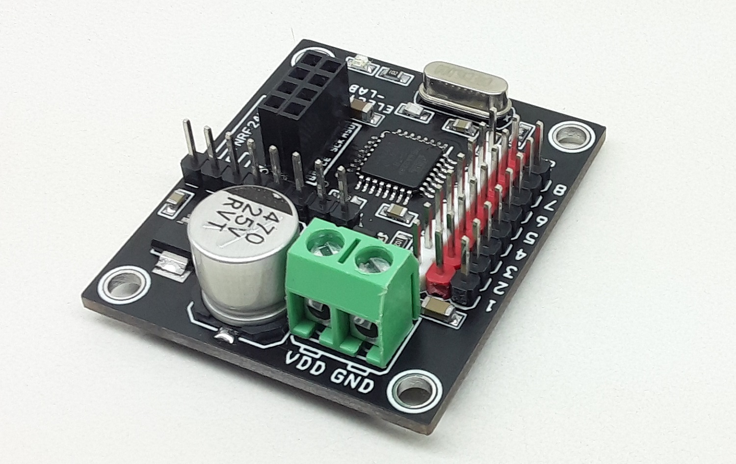

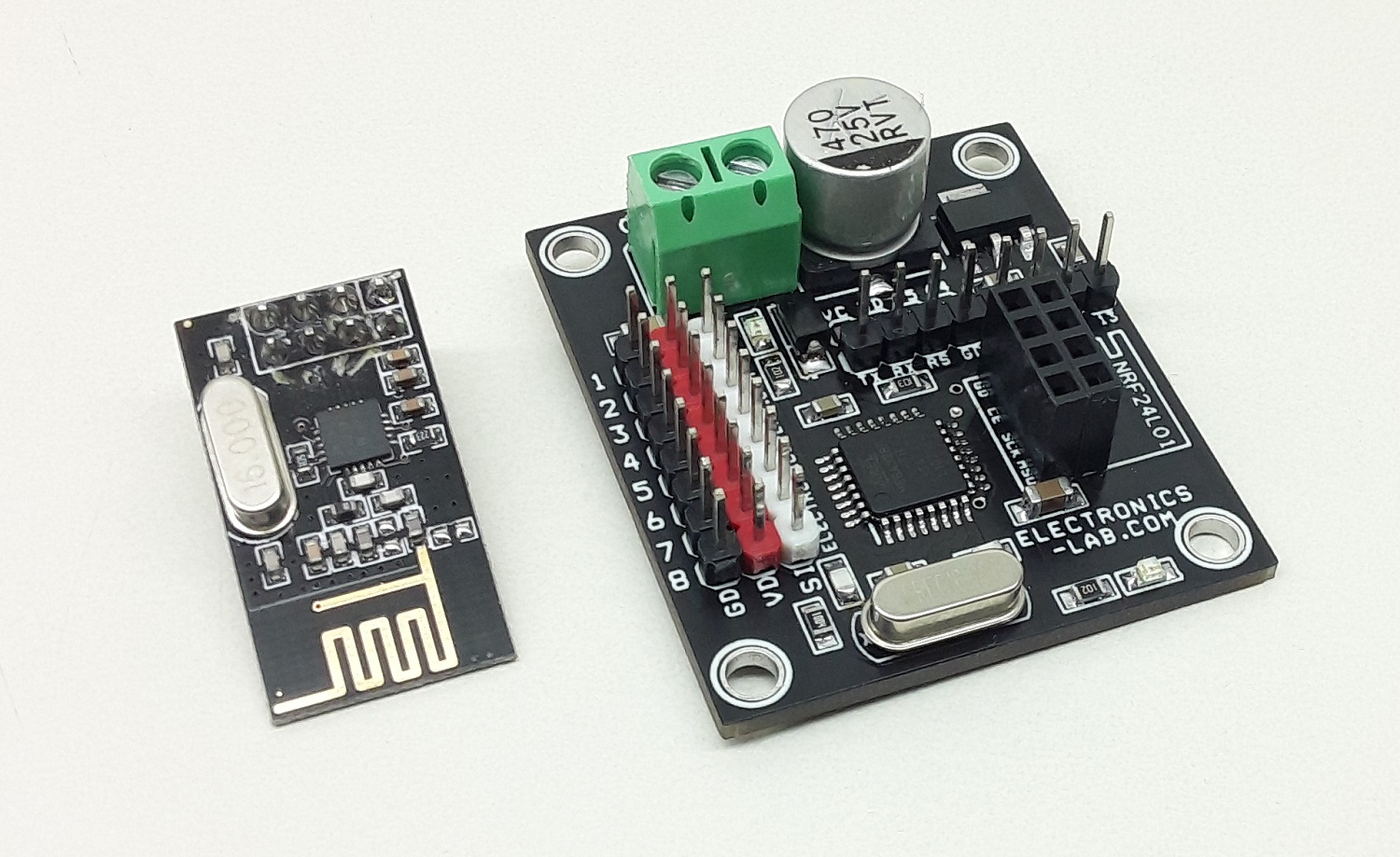

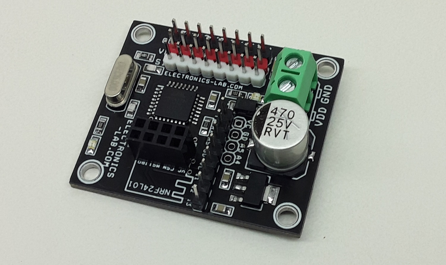

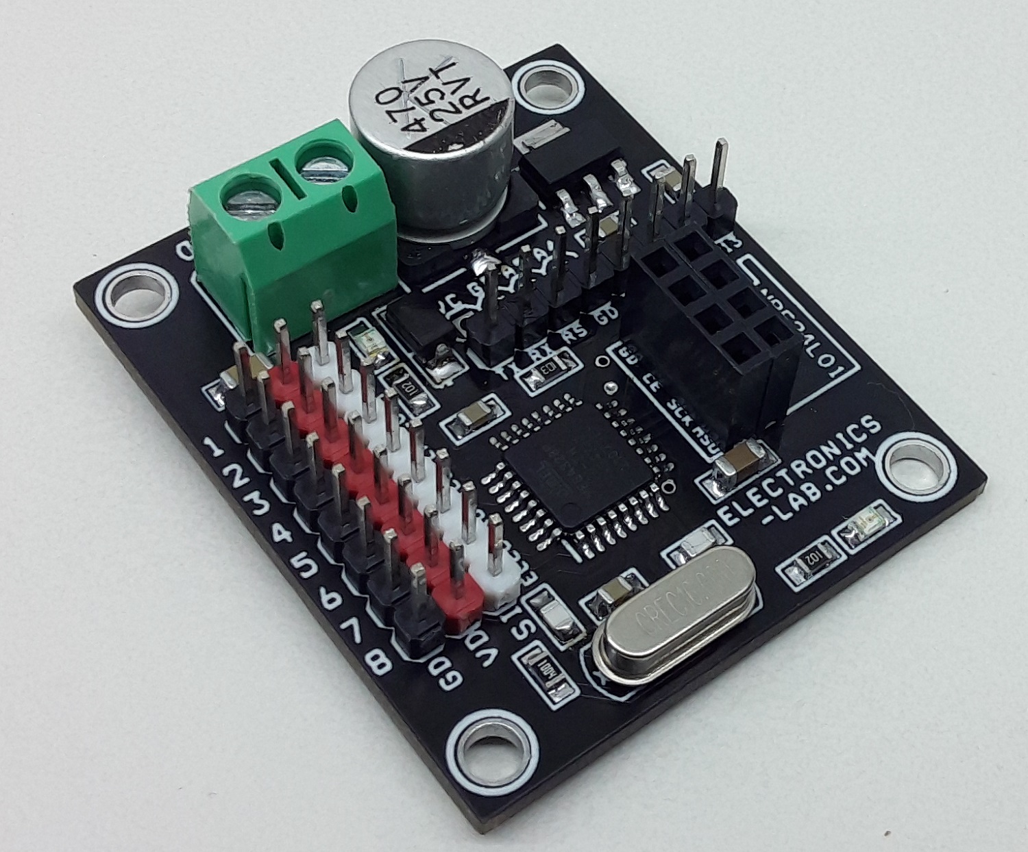

This is an easy-to-build open-source Arduino compatible board that enables driving 8 RC servos over NRF24L01 RF Link. The project can be used as a standalone RC servo driver or 8 channel RF remote-controlled RC servo Receiver.
This is an easy-to-build open-source Arduino compatible board that enables driving 8 RC servos over NRF24L01 RF Link. The project can be used as a standalone RC servo driver or 8 channel RF remote-controlled RC servo Receiver. An optional OLED display option can be used to develop RC signal monitor. The tiny module contains an ATmega328 microcontroller, connectors for 8 x Servo interface, DC supply connector, bulk electrolytic capacitor C5 on DC supply to provide jitter-free smooth movement of RC servos. Operating Supply 5V DC.
This board is compatible with our Dual Joystick RF Remote Transmitter with NRF24L01 RF module or Single Joystick Remote Control Transmitter using NRF24L01 as the transmitter. The user will be able to drive 4 RC servos or 2 RC servos with these transmitters respectively.

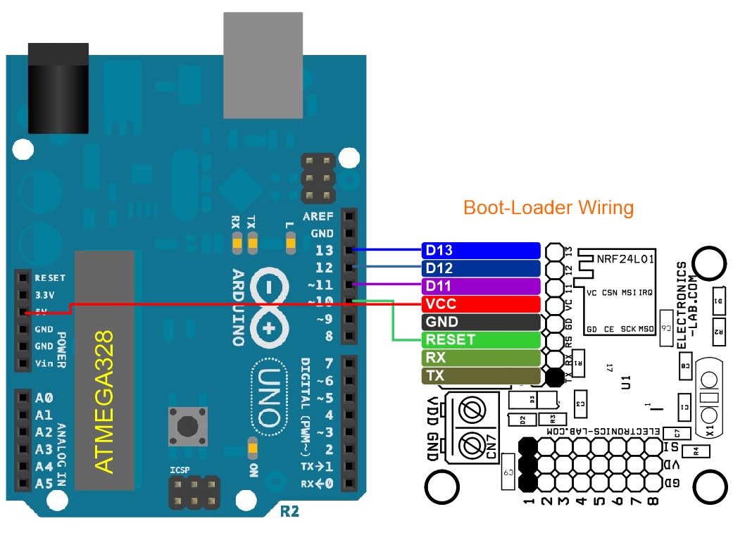

A new Atmega328 microcontroller requires a bootloader and Arduino code. Connector CN4 is provided to do needful, the bellow link will help you to learn more about programming and boot-loader burning.
https://www.arduino.cc/en/Tutorial/BuiltInExamples/ArduinoToBreadboard/
Arduino Code is available below as a download for both RX and TX. A compatible transmitter board is published here. This is Arduino compatible hardware. User may write their own code using Arduino IDE. Code can be uploaded to the board using the CN4 programming connector following the connection diagram below.

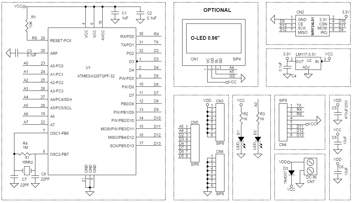

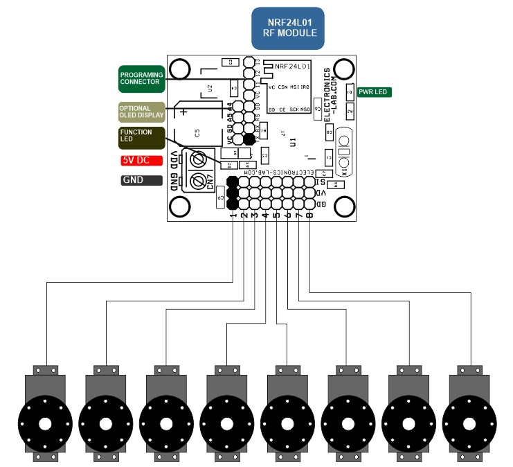

Arduino Pin Configuration
- RC Servo 1 to 8: A5, A4, D2, D3, D4, D5
- NRF24L01: CE>D9, CSN>D10, D11>MOSI, D12>MISO, D13>SCK
- OPTIONAL 0.96INCH OLED DISPLAY: A4 AND A5, In the Case of OLED display, is in use, you can only use 6 channel RC servo outputs.
- LED D2: FUNCTION LED >A0

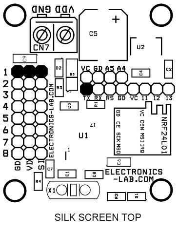

Hardware Details
- CN1: OLED Display Connector (Optional) Can be used as RC signal monitor
- U1: Atmega328 Micro-Controller
- D1: Power LED
- D2: Optional Function LED connected to A0 Analog pin of Arduino
- CN7: DC Supply Input 5V DC
- CN4: Arduino Programming Connector (Boot-Loader and Arduino IDE)
- CN2: NRF24L01 RF Trans-receiver Module for RF Link
- U2: 3.3V Regulator which power NRF24L01 Module
- PCB Dimensions: 44.45 x 37.94 mm
Schematic

Connections

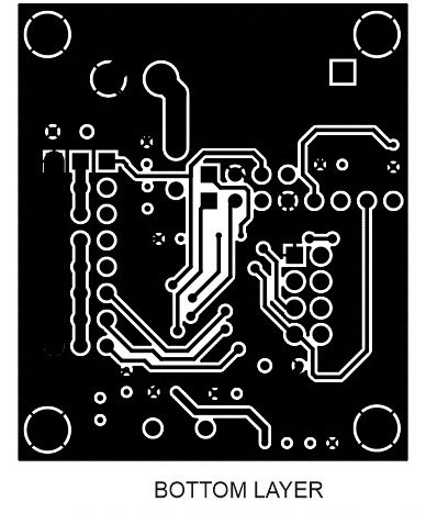

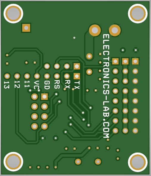

Gerber View

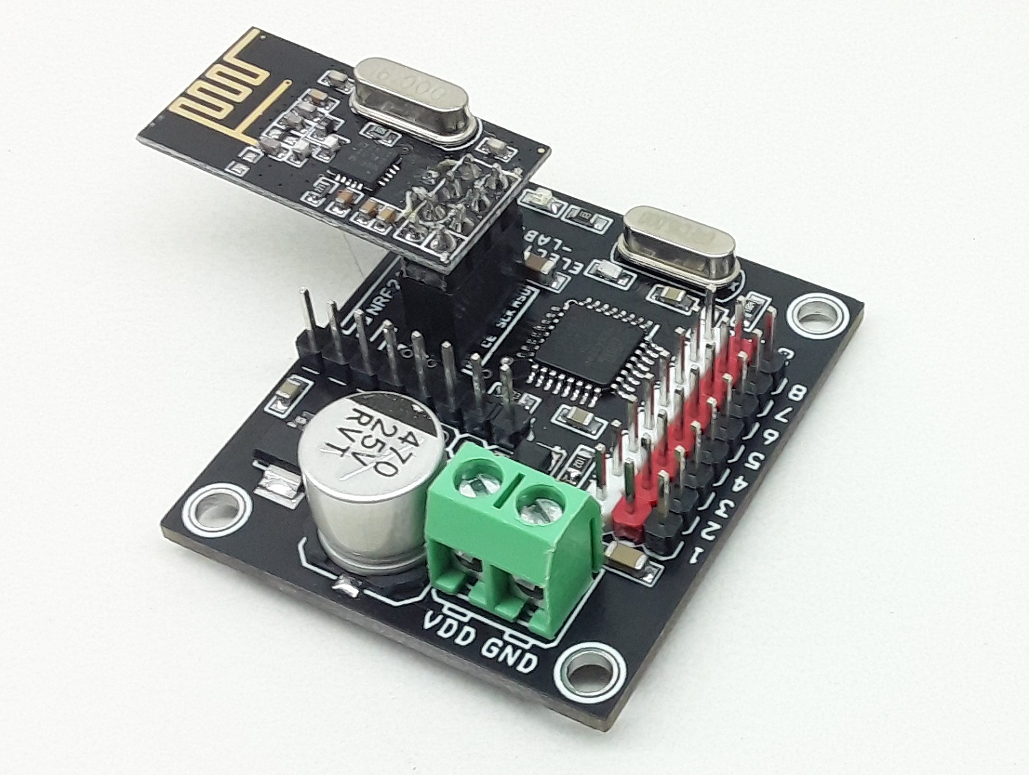

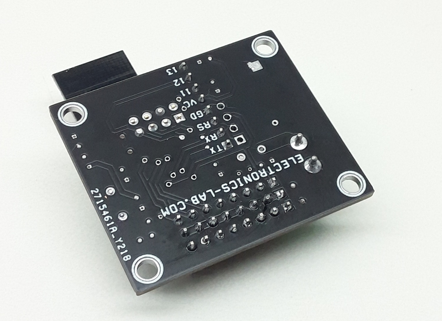

Photos
