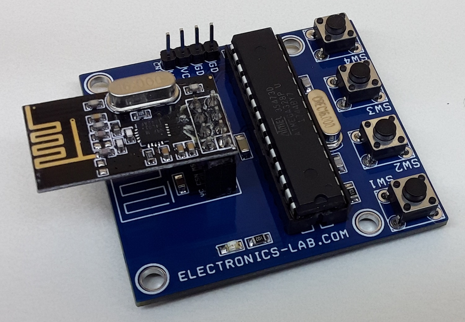

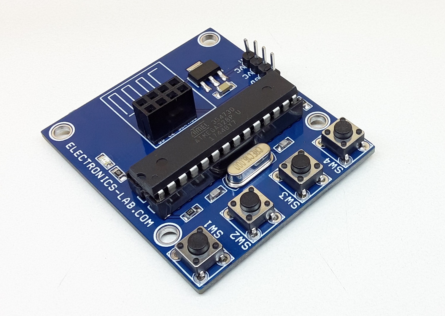

4 Channel RF Remote Transmitter using nRF24L01- Arduino Compatible

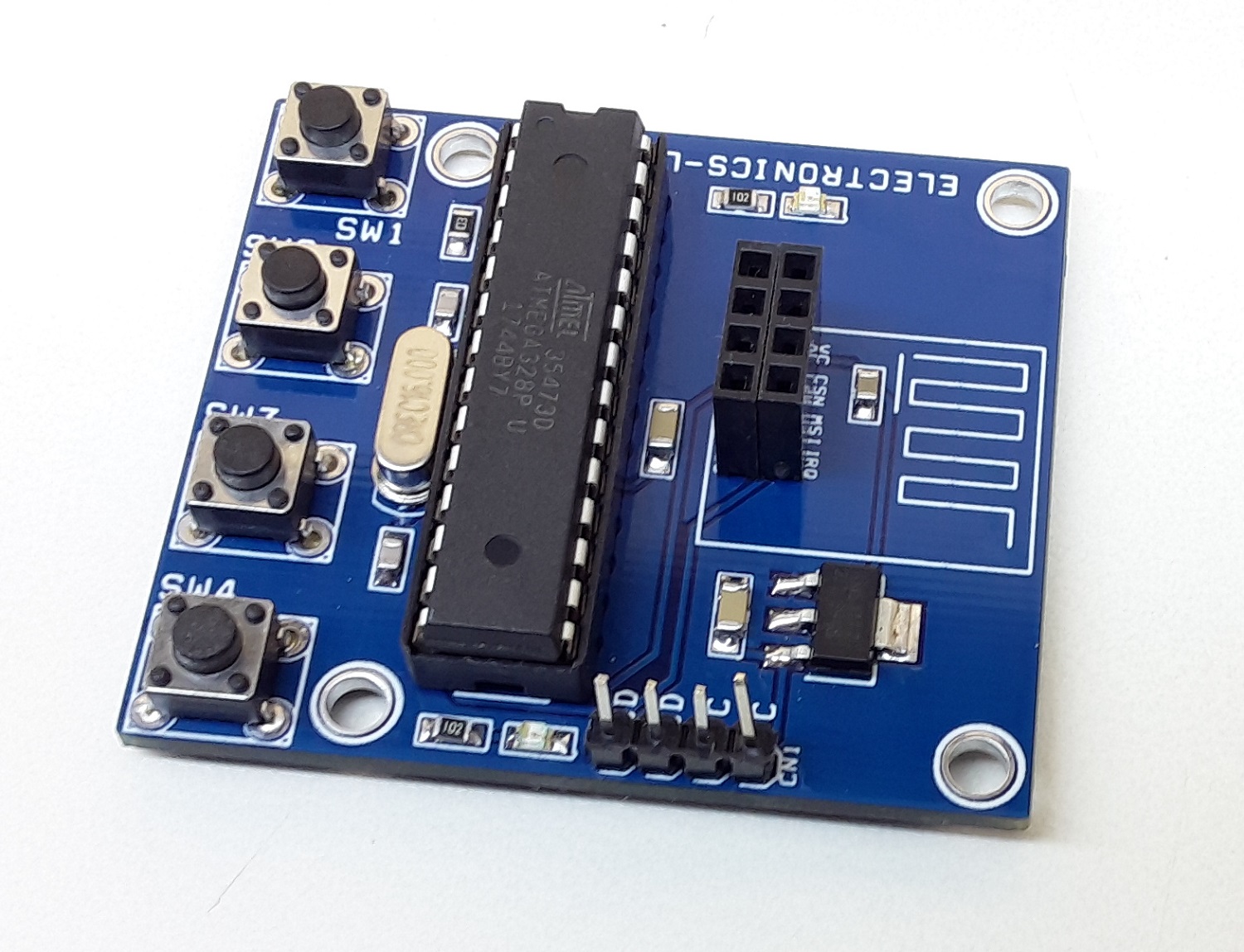

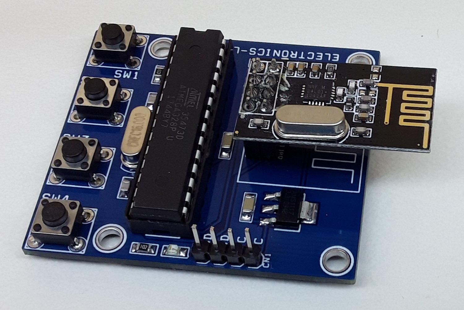

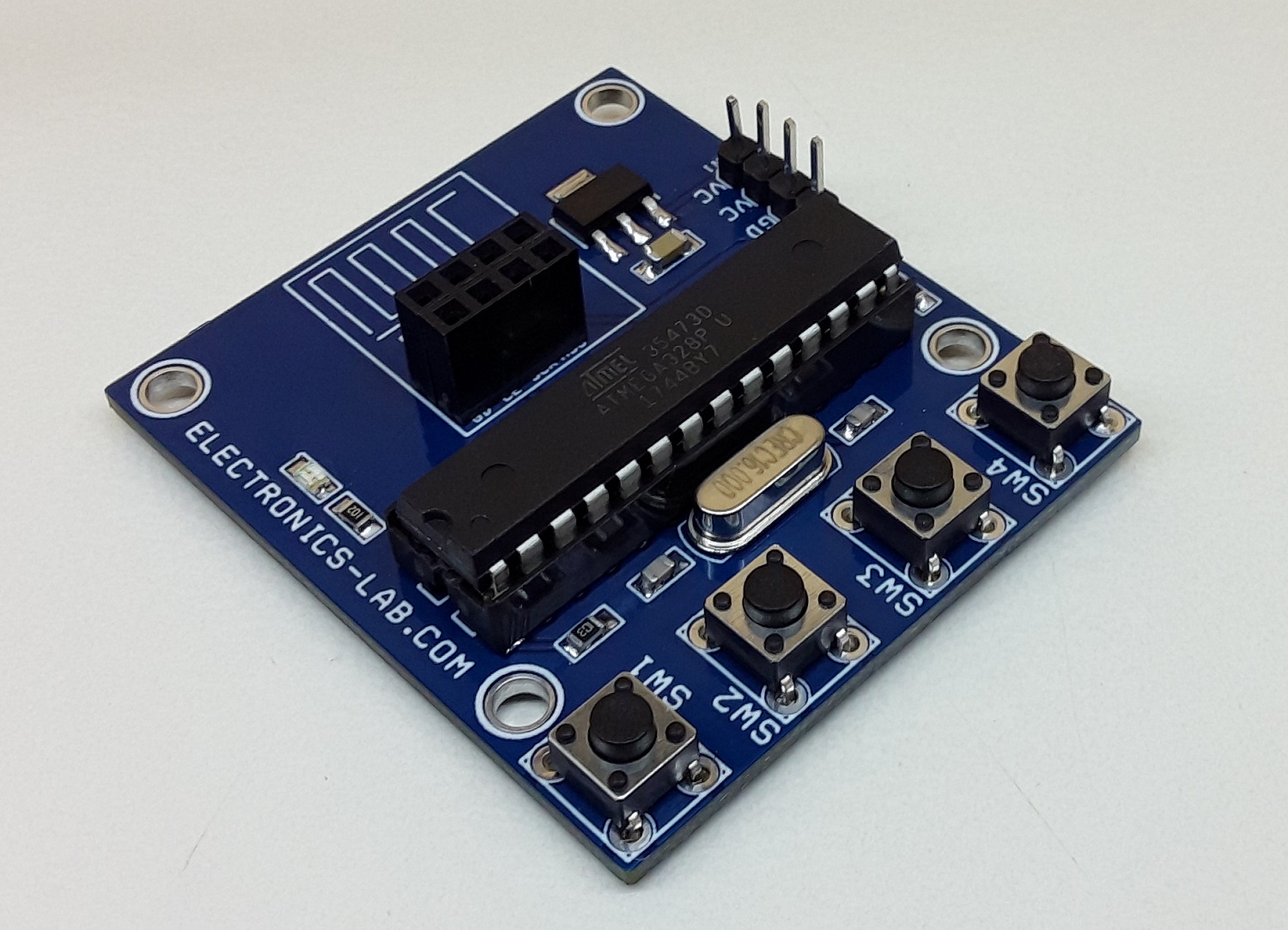

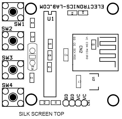

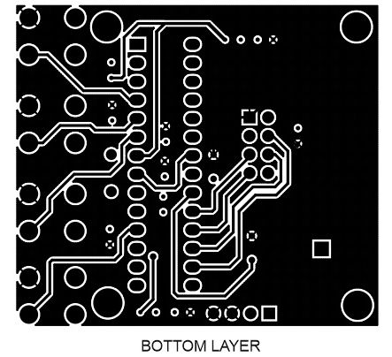

This is an open-source Arduino compatible board that enables you to build a 4 channel RF remote control. The project consists of an Atmega328 microcontroller, 4 tactile switches, nRF24L01 2.4Gz RF Transceiver Module, power LED, function LED, and 3.3V regulator.
This is an open-source Arduino compatible board that enables you to build a 4 channel RF remote control. The project consists of an Atmega328 microcontroller, 4 tactile switches, nRF24L01 2.4Gz RF Transceiver Module, power LED, function LED, and 3.3V regulator. The operating supply is 5V DC. All switches are connected between Arduino pins and GND and they can be used with internal pull-up resistors. The receiver can be an Arduino UNO with the following PIN configurations. A suitable receiver board will be published soon.

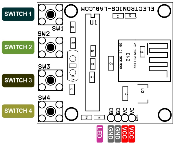

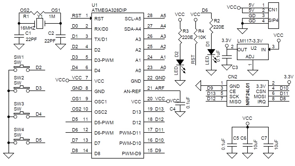

Transmitter
TX Arduino Pins
- Switch 1>> Digital Pin D2
- Switch 2 >>Digital Pin D3
- Switch 3 >>Digital Pin D4
- Switch 4 >>Digital Pin D5
- LED D1 >> Digital Pin D6
TX NDRF24L01 Transceiver Module
- CE>> Digital pin D9
- CSN>> Digital pin D10
- MOSI>> Digital pin D11
- MISO>> Digital pin D12
- SCK>> Digital pin D13
- IRQ>> Digital pin D8
- 3V and GND

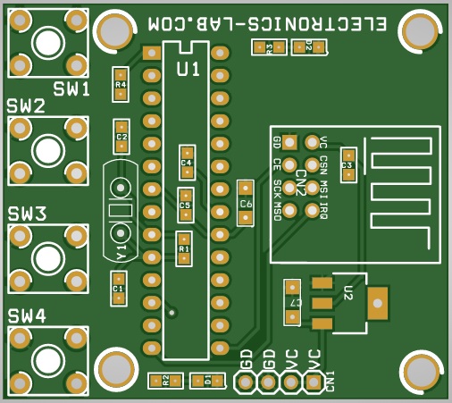

Specifications
- Power supply: 5Vdc
- Onboard status LED
- PCB dimensions: 49.85 x 44.29 mm

Schematic

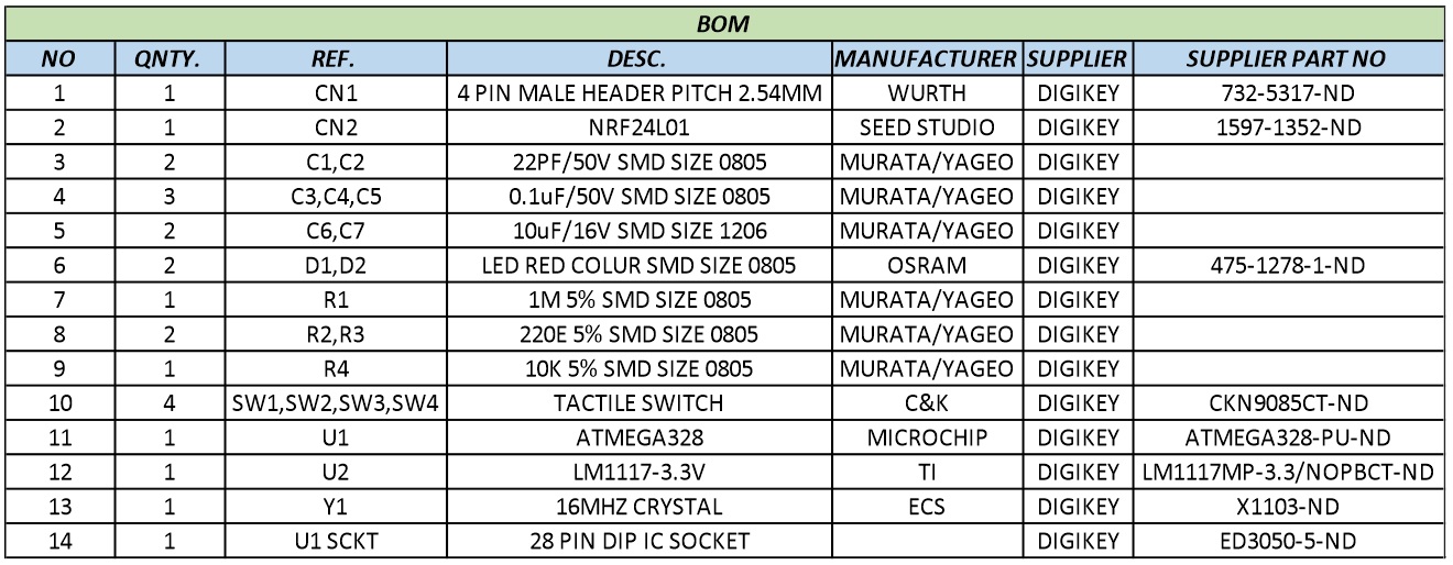

Parts List
| NO | QNTY. | REF. | DESC. | MANUFACTURER | SUPPLIER | SUPPLIER PART NO |
| 1 | 1 | CN1 | 4 PIN MALE HEADER PITCH 2.54MM | WURTH | DIGIKEY | 732-5317-ND |
| 2 | 1 | CN2 | NRF24L01 | SEED STUDIO | DIGIKEY | 1597-1352-ND |
| 3 | 2 | C1,C2 | 22PF/50V SMD SIZE 0805 | MURATA/YAGEO | DIGIKEY | |
| 4 | 3 | C3,C4,C5 | 0.1uF/50V SMD SIZE 0805 | MURATA/YAGEO | DIGIKEY | |
| 5 | 2 | C6,C7 | 10uF/16V SMD SIZE 1206 | MURATA/YAGEO | DIGIKEY | |
| 6 | 2 | D1,D2 | LED RED COLUR SMD SIZE 0805 | OSRAM | DIGIKEY | 475-1278-1-ND |
| 7 | 1 | R1 | 1M 5% SMD SIZE 0805 | MURATA/YAGEO | DIGIKEY | |
| 8 | 2 | R2,R3 | 220E 5% SMD SIZE 0805 | MURATA/YAGEO | DIGIKEY | |
| 9 | 1 | R4 | 10K 5% SMD SIZE 0805 | MURATA/YAGEO | DIGIKEY | |
| 10 | 4 | SW1,SW2,SW3,SW4 | TACTILE SWITCH | C&K | DIGIKEY | CKN9085CT-ND |
| 11 | 1 | U1 | ATMEGA328 | MICROCHIP | DIGIKEY | ATMEGA328-PU-ND |
| 12 | 1 | U2 | LM1117-3.3V | TI | DIGIKEY | LM1117MP-3.3/NOPBCT-ND |
| 13 | 1 | Y1 | 16MHZ CRYSTAL | ECS | DIGIKEY | X1103-ND |
| 14 | 1 | U1 SCKT | 28 PIN DIP IC SOCKET | DIGIKEY | ED3050-5-ND |
Connections
