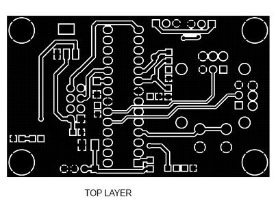

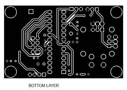

Single Joystick Remote Control Transmitter using NRF24L01 – Arduino Compatible

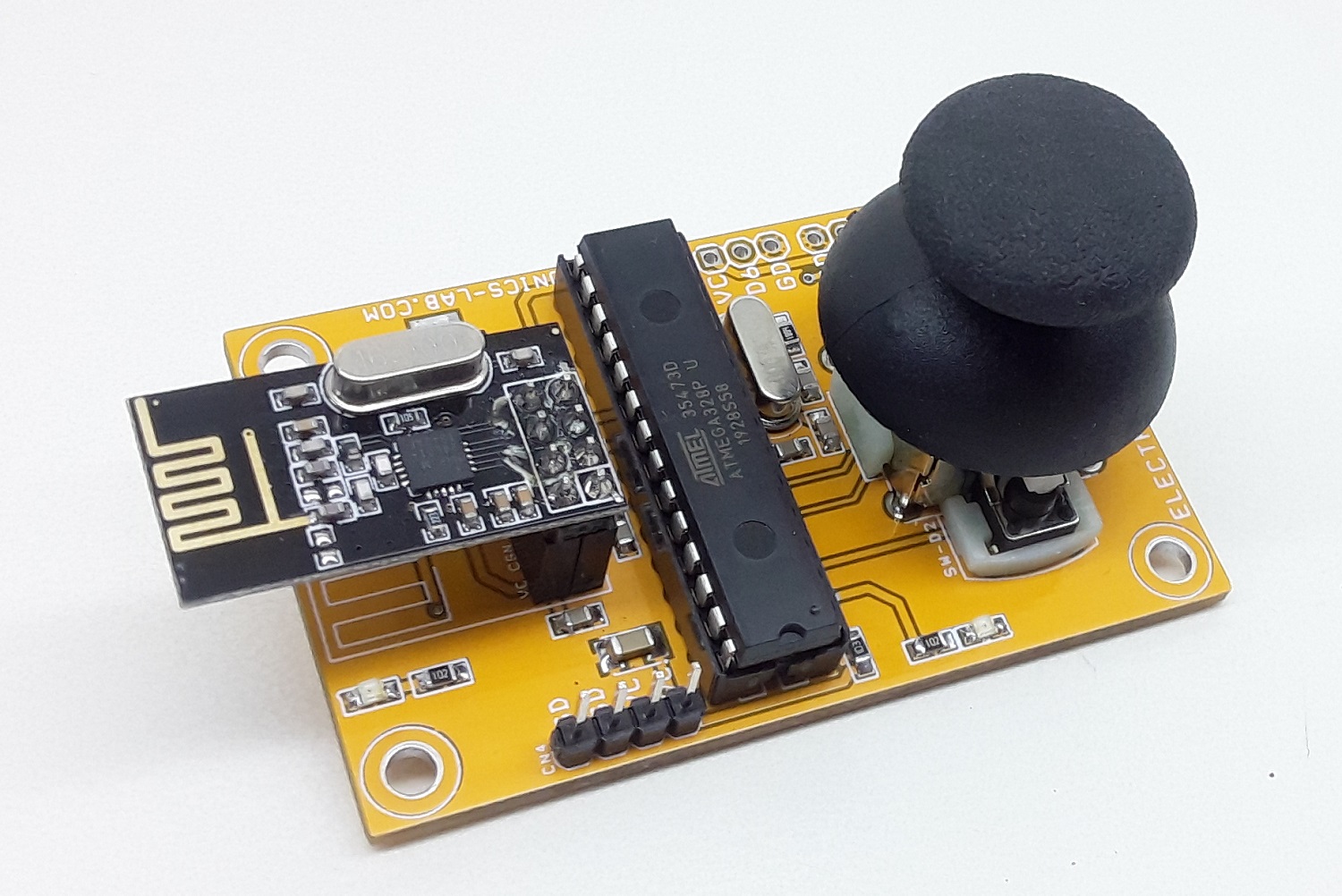

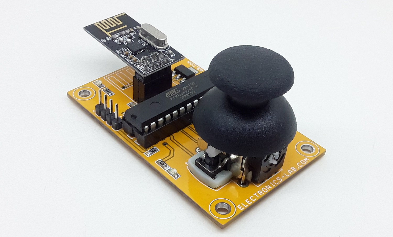

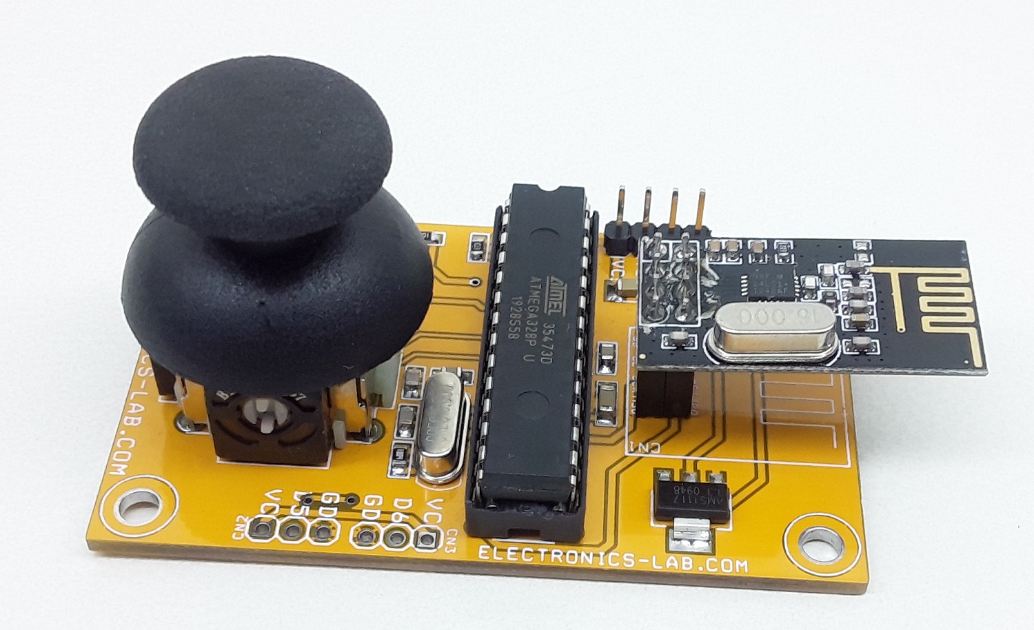

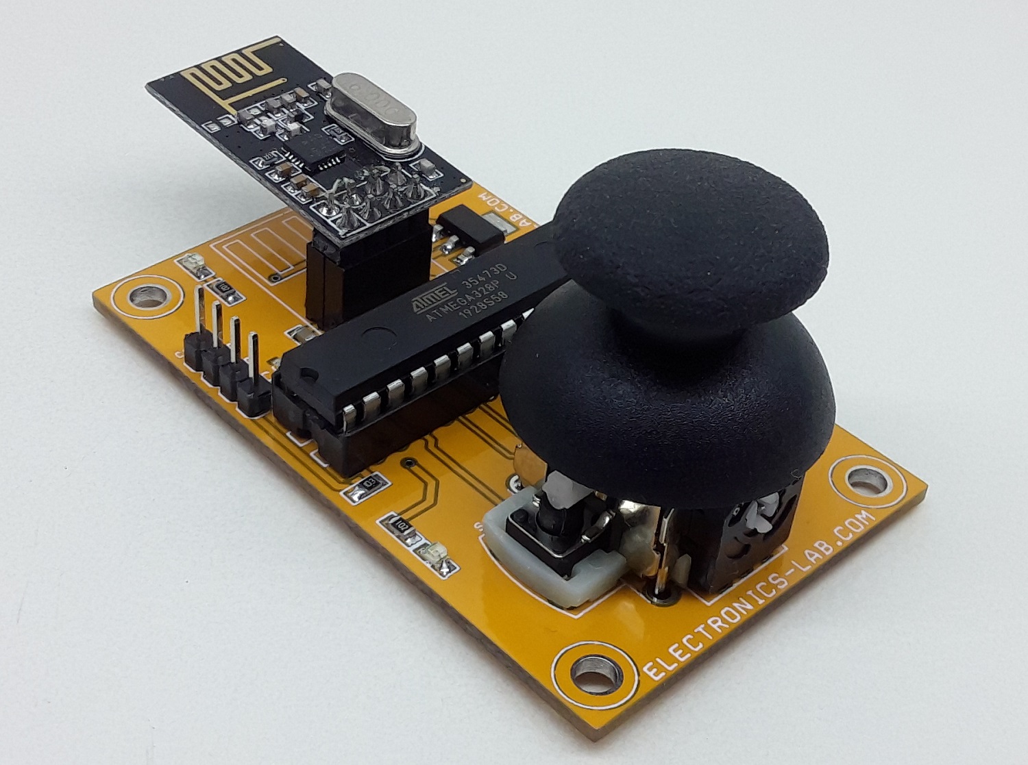

This is an Arduino compatible open-source hardware that includes 1 x joystick, NRF24L01 RF module, Atmega328D microcontroller, 3.3V regulator, power LED, function LED, and other required components. This board can be used for the development of various applications such as Gaming, Remote RC servo driver, RC Motor controller, Robotics, and many more.

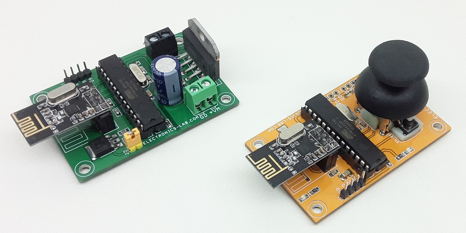

Arduino Code is available for testing purposes and the project works as a transmitter and drives DC motor controller board with this code. The project is compatible with our DC Motor speed and direction controller board, and 8 Channel RC Servo Board.
Check the link below to learn more about programming a bare new ATMEGA328 chip.
https://www.arduino.cc/en/Tutorial/BuiltInExamples/ArduinoToBreadboard

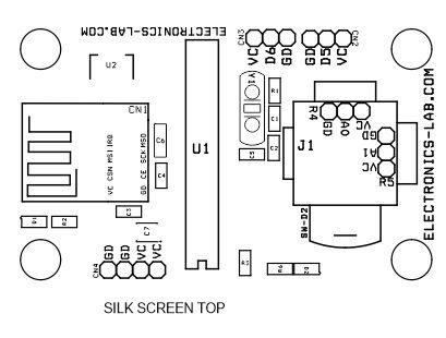

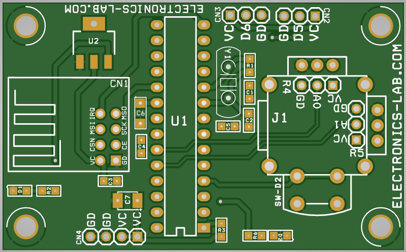

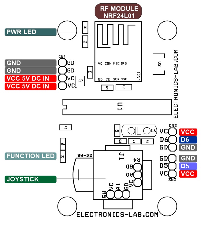

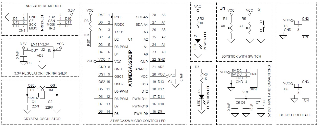

Arduino Pins
- Joystick J1 >> Arduino Analog Pin A0 and A1
- Joystick Tactile Switch=Digital Pin D2
- Function LED D2 = Arduino Digital Pin D3 (Optional, Solder If required)
- NRF24L01 RF Module >> CE=D9, CSN=D10, MOSI=D11, MISO-D12, SCK=D13, IRQ=D8
- Connector CN2 and CN3 Optional (Optional, Do Not Populate)
- Supply 5V DC (CN4)
- Onboard Power LED D1
- On-Board Function LED D2
- One Joystick 2-axis

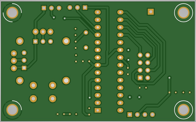

- PCB Dimensions 65.41 x 40.32 mm
Schematic

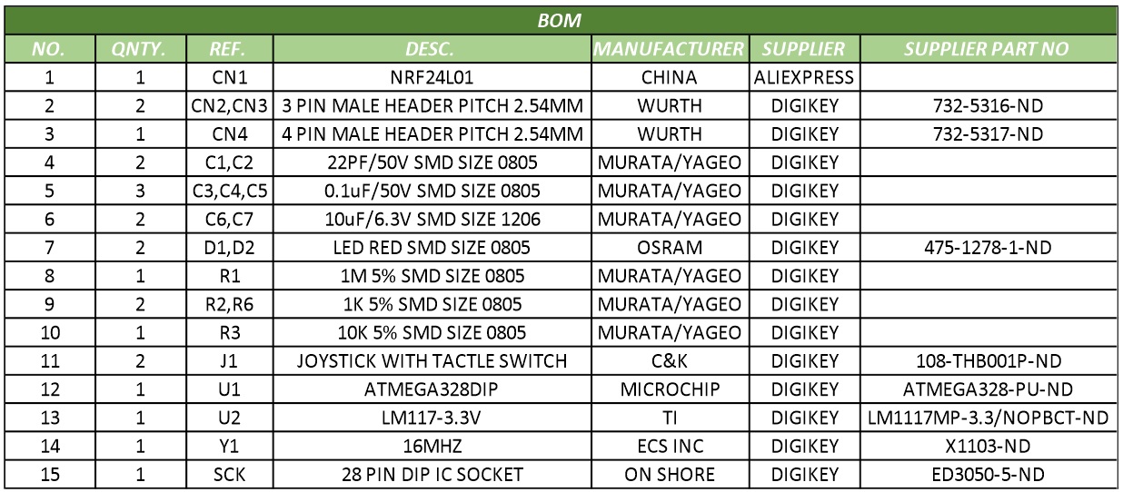

Parts List
| NO. | QNTY. | REF. | DESC. | MANUFACTURER | SUPPLIER | SUPPLIER PART NO |
| 1 | 1 | CN1 | NRF24L01 | CHINA | ALIEXPRESS | |
| 2 | 2 | CN2,CN3 | 3 PIN MALE HEADER PITCH 2.54MM | WURTH | DIGIKEY | 732-5316-ND |
| 3 | 1 | CN4 | 4 PIN MALE HEADER PITCH 2.54MM | WURTH | DIGIKEY | 732-5317-ND |
| 4 | 2 | C1,C2 | 22PF/50V SMD SIZE 0805 | MURATA/YAGEO | DIGIKEY | |
| 5 | 3 | C3,C4,C5 | 0.1uF/50V SMD SIZE 0805 | MURATA/YAGEO | DIGIKEY | |
| 6 | 2 | C6,C7 | 10uF/6.3V SMD SIZE 1206 | MURATA/YAGEO | DIGIKEY | |
| 7 | 2 | D1,D2 | LED RED SMD SIZE 0805 | OSRAM | DIGIKEY | 475-1278-1-ND |
| 8 | 1 | R1 | 1M 5% SMD SIZE 0805 | MURATA/YAGEO | DIGIKEY | |
| 9 | 2 | R2,R6 | 1K 5% SMD SIZE 0805 | MURATA/YAGEO | DIGIKEY | |
| 10 | 1 | R3 | 10K 5% SMD SIZE 0805 | MURATA/YAGEO | DIGIKEY | |
| 11 | 2 | J1 | JOYSTICK WITH TACTLE SWITCH | C&K | DIGIKEY | 108-THB001P-ND |
| 12 | 1 | U1 | ATMEGA328DIP | MICROCHIP | DIGIKEY | ATMEGA328-PU-ND |
| 13 | 1 | U2 | LM117-3.3V | TI | DIGIKEY | LM1117MP-3.3/NOPBCT-ND |
| 14 | 1 | Y1 | 16MHZ | ECS INC | DIGIKEY | X1103-ND |
| 15 | 1 | SCK | 28 PIN DIP IC SOCKET | ON SHORE | DIGIKEY | ED3050-5-ND |
Connections
Compatible board
