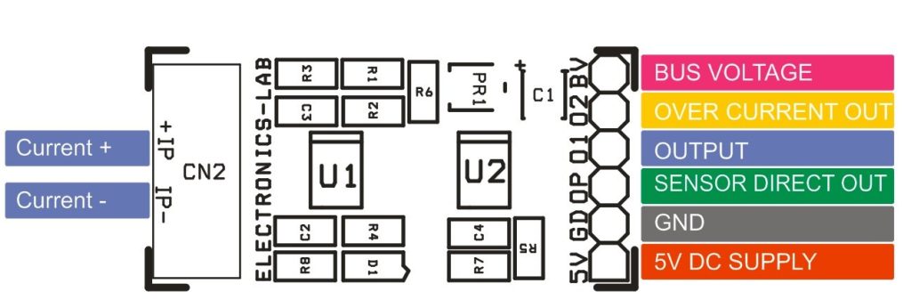

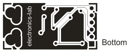

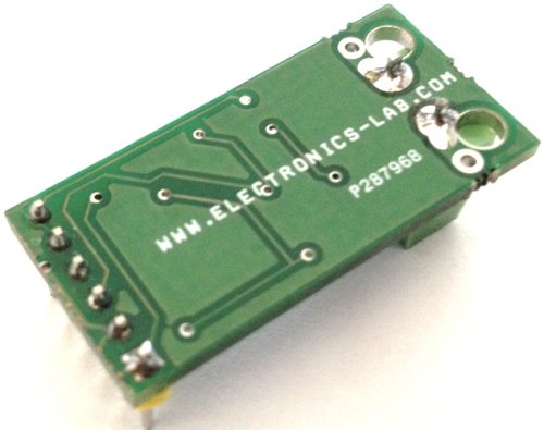

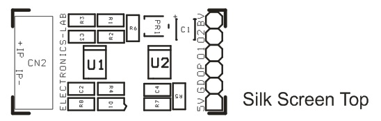

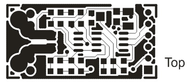

This current sensor amplifier and over current switch project is based on ACS714-30A current sensor and LM358 OPAMP, ½ of LM358 op-amp used as an amplifier for low voltage and 2nd 1/2 LM358 op-amp used as a comparator which provides over current TTL output, trimmer potentiometer provided to set the over current limit. ACS714 sensor measures the current up to +/-30Amps, the final output of the amplifier is 235mV/1A, and normally over current output is High-TTL.
This current sensor amplifier and over current switch project is based on ACS714-30A current sensor and LM358 OPAMP, ½ of LM358 op-amp used as an amplifier for low voltage  and 2nd 1/2 LM358 op-amp used as a comparator which provides over current TTL output, trimmer potentiometer provided to set the over current limit.  ACS714 sensor measures the current up to +/-30Amps, the final output of the amplifier is 235mV/1A, and normally over current output is High-TTL. It goes low once the current overshoot than a set point. The circuit requires 5V DC and 40mA, and the onboard LED indicates the power. Resistor divider R1, R3 provides bus voltage output for a microcontroller interface to measure the bus voltage, choose the appropriate value for R3, R1 as per your application and bus voltage, it should be less than 5V DC.

Note: OPAMP U2B is used as a comparator and Trimmer Pot PR1 swing from 0 to 5V so the threshold can be adjusted between 0 to 5V. Sensor output is 235mV/1 Amp, so, for example, is 2.35V for 10Amp
  • Supply 5V DC
  • ACS714-30 low noise direct output 66mV/Amp
  • LM358 Amplifier Output 235mV/Amp
  • Over Current Output (Normally High-TTL Goes low at overcurrent set point)
  • Trimmer Preset to set the Overcurrent limit
  • Bus voltage output
  • Power LED
  • Screw Terminal for Current
  • Header Connector for outputs and supply
Header Connector Connections
  • Pin 1 :  VCC 5V DC Supply
  • Pin 2 : Supply GND
  • Pin 3 : VOP- ACS715-30 Sensor Direct Output 66mV/Amp
  • Pin 4 : OP1- Amplifier Output 235mV/amp
  • Pin 5 : OP2 Over Current  Output ( Normally High-TTL, Goes Low at Over Limit)
  • Pin 6 : BSV- Bus Voltage Output
