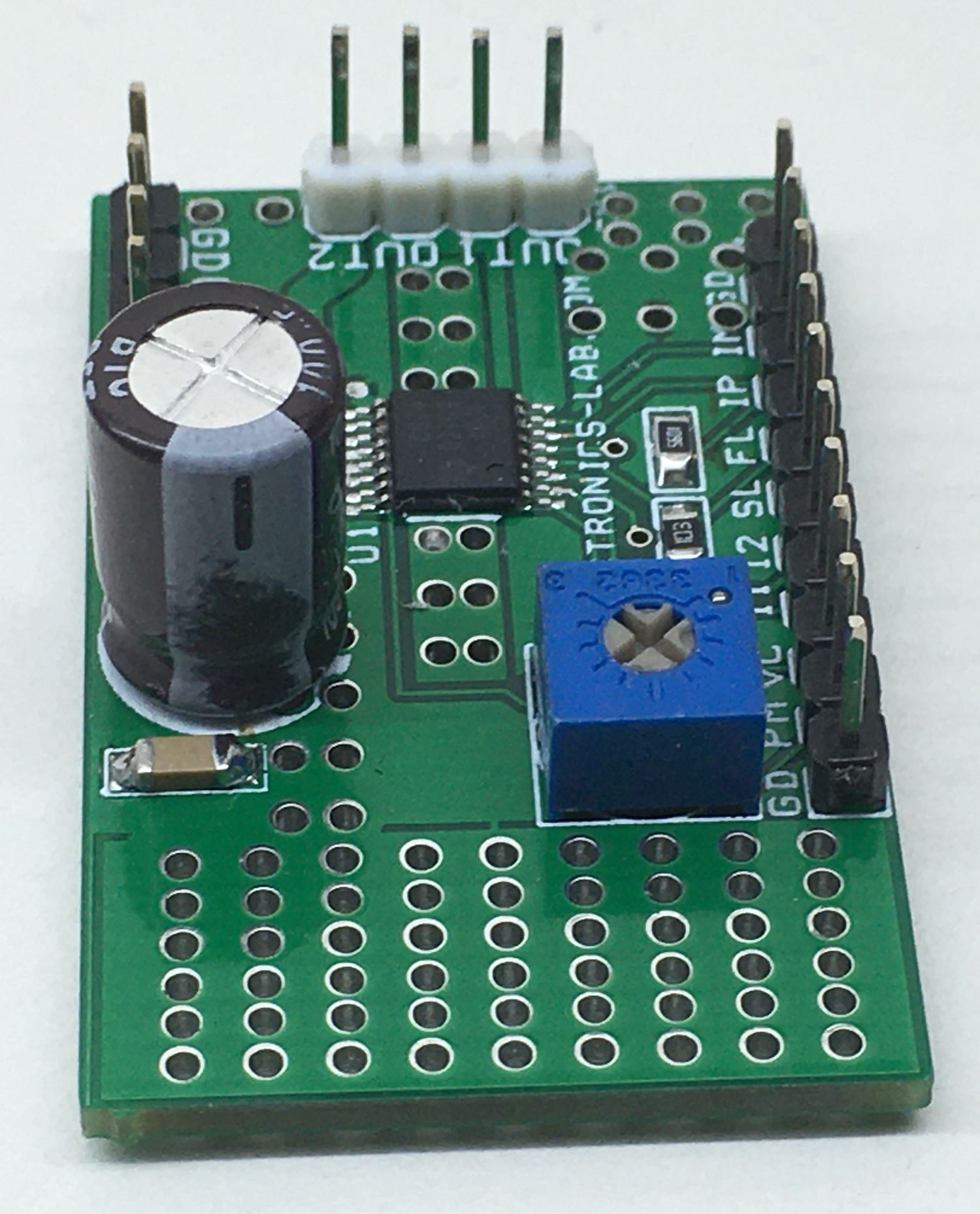

In past, we have published many brushed dc motor driver boards for various projects and usually, they have some sort of limitations, as some of them are large in size, require large size heatsink, doesn’t have current feedback, they don't have overload protection, some require external large size current shunt resistor and after all, recently we have found the amazing DRV8874 chip from Texas instruments that has some amazing features and protections features. It has a small package and can handle high current without a heatsink.

Highlights
  • Speed Control
  • Direction Control
  • Current Regulation/sense
  • Over Current Trip
  • Motor Power Supply 4.5V to 24V (Maximum Input 37V DC)
  • Load Current 0.5A/1A (3.7A Maximum)
  • Peak Load Current 6 Amps
  • PWM Frequency 10Khz to 20Khz
  • PWM Duty Cycle 0-100%
  • Proportional current output (IPROPI) 1.5V output when load current 0.5A
  • No Heat-sink Required
  • Trimmer Potentiometer to set Overload Protection
  • Over Load Protection with I Trip
  • Logic Supply 3.3V
  • Required PWM and DIR signal
  • Brake Function Available
  • Undervoltage lockout (UVLO)
  • Thermal shutdown (TSD)
  • Automatic fault recovery
  • All Input Signals 3.3V Voltage Level (Supports 1.8-V, 3.3-V, and 5-V logic inputs)
  • Fault Output (Normally High 3.3V, Low when Fault Condition Occurs)
  • Enable Input (High Input Enables, Low input Disables the output)
  • PCB Dimensions 40.64 x 26.19 mm

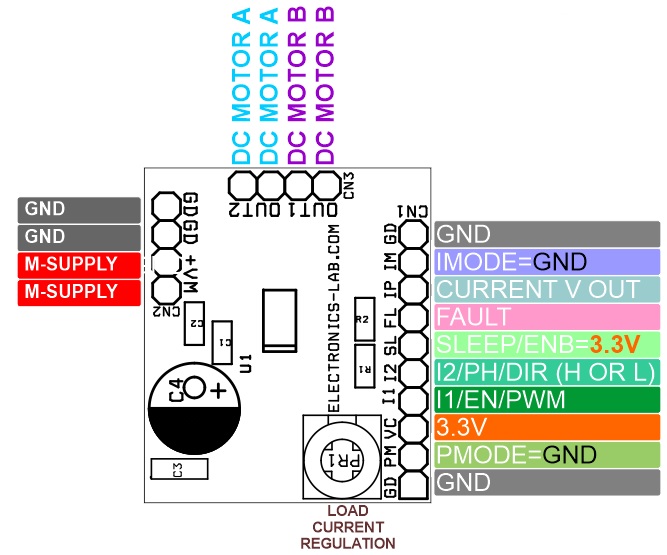

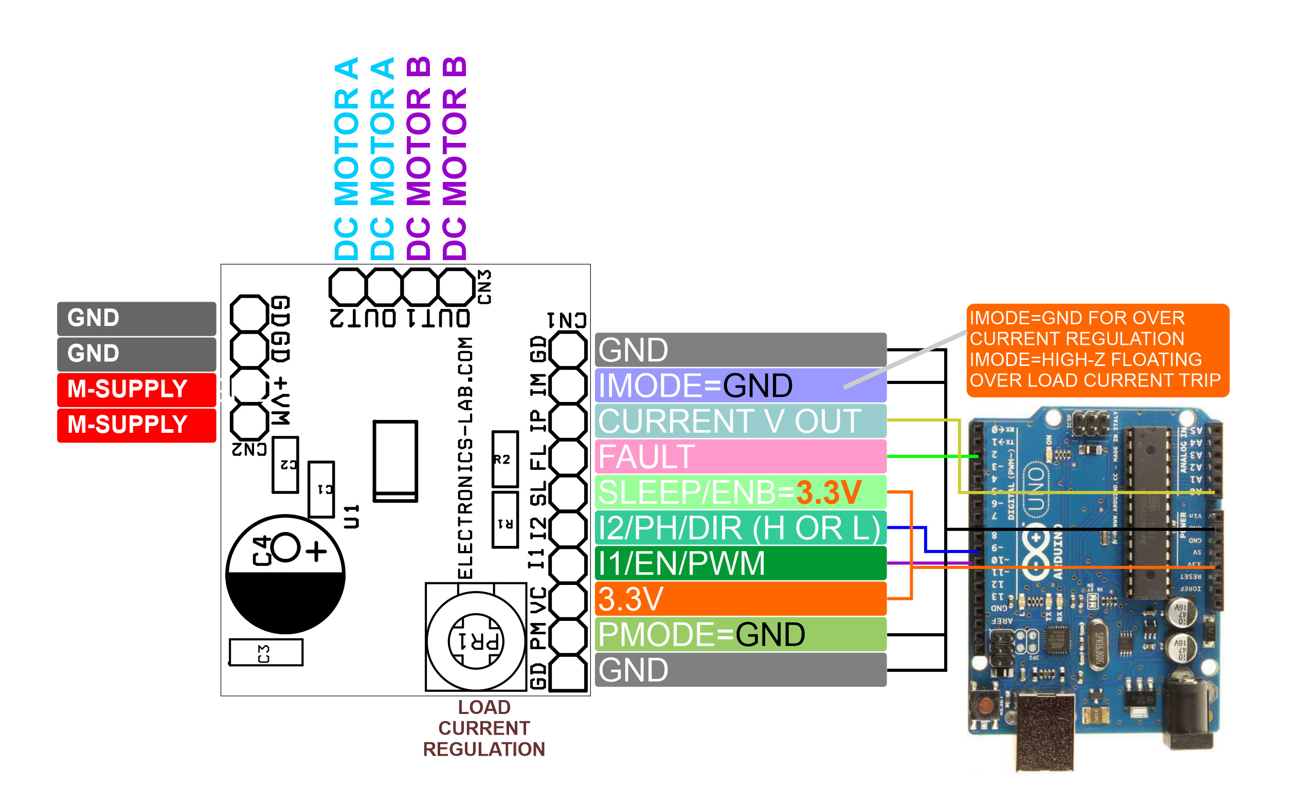

In the primary application example, we have configured and tested this project to drive bidirectional current through an external load (such as a brushed DC motor) using an H-bridge configuration. The H-bridge polarity and duty cycle are controlled with a PWM and I/O resource from an external controller like Arduino, connected to the EN/I1 (PWM) and PH/I2 (DIR) pins. The device is configured for the PH/EN control mode by tying the PMODE pin to GND. The current limit threshold (ITRIP) is generated with a trimmer potentiometer PR1 from the control logic supply voltage (3.3V). The device can be configured for the fixed off-time current regulation scheme by tying the IMODE pin to GND or Over current/Load output latched off by keeping this pin floating (Hi-Z).  The load current is monitored with an ADC from the controller to detect the voltage across R2 RIPROPI. Current is set to 0.5A. Operating frequency 10 to 20Khz. PWM 0 to 100%.
Following Signals/Inputs needed to control the motor for speed and direction type of interface (CN1 = 10 Pin Header Connector)
  • Pin 1: GND
  • Pin 2: PM, Connect this Pin to GND (Low Level signal/GND)
  • Pin 3: VC (3.3V/100mA Logic Supply)
  • Pin 4: I1 (PWM Input 0- 100% Duty Cycle, Frequency 10 to 20Khz)
  • Pin 5: I2 (High or Low Level to Control the direction of the motor) High=3.3V, Low= GND
  • Pin 6: SL (Sleep Mode, bringing this pin to Low, chip goes in sleep mode, High input enable the board) High=3.3V, Low = GND
  • Pin 7: FL (Fault Output, this is an output pin normally high, goes low when fault condition occurs)
  • Pin 8: IP (Motor Load Current Feedback output pin provides Analog voltage output to interface with ADC)
  • Pin 9: IM (The device is configured for the fixed off-time current regulation scheme by tying the IMODE pin to GND)
  • Pin10: GND
Note: When switching between modes, completely power down the project before changing the inputs.
Note: Default Load Current is 0.5A/1A , Refer to the formula below to change the load current, R2=5.6K 0.5A/1A, R2=1.5K Load Current Maximum 3.7A.
Testing the Board
An example Arduino code is provided to test the board. The Arduino generates the PWM Signal and DIR signal. Check the connection diagram above and hook up all the connections accordingly. Set the I TRIP trimmer potentiometer in middle, connect the motor and power supply, the motor should move with half speed forward after 2 seconds reverse in a loop.
Arduino Digital pin D9 is connected to I2/PH/DIR, Arduino Digital Pin D10 is connected to I1/EN/PWM, SL-nSleep=3.3V, VC=3.3V, GND=GND, PMode=GND, IMODE=GND or Floating, Fault pin can be connected to any of digital pin of Arduino if required, Current feedback IP can be connected to the analog input of Arduino to measure the motor load current.

Connections

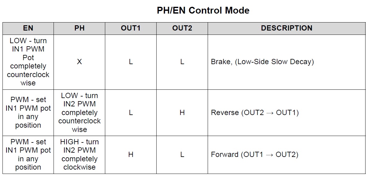

Truth Table

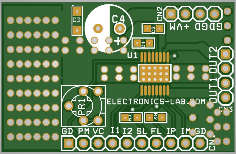

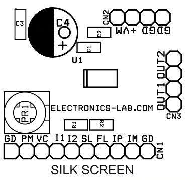

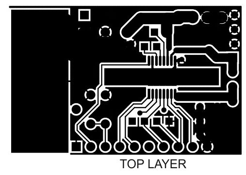

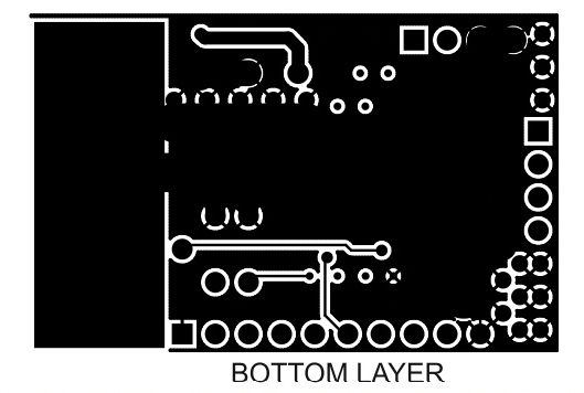

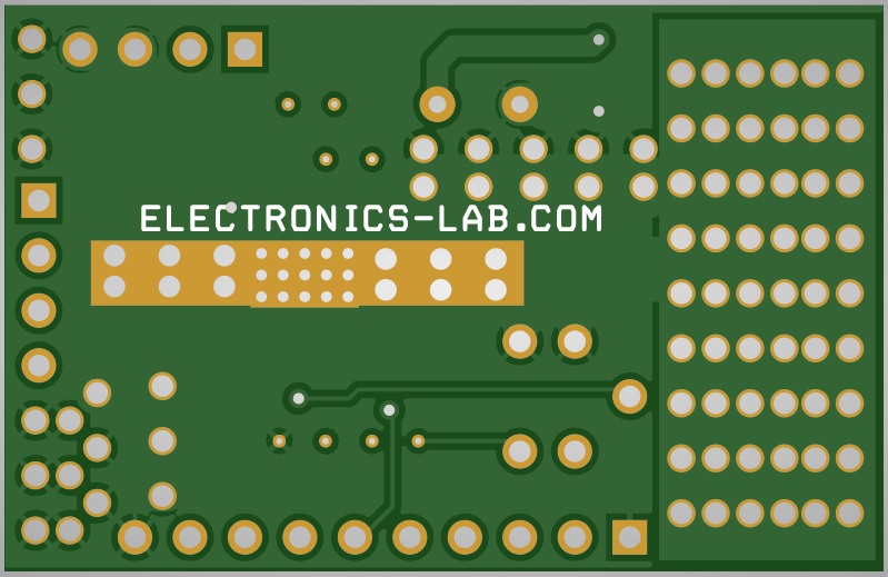

Gerber View

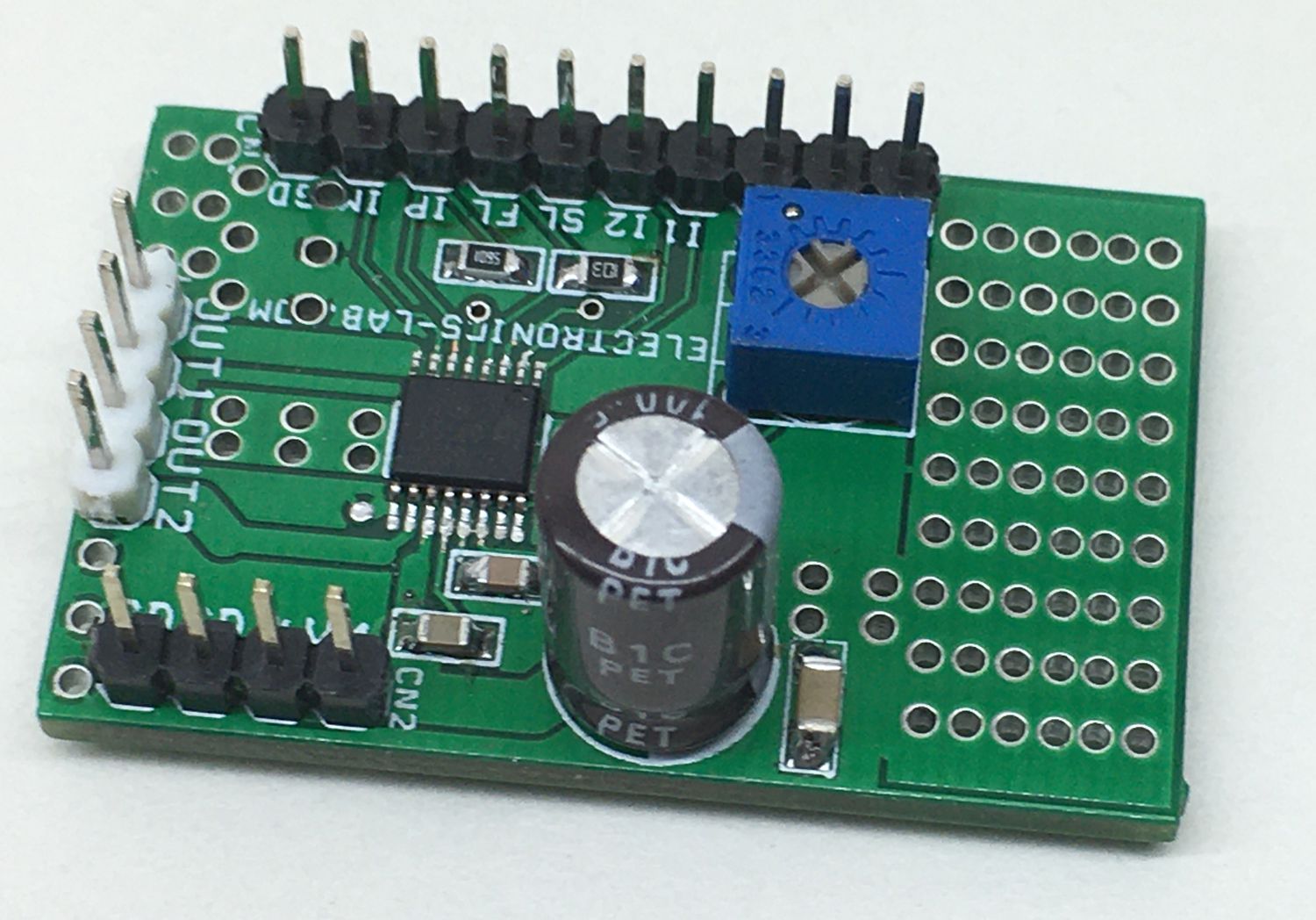

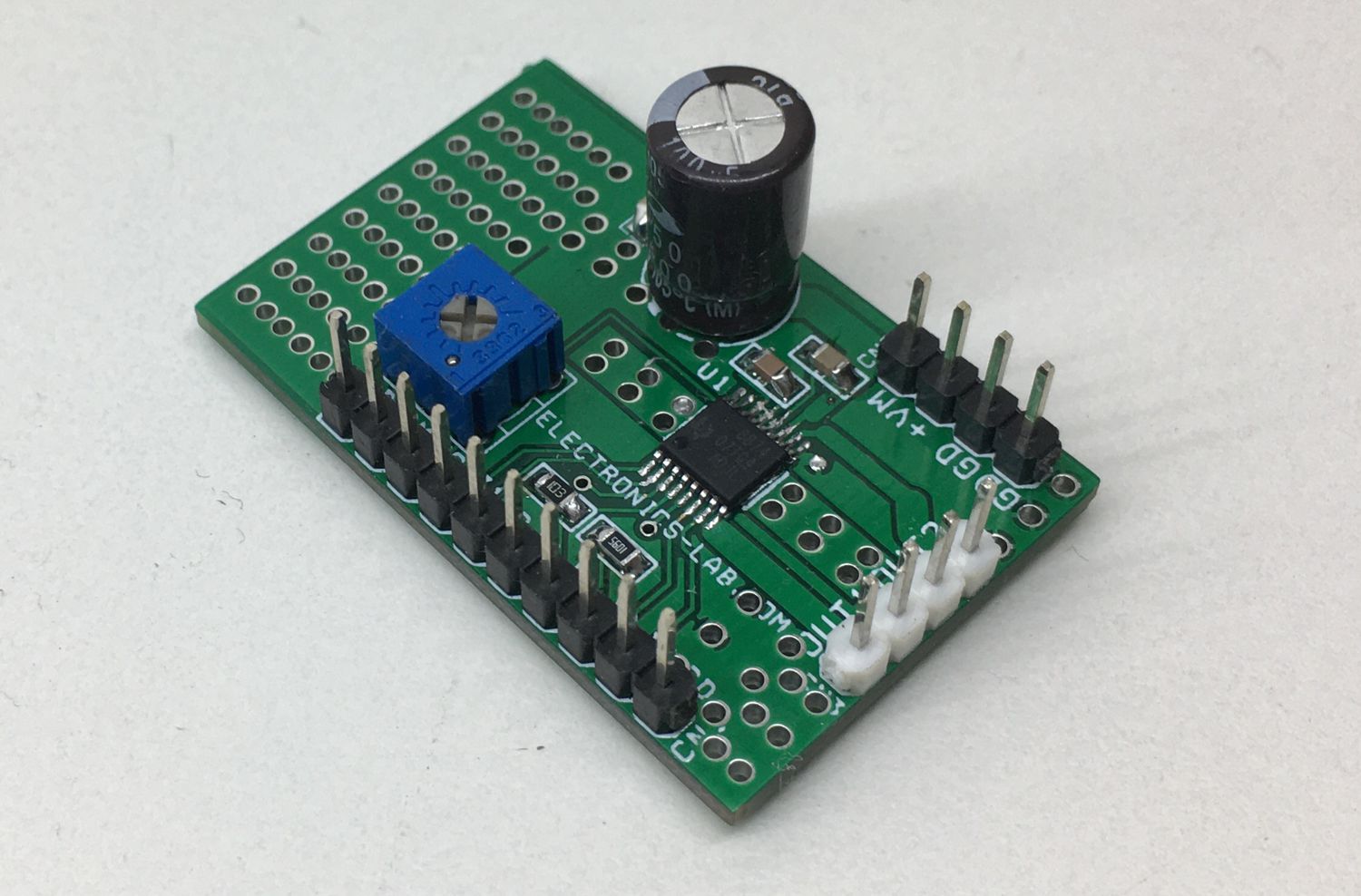

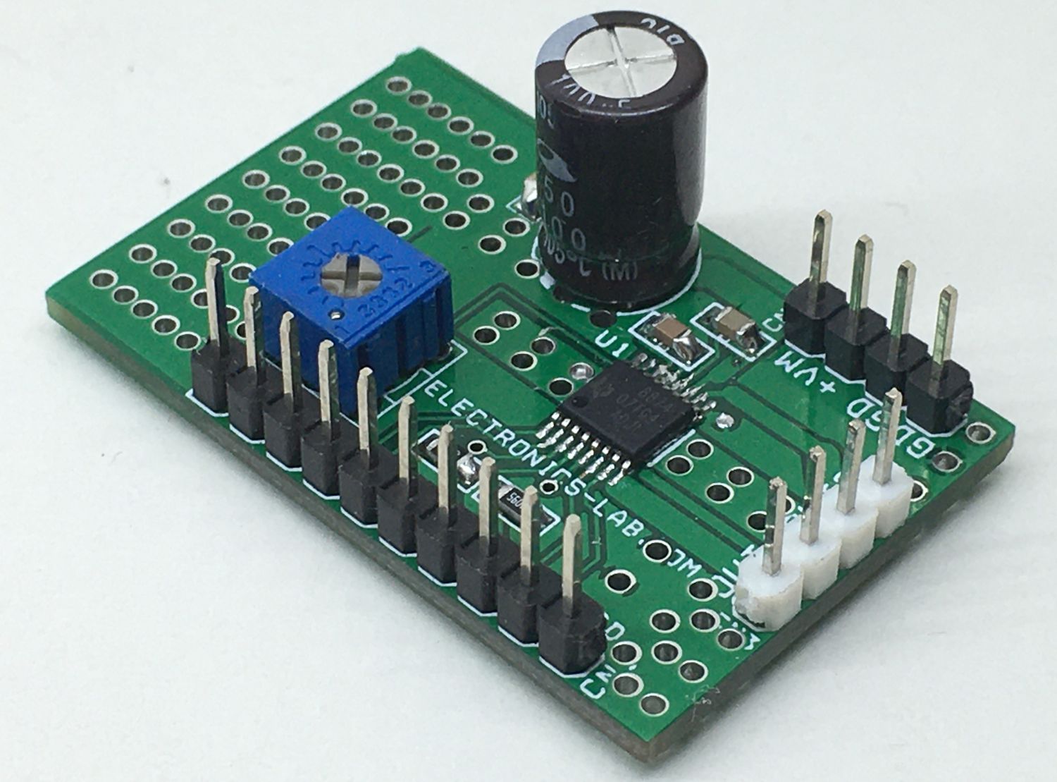

Photos
