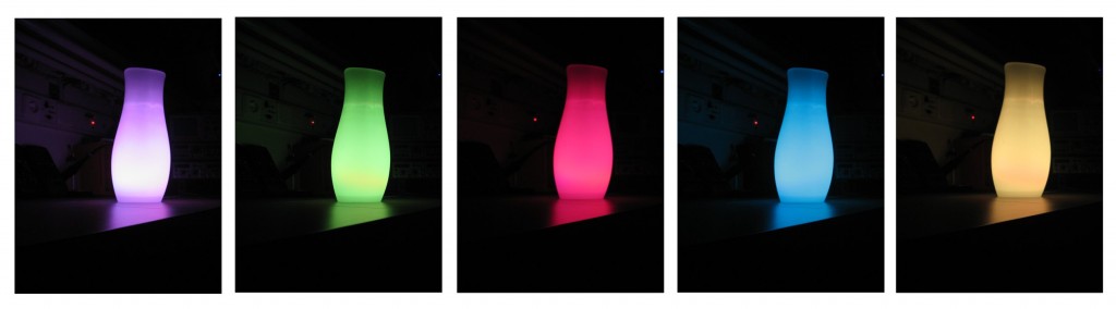

In this page we will introduce a great project designed by Toon Beerten. His project named “DIY Led Mood Lamp” can become a very interesting add-on for your room that’s absolutely sure it will impress everyone. As you can see on the photos, we talk about a color fading lamp, that looks amazing!
The purpose of this page is to try to give some hints building it successful. This high power led mood light is based on PIC16F628 and the ability of this mcu to produce PWM pulses. Varying pulse width we can produce millions of color combinations using only the three basic colors. So only one RGB (Red-Green-Blue) led is capable producing a rainbow of fading colors.
image_4
With the help of four switches we can handle all functions of the lamp. We can choose fading or jumping between colors, we can select a rainbow style or a random color changing behavior, we can choose slow or fast changing of colors and we can pause on a desired color.

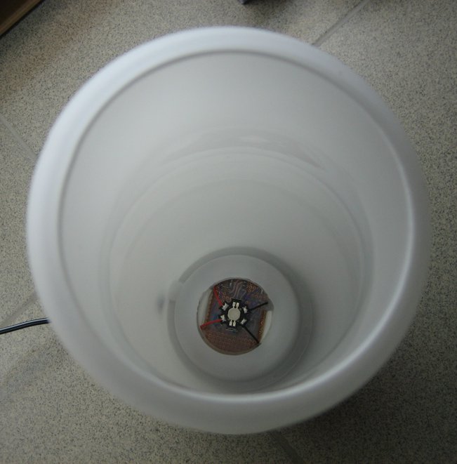

You can use your imagination to find a housing that will be able to diffuse colors uniformly. Color difussion is necessary to achieve best results. In original design the author used the 45cm IKEA Mylonit lamp. That’s a great housing for your lamp. Instead you can use the smaller 31cm IKEA Mylonit lamp with the same amazing results. That’s the lamp we used in our construction.

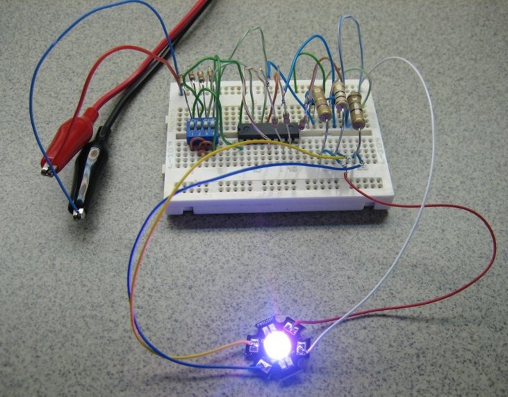

On the next image you can see the circuit arranged on a perforated board.
image_5

A good way to mount the circuit board is to use a hot glue gun to “mold” the circuit underneath the lamp housing. There is plenty of space there for your board. At the next photos you can see the circuit board mounted on the small 31cm IKEA Mylonit Lamp.
The glue is still hot. Temperature of glue didn't damage the PIC or other parts.
The glue is still hot. Temperature of glue didn’t damage the PIC or other parts.
The glue is now cold and you can easily access the dip switches. Lamp is working!

I have tried in breadboard with small/ ordinary leds – no transistor, it works very well.
However, if I added BD135 with power leds, only blinding and no operating properly.
Sinan Ucar
The problem: pic output ports couldn’t provide efficient base current to drive to transistors.
Solution: add more transistors to build pairs with darlington connection, the circuit would work well.
