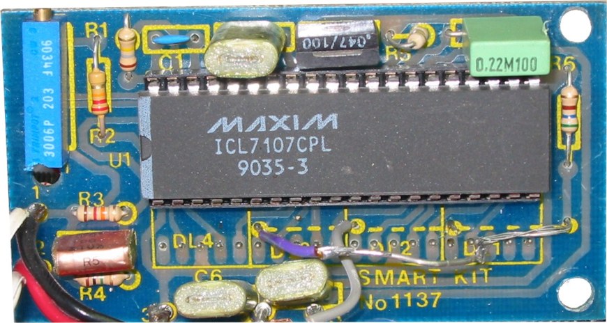

in the given circuit what is “P1”?????????????
Its the trimmer potentiometer for calibration ! the little blue thing in the corner
its a 20k trimming potentiometer

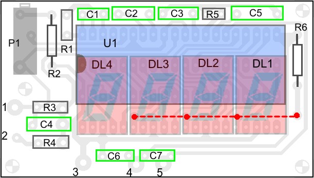

is that the pcb actual size?
To find out the correct PCB dimensions you have to print it some times at different scales and try to fit the IC on the print.
Try using DIPTrace for designing the PCB it has hundreds of default footprints of components.
c6??????c7?????
C7 and C6 are 100nF filter capacitors not shown in schematic

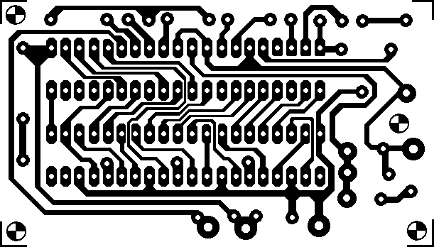

in the copper side of this project stated above in first image have 1 resistor 120k connected in pin 1 in the same time the copper clad is connected. what is the purpose and function of resistor in connected to pin 1?
