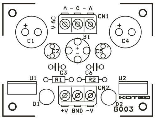

This Project provides Positive and Negative (Dual Output) 5 V @ 1 A Regulated Power Supply. Specifications Input 7-0-7 VAC to 12-0-12 VAC or +/- 9 to 18 VDC Output : Dual output ± 5 V @ 1 A regulated low ripple DC voltage Heat-sink for regulator ICs Onboard bridge rectifier to convert AC to DC LED indication for both the outputs Thermal overload/short circuit protection (provided by IC feature) Screw terminal connector for easy input and output connection Filter capacitors for low ripple DC output Four mounting holes of 3.2 mm each PCB dimensions 46 mm x 60 mm Schematic Parts List
Power by mixos
5V_Power_Supply_G003
Specifications
  • Input 7-0-7 VAC to 12-0-12 VAC or +/- 9 to 18 VDC
  • Output : Dual output ± 5 V @ 1 A regulated low ripple DC voltage
  • Heat-sink for regulator ICs
  • Onboard bridge rectifier to convert AC to DC
  • LED indication for both the outputs
  • Thermal overload/short circuit protection (provided by IC feature)
  • Screw terminal connector for easy input and output connection
  • Filter capacitors for low ripple DC output
  • Four mounting holes of 3.2 mm each

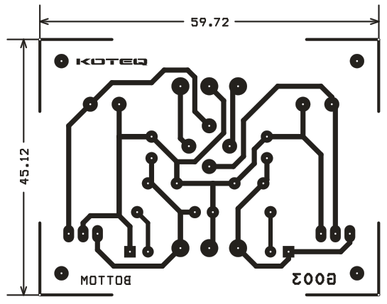

  • PCB dimensions 46 mm x 60 mm

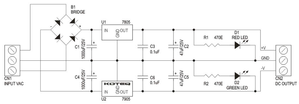

Schematic
5V_Power_Supply_Schematic

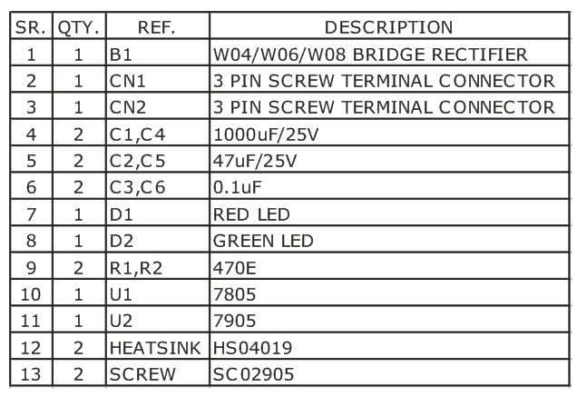

Parts List
5V_Power_Supply_BOM
