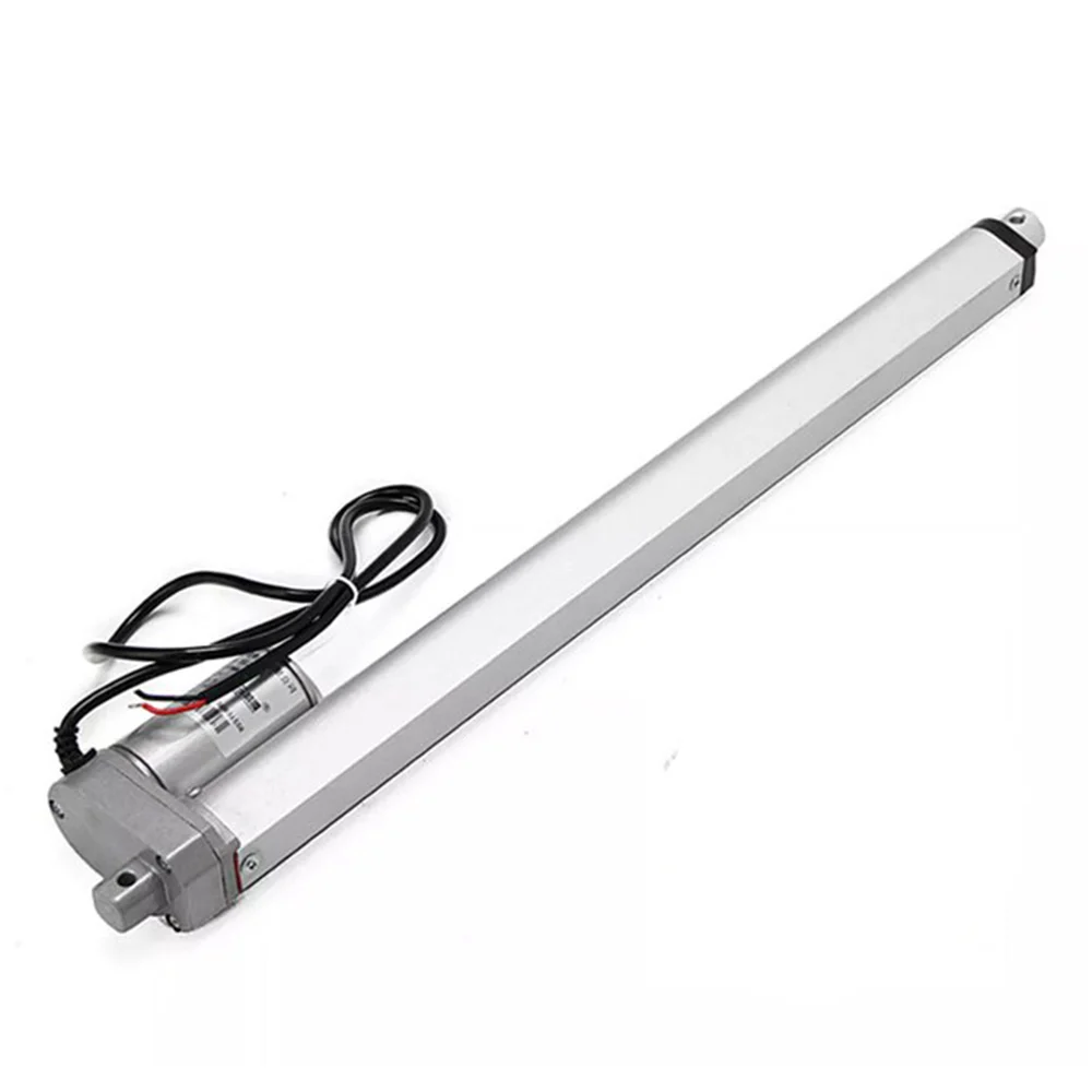

The project described here is a very useful device for use with linear actuators. This controller prevents the actuator from reaching the physical movement limits of the actuator, thus it prevents burnout of motor and physical/mechanical damage to the actuator itself to the mechanical machine associated with it.

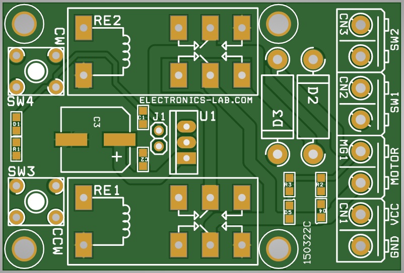

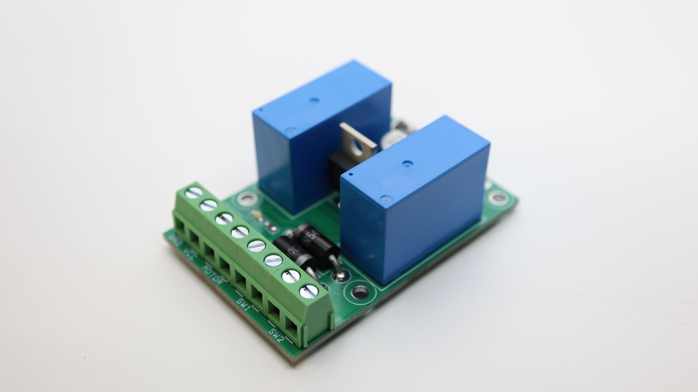

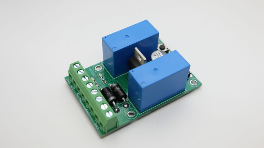

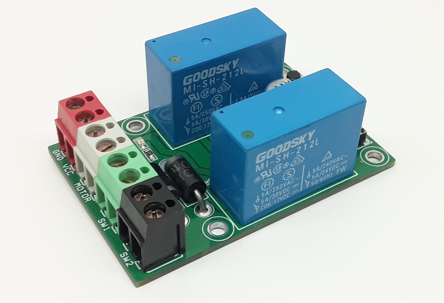

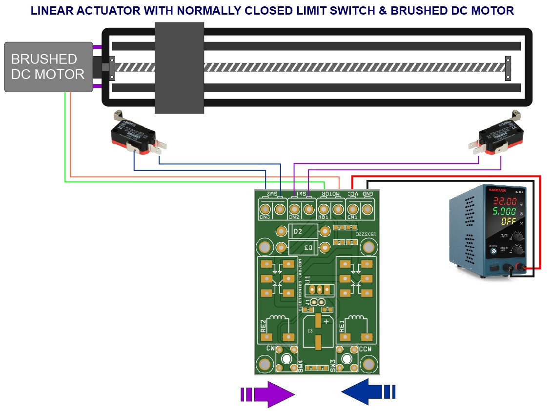

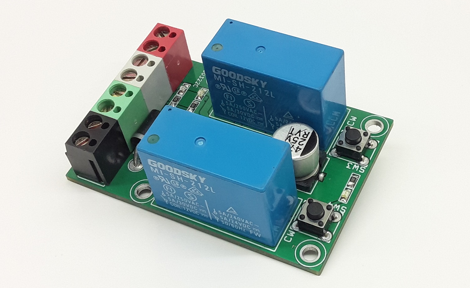

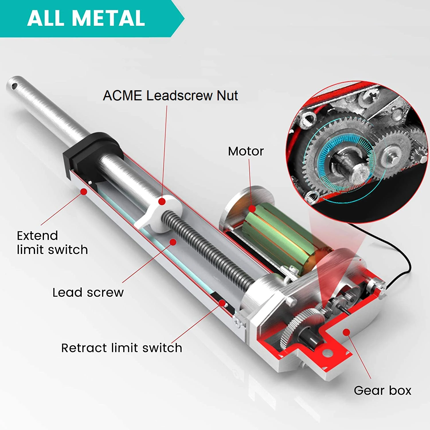

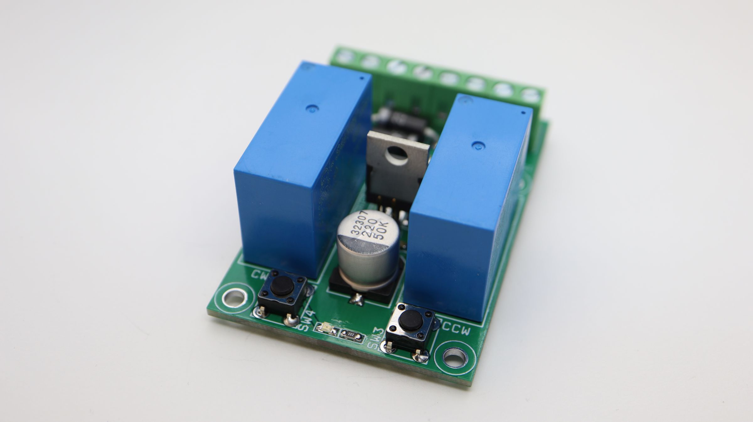

The project described here is a very useful device for use with linear actuators. This controller prevents the actuator from reaching the physical movement limits of the actuator, thus it prevents burnout of motor and physical/mechanical damage to the actuator itself to the mechanical machine associated with it. It also allows for a smoother stopping motion once the end of travel is reached. The project is capable of driving DC brushed motors up to 3A, it supports 12V DC or 24V DC motors with few changes. Two limit switches are used on both sides of the actuator. The limit switches are available with 2 contacts normally open and normally closed. It is advisable to use normally closed contacts. The project consists of 2 DPDT relays, two 1N5402 diodes, Power LED, Motor direction LEDs, 2 x tactile switches, DC supply capacitor, screw terminals, etc.
Operation

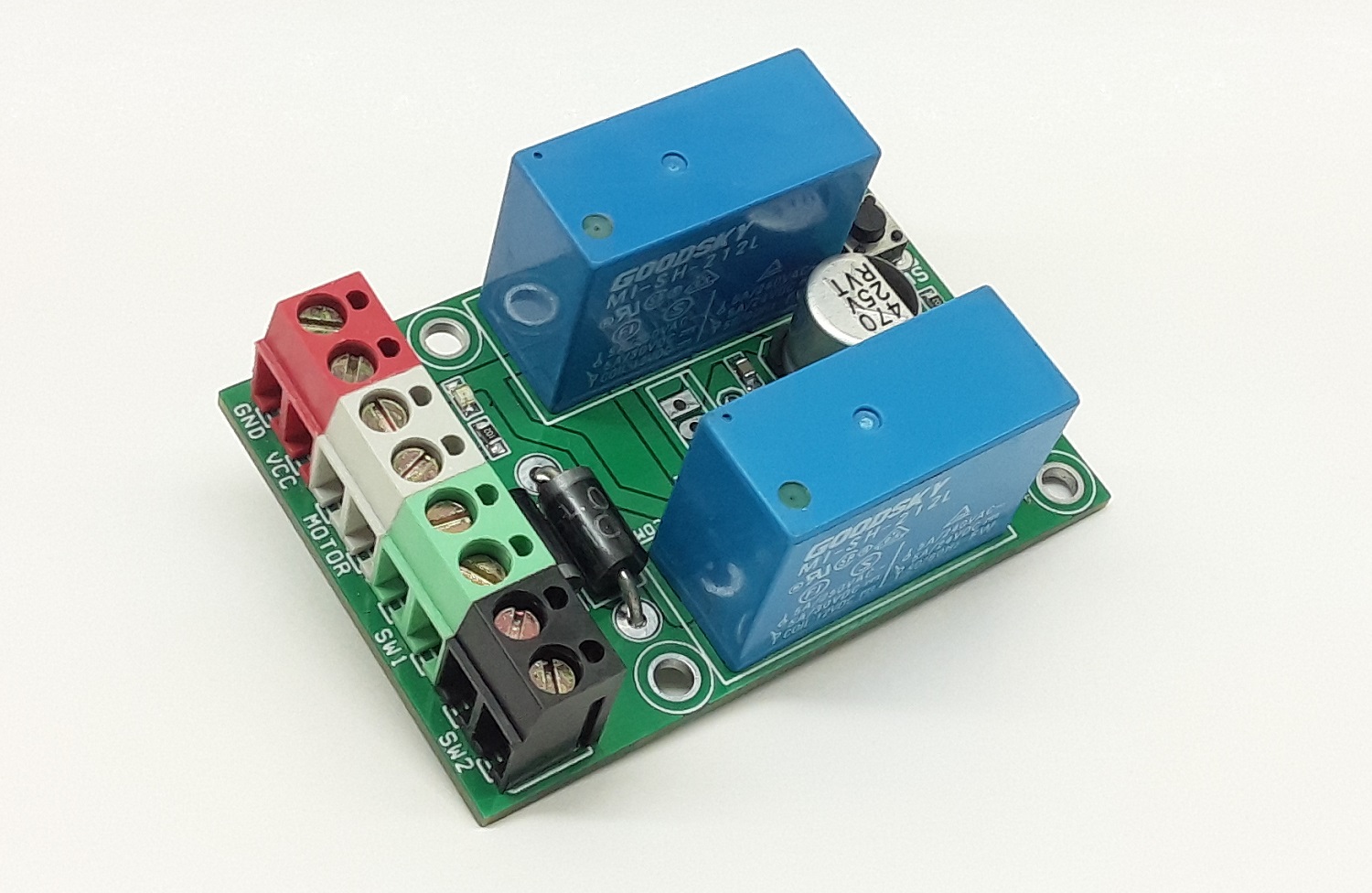

Make all the connections as per the diagram, and install the limit switches at the end of the actuator. It is important to provide little offset space for motor movement. Power the board. Press any of the tactile switches SW1 or Sw2, actuator starts moving in one direction, once it hit the end limit switch, the switch is open, and the diode which is connected across the switch stops the current flow in that direction, and the motor stops. Now press the other switch, in this case, the current flow is reversed and the associated diode allows the motor to run in reverse directions and continue till it hit the other side of the limit switch. It is important to check the motor direction as per diode polarity and swap the motor connections if the system doesn’t work properly or misbehaves.

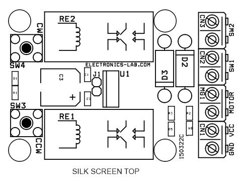

  • Do Not Use Regulator U1, Jumper J1 closed, rest components as per schematic.
24V DC Motor
  • Open the Jumper J1
  • Resistor Value R1, R2, and R3 = 2.2K Ohms
  • Install U1 Regulator LM7812
  • In the case of a 24V Relay, don’t install the regulator, and use jumper J1.
Note: It is advisable to use an appropriate high current limit switch, as it should be able to handle the high current of the DC Motor, considering the peak current of the motor.

  • 2 x Tactile switch to drive Motor in CW/CCW
  • 2 x LEDs for Motor Direction
  • On-Board Power LED
  • Screw Terminals for Motor Connections, Limit Switch, Power Supply
  • 4 x 3mm Mounting Holes
  • PCB Dimensions 63.98 x 43.18 mm

  • Linear Actuators
  • Rotary Actuators
  • Machines
  • Automation
  • Furniture (Hospital Beds)

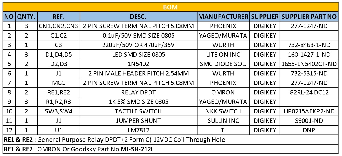

Parts List
NOQNTY.REF.DESC.MANUFACTURERSUPPLIERPART NO
13CN1,CN2,CN32 PIN SCREW TERMINAL PITCH 5.08MMPHOENIXDIGIKEY277-1247-ND
22C1,C20.1uF/50V SMD SIZE 0805YAGEO/MURATADIGIKEY
31C3220uF/50V OR 470uF/35VWURTHDIGIKEY732-8463-1-ND
43D1,D4,D5LED SMD SIZE 0805LITE ON INCDIGIKEY160-1427-1-ND
52D2,D31N5402SMC DIODE SOL.DIGIKEY1655-1N5402CT-ND
61J12 PIN MALE HEADER PITCH 2.54MMWURTHDIGIKEY732-5315-ND
71MG12 PIN SCREW TERMINAL PITCH 5.08MMPHOENIXDIGIKEY277-1247-ND
82RE1,RE2RELAY DPDTOMRONDIGIKEYG2RL-24 DC12
93R1,R2,R31K 5% SMD SIZE 0805YAGEO/MURATADIGIKEY
102SW3,SW4TACTILE SWITCHNKK SWITCHDIGIKEYHP0215AFKP2-ND
111J1JUMPER SHUNTSULLIN INCDIGIKEYS9001-ND
121U1LM7812TIDIGIKEYDNP
RE1 & RE2 : 12VDC Coil Through HoleGeneral Purpose Relay DPDT (2 Form C)
RE1 & RE2 : OMRON Or GoodskyMI-SH-212L
