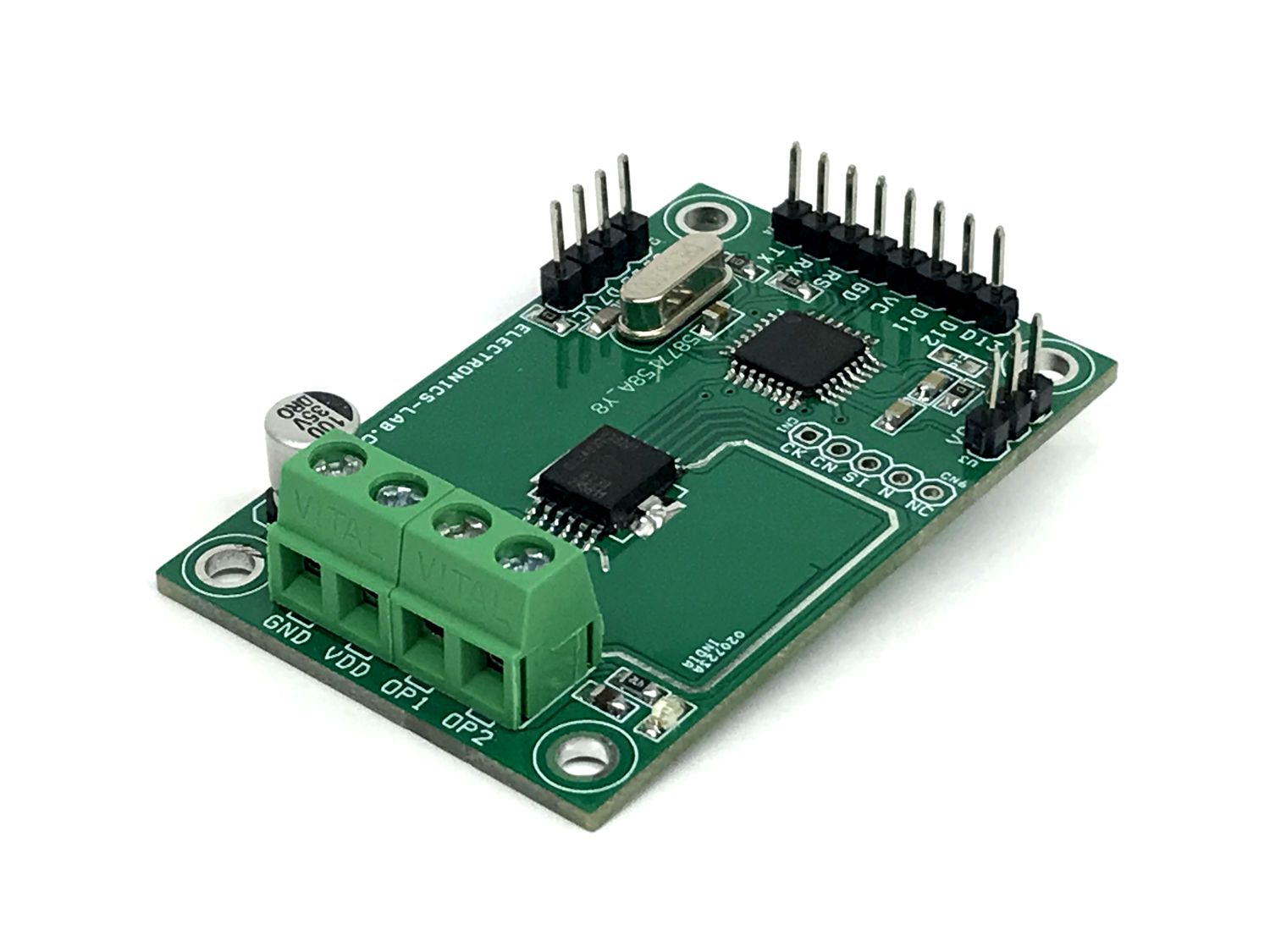

DC Motor Control Using Joystick

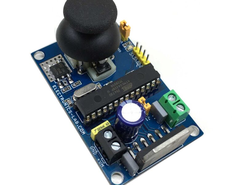

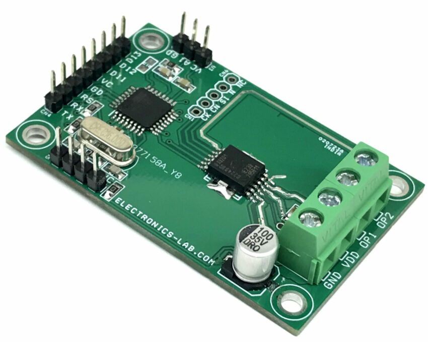

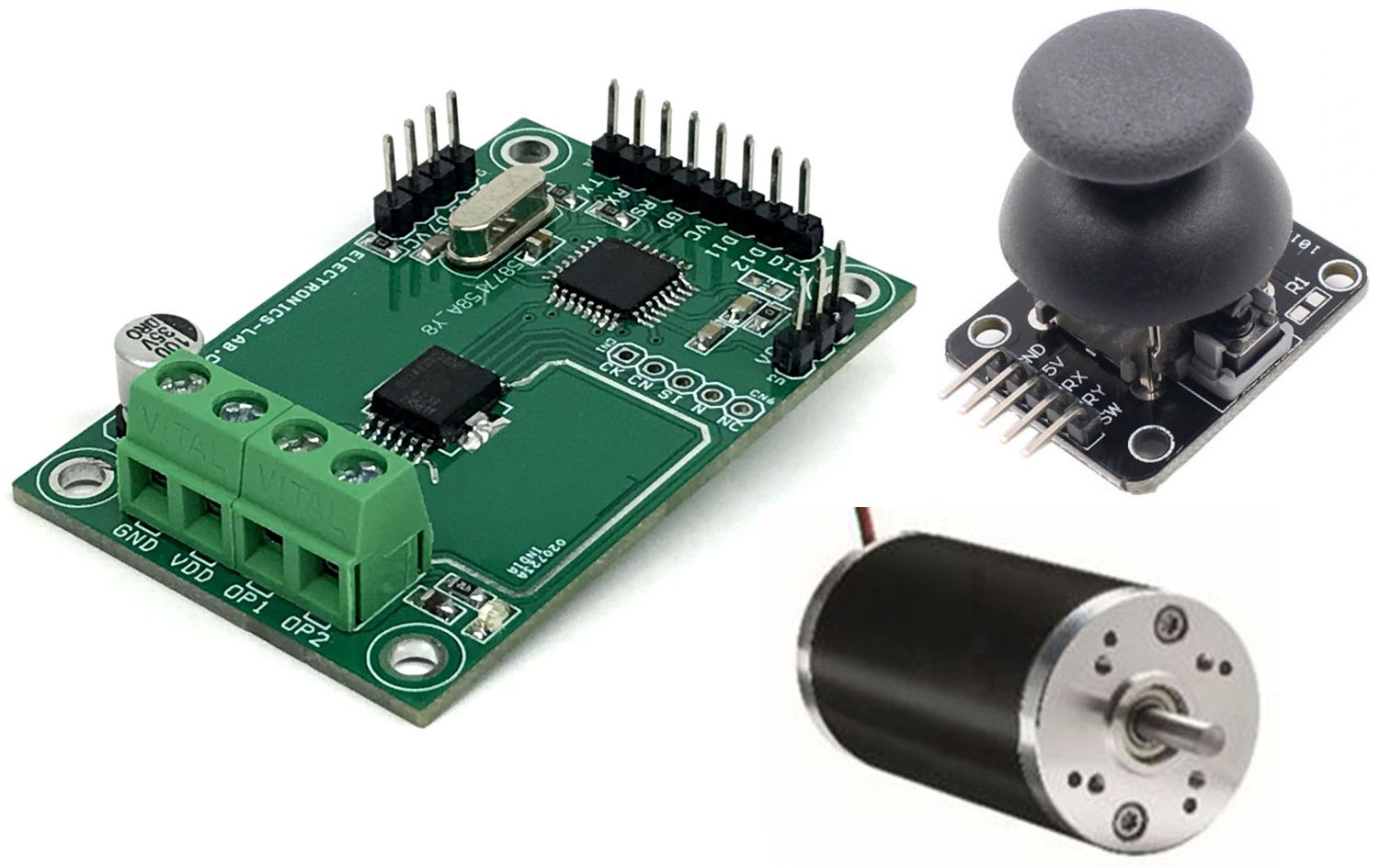

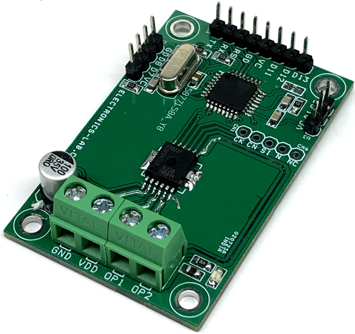

This is a compact, low-profile, and high-performance DC motor driver that provides easy control of a DC motor using a joystick. This small-size board can drive small to medium-sized brushed DC motors with up to 2.5A continuous and 6A peak currents.
This is a compact, low-profile, and high-performance DC motor driver that provides easy control of a DC motor using a joystick. This small-size board can drive small to medium-sized brushed DC motors with up to 2.5A continuous and 6A peak currents. It is an Arduino-compatible project that helps users develop their own code and drive DC brushed motor as per application requirements. The Arduino-compatible hardware consists of an ATMEGA328 microcontroller and IFX9201 H-Bridge chip.

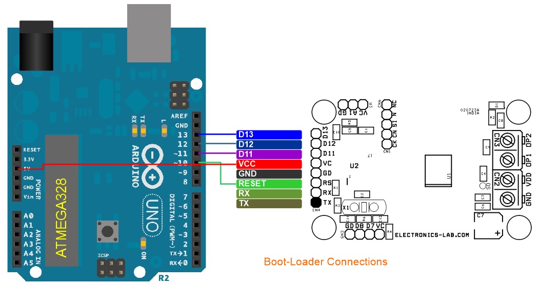

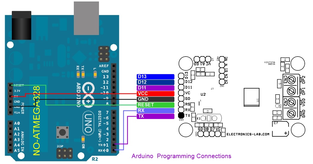

Arduino Code
Arduino example code is available and the user will be able to drive a DC brushed motor up to 2.5A using a joystick. Follow the link below to learn more about programming the new ATMEGA328 chip using Arduino IDE.

- Power Supply for the Load 8V to 30V DC (Max 36V)
- Motor Lead up to 2.5A Peak 6Amps
- Over Current Shutdown Threshold 8Amps
- Logic Supply 5.0 V
- No Heatsink Required
- PWM Frequency 975Hz
- On Board Power LED
- Screw Terminals for Motor and Power Supply Connections
- PCB Dimensions 57.47 x 37.15 mm

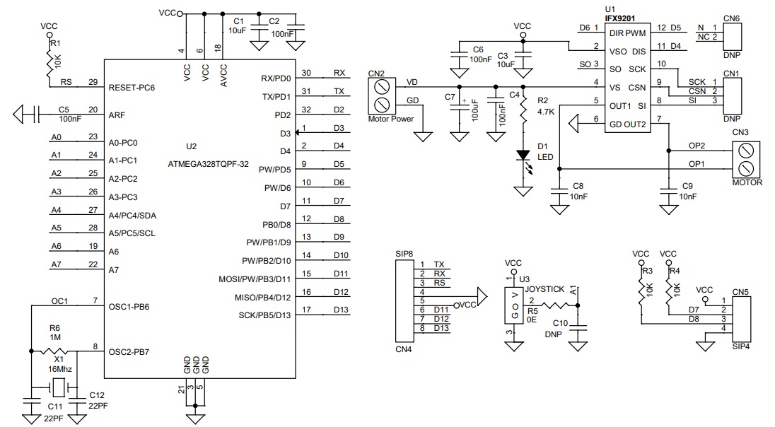

Arduino Pin
- Arduino D5 = PWM Pin of IFX9201 H-Bridge
- Arduino D6 = Direction Pin of IFX9201 H-Bridge
- Arduino D4 = Disable Pin of IFX9201 H-Bridge (High = Disable, Low = Enable)
- Arduino D5 = PWM IFX9201 H-Bridge
The project is built using an IFX9201 H-Bridge chip, more info about similar can be found here
Protection and Diagnostics – Both output stages of the IFX9201SG are equipped with fault diagnostic functions:
- Short-to-supply voltage (SCVS)
- Short to ground (SCG)
- Open load (OL)
- Over-temperature (OT)

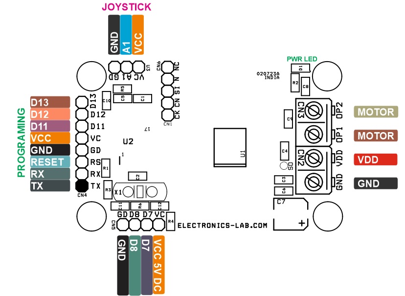

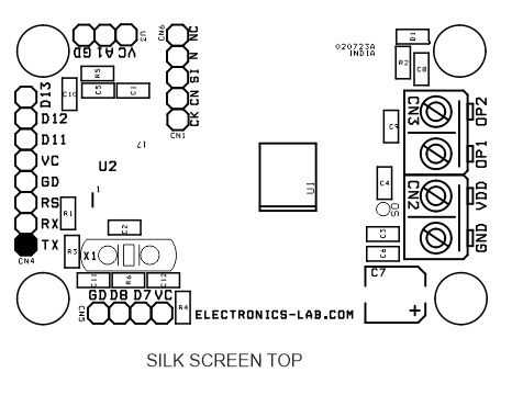

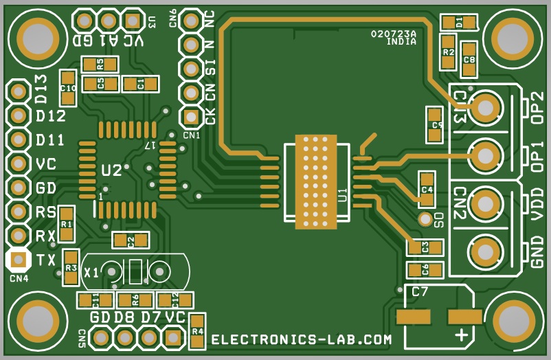

Connections and Other Details
- CN1: Optional No Use
- CN2: Power Supply for Motor Pin 1 = VDD 8 to 30V DC, Pin 2 = GND
- CN3: Motor Connections, Pin 1 = Motor, Pin 2 = Motor
- CN4: Arduino Programming/Bootloader Connector, Pin 1 = RX, Pin 2 = TX, Pin 3 = Reset, Pin 4 GND, Pin 5 = VCC, Pin 6 = D11, Pin 7 = D12, Pin 8 = 13
- CN4: Optional Limit Switch, Pin 1 = VCC, Pin 2 = Arduino D7, Pin 3 = Arduino D8, Pin 4 = GND
- U2: Joystick, Pin 1 VCC, Pin 2 = Analog A1, Pin 3 = GND
- D1: Power LED for Motor Supply

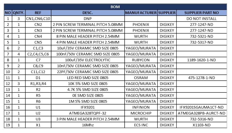

Parts List
| NO | QNTY. | REF | DESC. | MANUFACTURER | SUPPLIER | SUPPLIER PART NO | |
| 1 | 3 | CN1,CN6,C10 | DNP | DO NOT INSTALL | |||
| 2 | 1 | CN2 | 2 PIN SCREW TERMINAL PITCH 5.08MM | PHOENIX | DIGIKEY | 277-1247-ND | |
| 3 | 1 | CN3 | 2 PIN SCREW TERMINAL PITCH 5.08MM | PHOENIX | DIGIKEY | 277-1247-ND | |
| 4 | 1 | CN4 | 8 PIN MALE HEADER PITCH 2.54MM | WURTH | DIGIKEY | 732-5321-ND | |
| 5 | 1 | CN5 | 4 PIN MALE HEADER PITCH 2.54MM | WURTH | DIGIKEY | 732-5317-ND | |
| 6 | 2 | C1,C3 | 10uF/35V CERAMIC SMD SIZE 0805 | YAGEO/MURATA | DIGIKEY | ||
| 7 | 4 | C2,C4,C5,C6 | 100nF/50V CERAMIC SMD SIZE 0805 | YAGEO/MURATA | DIGIKEY | ||
| 8 | 1 | C7 | 100uF/35V ELECTROLYTIC | RUBYCON | DIGIKEY | 1189-1620-1-ND | |
| 9 | 2 | C8,C9 | 10nF/50V CERAMIC SMD SIZE 0805 | YAGEO/MURATA | DIGIKEY | ||
| 10 | 2 | C11,C12 | 22PF/50V CERAMIC SMD SIZE 0805 | YAGEO/MURATA | DIGIKEY | ||
| 11 | 1 | D1 | LED RED SMD SIZE 0805 | OSRAM | DIGIKEY | 475-1278-1-ND | |
| 12 | 3 | R1,R3,R4 | 10K 5% SMD SIZE 0805 | YAGEO/MURATA | DIGIKEY | ||
| 13 | 1 | R2 | 4.7K 5% SMD SIZE 0805 | YAGEO/MURATA | DIGIKEY | ||
| 14 | 1 | R5 | 0E SMD SIZE 0805 | YAGEO/MURATA | DIGIKEY | ||
| 15 | 1 | R6 | 1M 5% SMD SIZE 0805 | YAGEO/MURATA | DIGIKEY | ||
| 16 | 1 | U1 | IFX9201 | INFINION | DIGIKEY | IFX9201SGAUMA1CT-ND | |
| 17 | 1 | U2 | ATMEGA328TQPF-32 | MICROCHIP | DIGIKEY | ATMEGA328PB-AURCT-ND | |
| 18 | 1 | U3 | 3 PIN MALE HEADER PITCH 2.54MM | WURTH | DIGIKEY | 732-5316-ND | |
| 19 | 1 | X1 | 16Mhz | ECS INC | DIGIKEY | X1103-ND |
