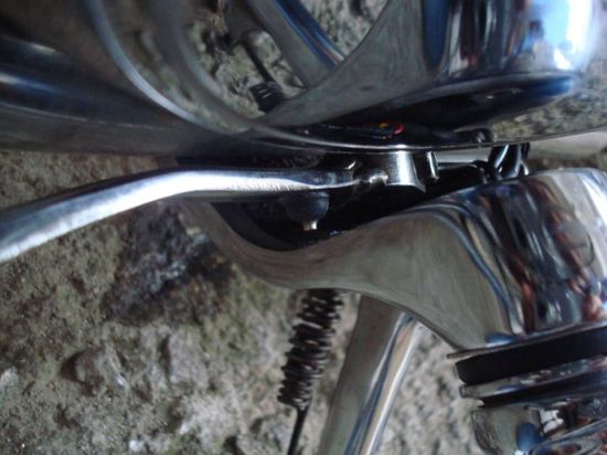

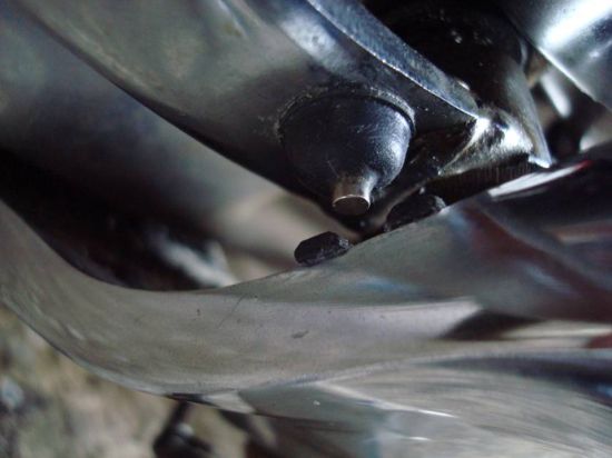

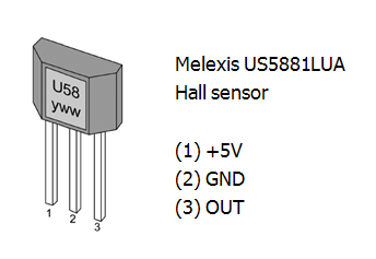

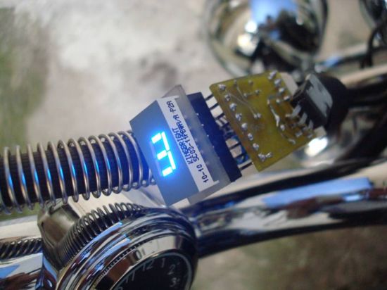

This is a new design for a universal gear indicator that can be fitted to any motorcycle as an aftermarket accessory. Its main advantage is that its operation depends entirely on the gear shift lever movement, instead of connecting to speedometer and tachometer sensors (found in expensive commercial devices), which are rarely available in older motorcycles. It consists of a main circuit including a 7‑segment LED indicator, two Hall sensors that are attached to the motorcycle frame, and a small magnet placed on the gear shift lever.
The main circuit is based on an AVR ATTINY25/45/85 microcontroller, which reads the signals of the two Hall sensors and the neutral switch and outputs the current gear number to a 7‑segment LED indicator, through a 4026 counter/decoder.

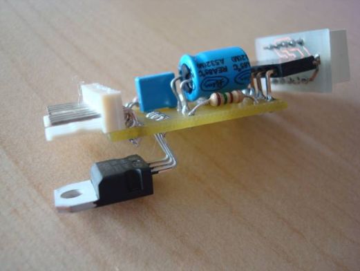

At maximum output power there is significant heat produced by IC1 and for that reason we mounted it directly on the ground plane to achieve maximum heat radiation.

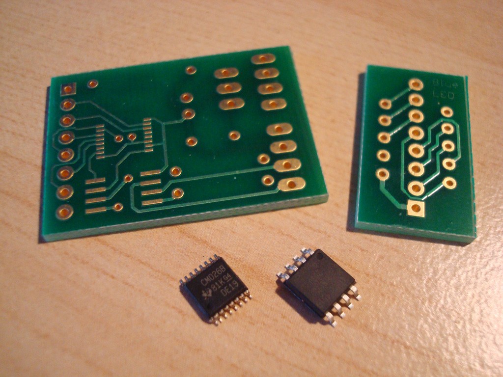

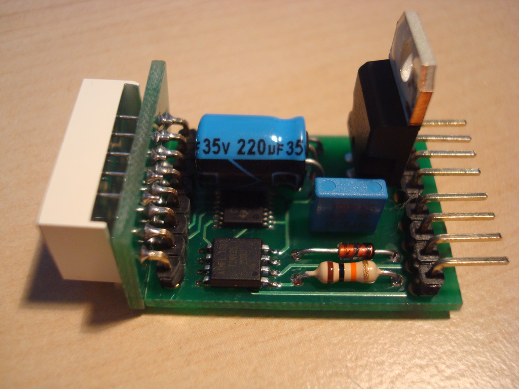

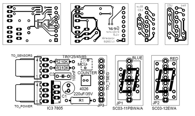

PCB Design

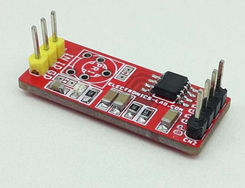

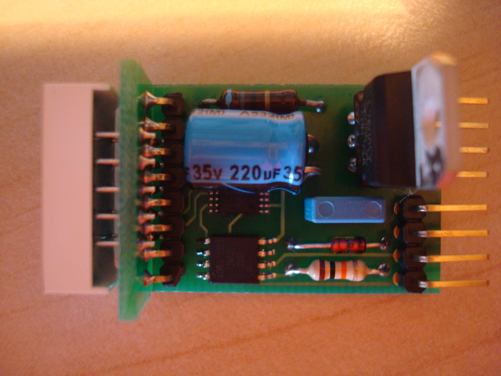

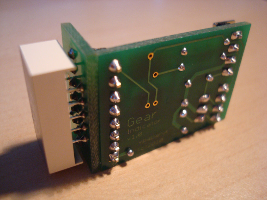

The suggested implementation for the main circuit is a small size, double-sided PCB, with SMD packages for the microcontroller and the decoder ICs. The 7-segment LED is placed in a secondary PCB, connected vertically to the main one in a modular fashion (see pictures). Two PCBs for different Kingbright LED footprints (red and blue) are also provided.
Parts List
| R1 | 10 to 220 Ω ½W | Depending on preferred LED brightness |
| R2, R3 | 10 ΚΩ ¼W | – |
| C1 | 220 μF / 35V | Electrolytic capacitor |
| C2 | 100 nF | MKT/polyester capacitor |
| MCU | ATTINY25/45/85 | Mouser Part 556-ATTINY25-20SU |
| COUNTER | 4026 | Mouser Part 595-CD4026BPWE4 |
| IC1, IC2 | Hall sensor | Melexis US5881LUA |
| IC3 | 7805 | 5V Regulator TO-220 |
| BLUE | Kingbright 0.3″ | Mouser part 604-SC03-11PBWA/A |
| RED | Kingbright 0.3″ | Mouser part 604-SC03-12EWA |
| JPx | Pin connectors | As shown in silkscreen and pictures |

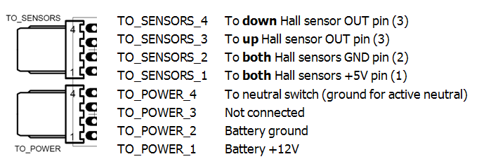

Connections

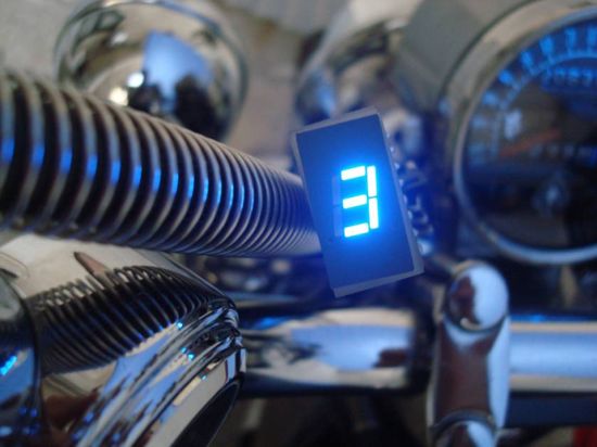

A successful circuit build will do a self-test when connected solely to 12V power (pins TO_POWER_1 and TO_POWER_2), by cycling through all digits on the 7-segment display (see video below). After the self-test, the current gear will be shown and can be changed by the shift lever movement. Note that a gear is changed when the magnet’s south pole is drawn away from the sensor (north pole will not work). Moreover, if a neutral gear is detected (from the neutral switch connected to TO_POWER_4), the display resets to zero (also acting as a self-calibrating feature if anything goes wrong). Finally, when the power is turned off, the last shown gear is stored in the MCU’s flash EEPROM and restored when the device is turned on again.
The following video shows the initialization procedure of the gear indicator :

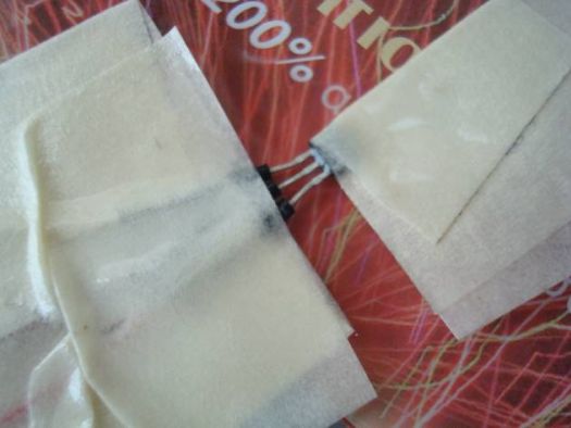

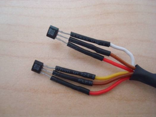

Sensor Cable
The following photos show the construction of the 4-wire sensors cable that is plugged to the TO_SENSORS connector. The visible sensor pin parts should be covered with plastic lacquer for protection as well.
After putting it all together the circuit is now operative and ready to be installed on the motorcycle. A video showing a simulation of gear shifting (by hand) is available below :

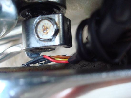

Installation Photos

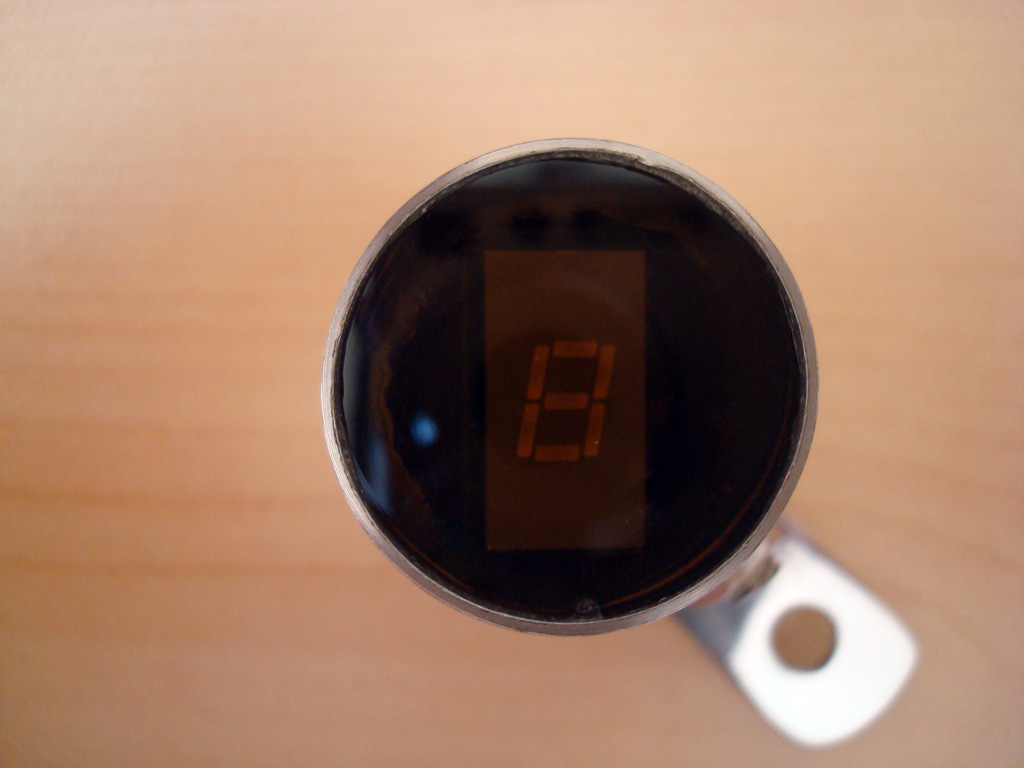

Here are some photos and videos from the installation on my Suzuki Intruder VS400

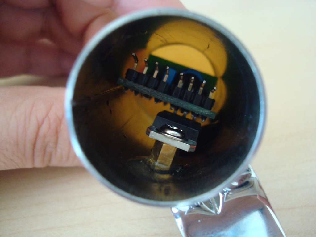

Custom Housing

The cylinder case / housing seems impressive, how did you make it?
Isn’t there a video making this?
