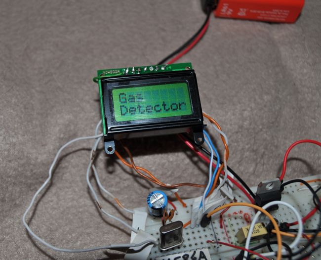

The first tests were made with the circuit mounted on a breadboard.   After initialization the circuit will enter a normal state where it detects no gas. The display shows “Sensing…No Gas !”.
Idle

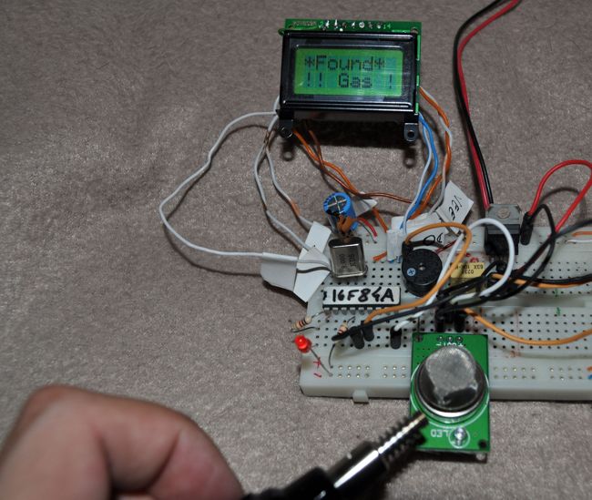

To test the sensor I used my portable gas soldering iron with the gas coming out pointed to the sensor.
The sensor is able to detect the gas and the microcontroller will trigger a flashing led warning and sound.
The sound is produced by a small piezo and the display show the message “Found Gas”.
Testing
When the air is clean again and the sensor does not sense any gas, the circuit will return to it’s normal state turning off both led and piezo sound.

Initializing
Circuit is Initializing
