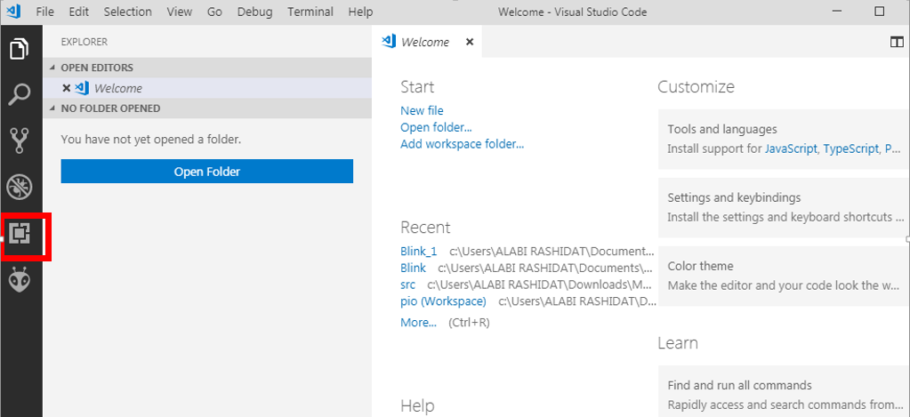

To install from the market place, launch the VScode editor. You should see a welcome page (shown below) -> click on the extension icon (highlighted in the image below) to access the market place.
Enter Arduino into the search bar and select the one that says developed by Microsoft. Click on the install button as shown below and re-launch VScode after installation completes.

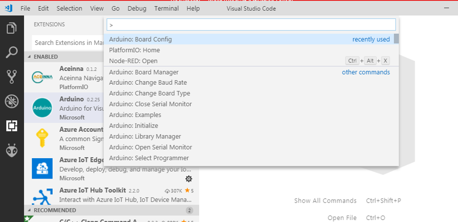

Press the F1 function key to open the command line on VScode. Once the command line becomes visible, type in Arduino. It should show you a list of commands applicable to the Arduino as shown below.
With these commands you can install new Arduino libraries, install new boards, select target board for code upload, select a programmer and pretty much everything you can do with the Arduino IDE or even more. As mentioned earlier, we will use the Arduino blink example as a demonstration. To start with, press F1 and select the “Arduino: Examples” option. Navigate and select the blink example.

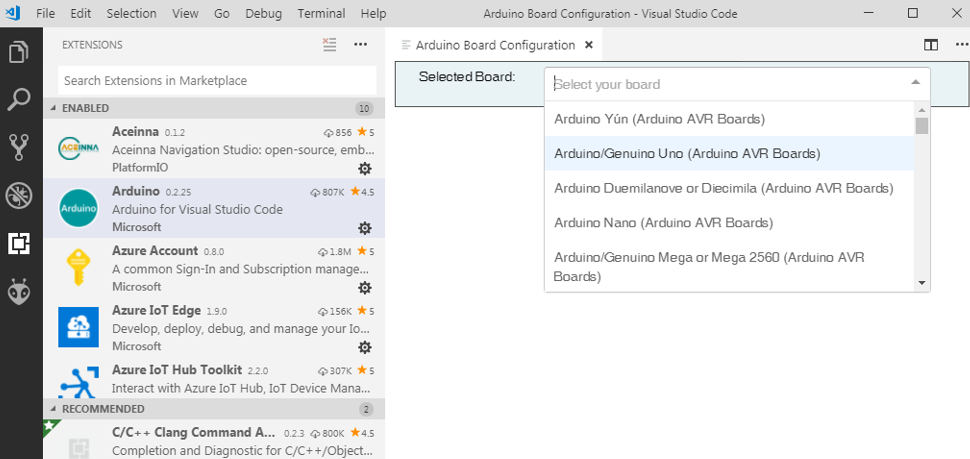

Just like when working with the Arduino IDE, press the F1 function button and select the “Arduino: Board configuration” option to set the target board which in our case, is the Arduino Uno.
Select Board Type

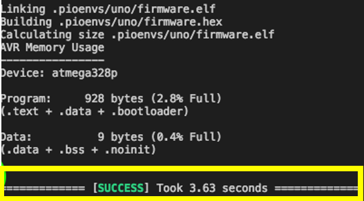

With this done, use the “Build button” on the toolbar to build your code and the “Upload button” to upload it to the target Arduino board. If the installation was properly done, you should get the success remarks on the console window.
