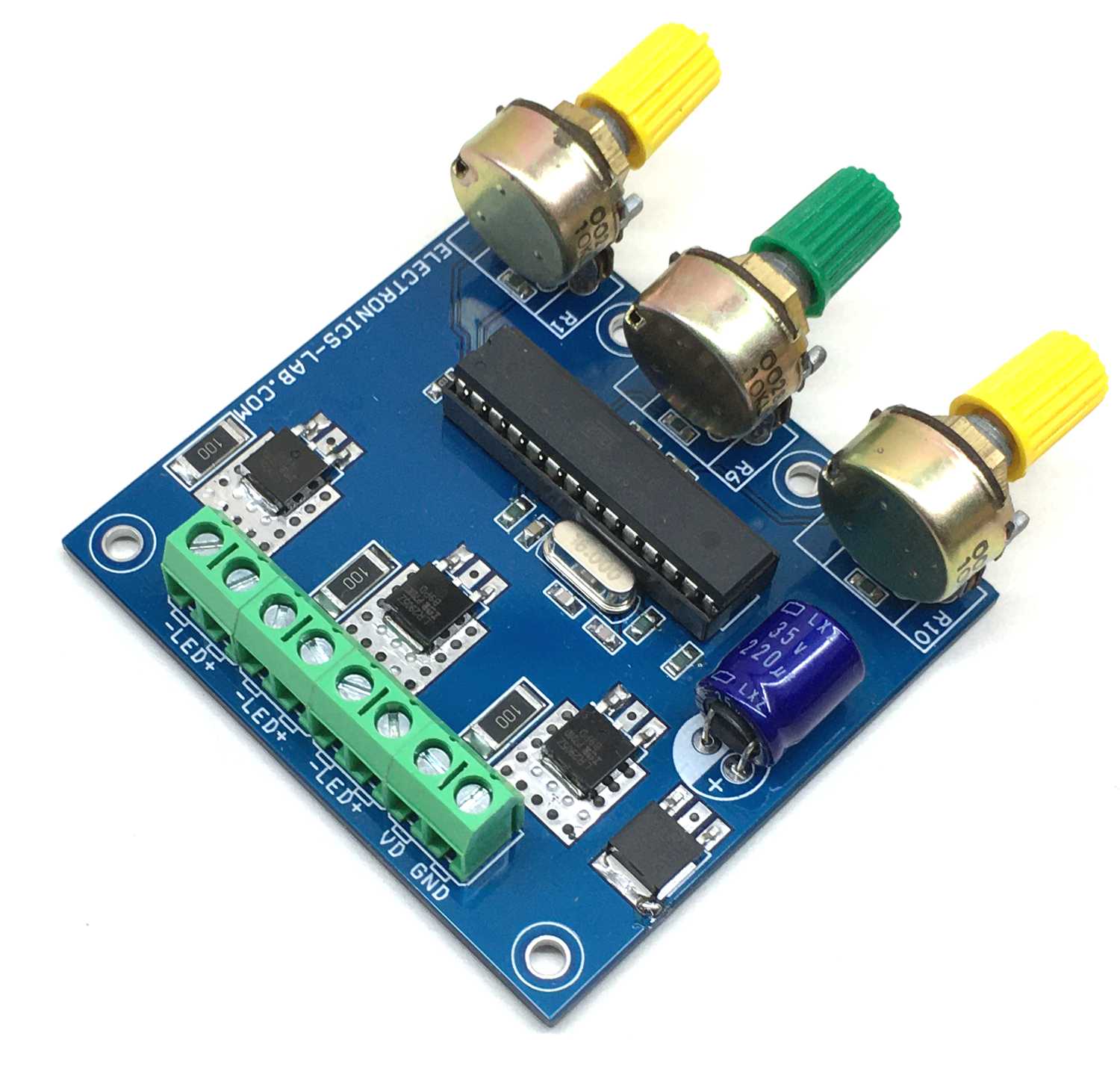

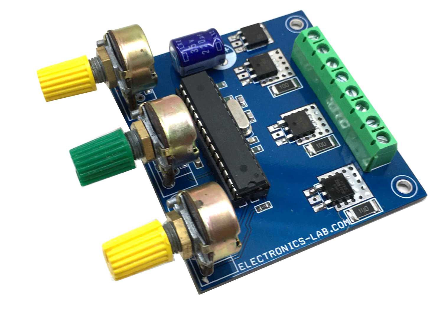

This is a 3-channel, PWM based current-adjustable LED driver designed for RGB LED control. The circuit has been designed to control high current RGB LEDs or RGB LEDs strip.
This is a 3-channel, PWM based current-adjustable LED driver designed for RGB LED control. The circuit has been designed to control high current RGB LEDs or RGB LEDs strip. Colors of the three RGB LEDs can be set using 3 potentiometers, different colors are possible by adjusting these potentiometers.
RGB LED consists of 3 separate LEDs red, green, blue packaged in a single case. The RGB LEDs can emit different colors by mixing three basic colours.

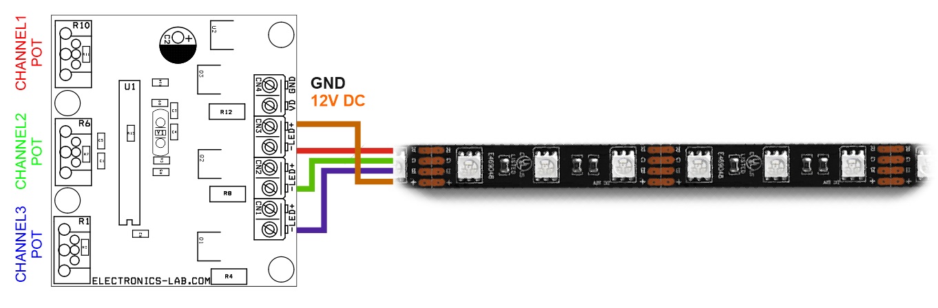

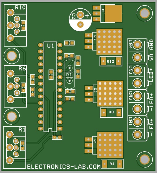

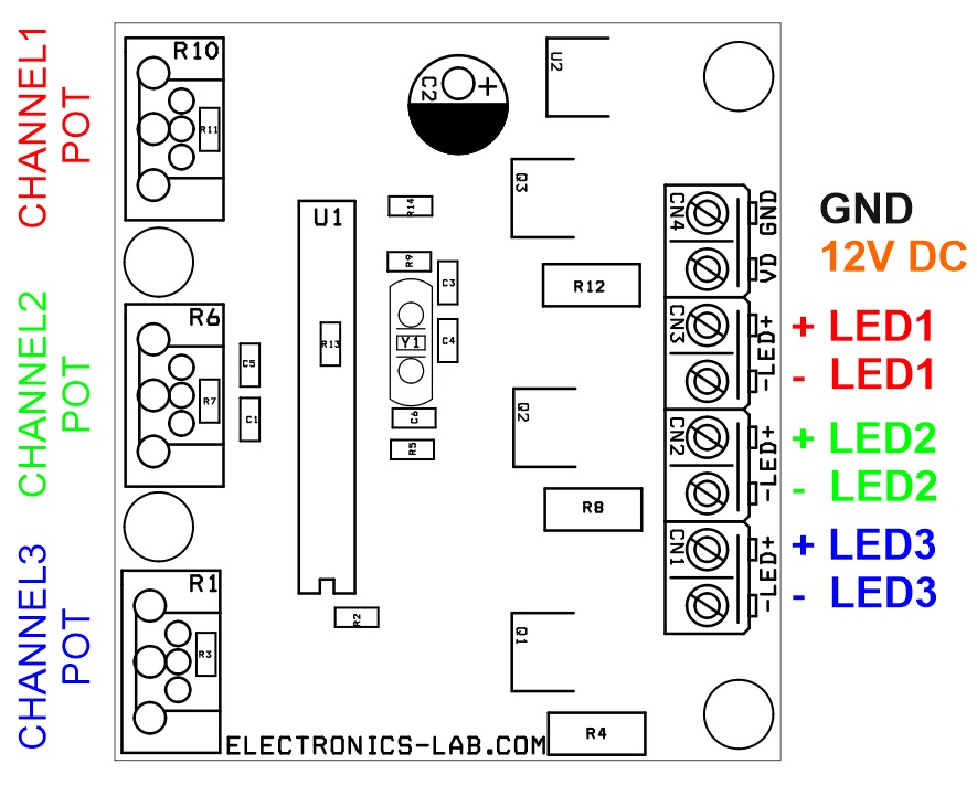

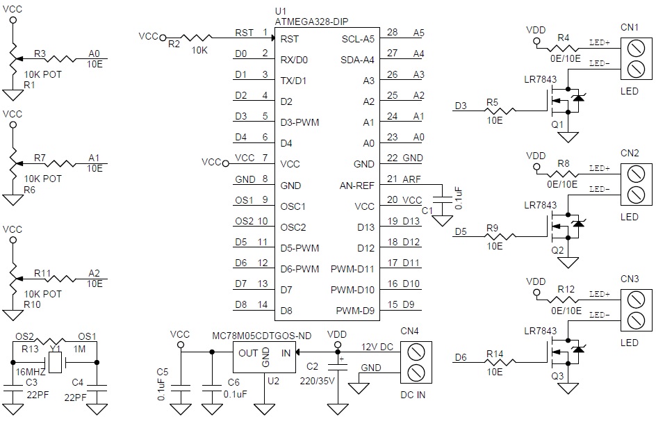

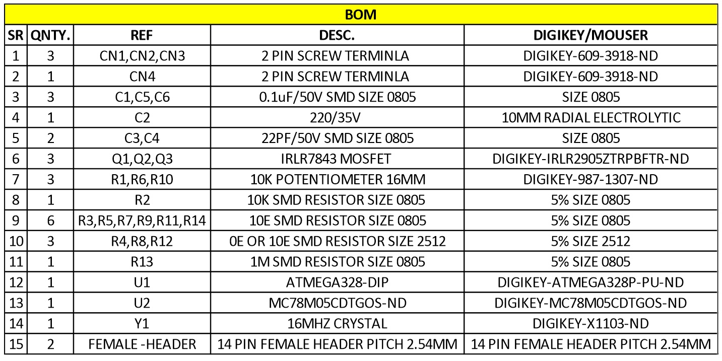

We have used ATmega328 microcontroller to generate 3 PWM signals by reading analog inputs. These analog inputs are connected to 3 potentiometers. PWM outputs interfaced with gates of 3 x IRLR7843 MOSFETs which drive the high current loads. MC78M05 IC used to power the Atmega328 chip with 5V DC. The operating voltage of this circuit is 12V DC and each channel can drive a continuous load current up to 600mA or 1 A with cool air. Screw terminals provided for an easy connection for RGB LED strip or RGB LEDs. The circuit can drive 12V RGB strip/12V RGB LEDs. Any RGB LED strip with RGB and +V connection will work with this board or use a common anode RGB LED.
This project is built using an Atmega328 microcontroller which requires programming, example code can be found below. This example code is written using Arduino IDE, thus the Atmega328 chip requires boot-loader burning and code uploading. Follow this link to learn Atmega328 Chip programming and Boot-Loader burning.
Note: RGB LED without series resistor can be interfaced with this board, in this case, calculate the series resistors R4, R8, R12 values. The default value of these resistors is 0-Ohms.

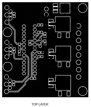

  • PCB Dimensions 61  X 67 mm

Connections

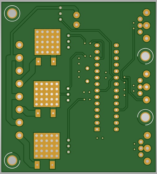

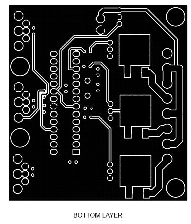

Gerber View

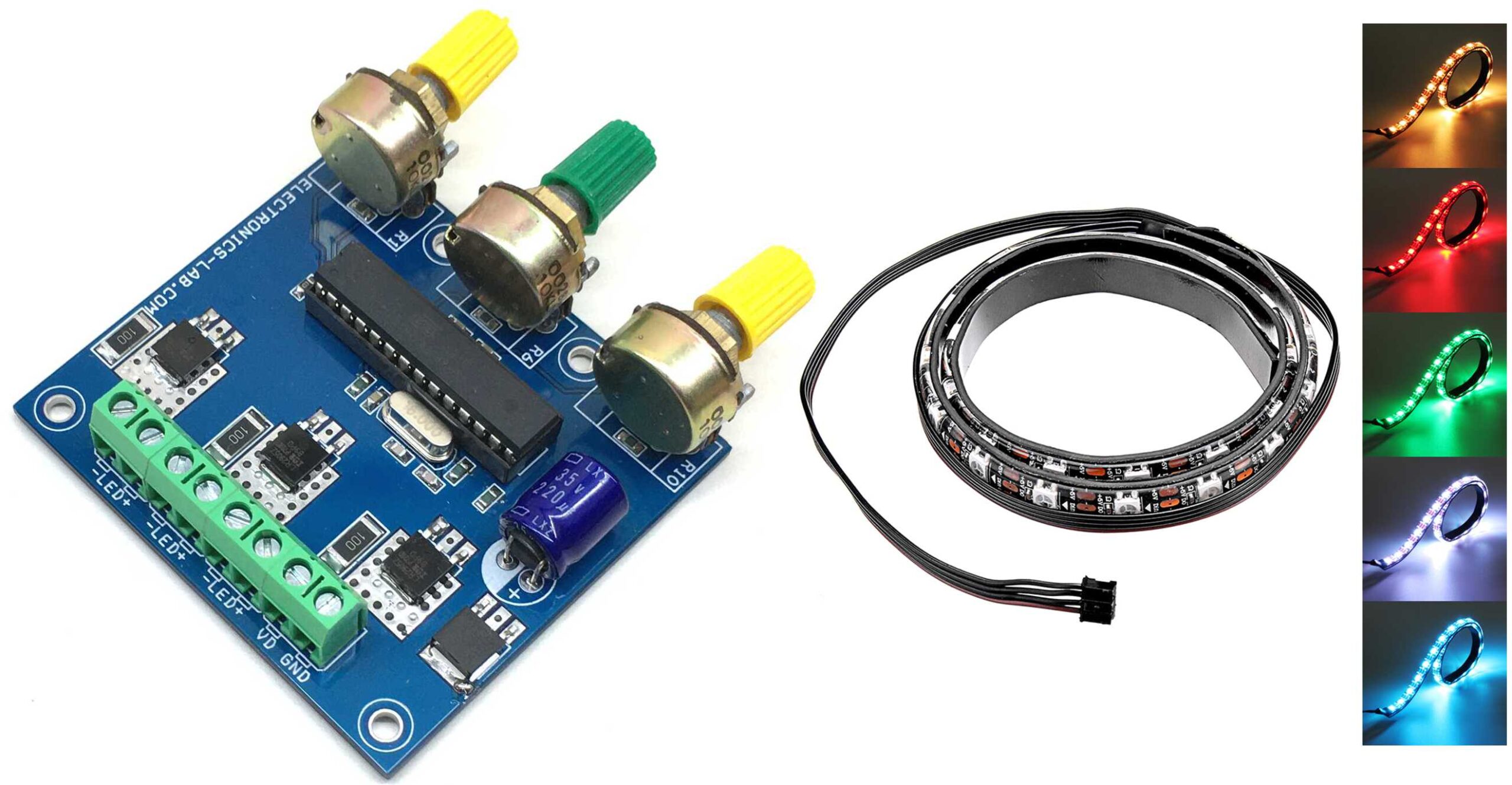

Photos
