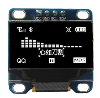

LANMU / Geekcreit 0.96" I2C - SPI 128X64 White OLED Display

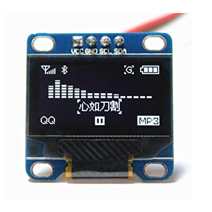

LANMU / Geekcreit 0.96″ I2C – SPI 128X64 White OLED Display

Connecting the components for this project is very easy as there are very few connections to the Arduino. The gate pin of the MOSFET is connected to pin D7 and the OLED display is connected to the I2C pins of the Arduino. A pin map of the connection between the OLED display and the Arduino is shown below;
OLED - Arduino
VCC - 5V
GND - GND
SCL - A5
SDA - A4
