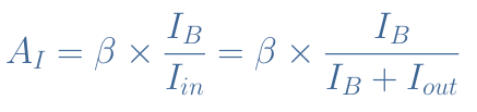

We have already seen in the previous paragraph that the current gain AI is strictly lower than one. To get the exact formula of Ai, we consider as mentioned previously that Iin=Iout+IB. Moreover, we define Iout=β×IB with β the transistor’s current gain. Notice that here IB≠Iout in contrary to the previous amplifier configurations CEA and CCA.
The output current satisfies Iout=AI×Iin=β×IB , when isolating AI, it comes :
Dividing the numerator and denominator by IB, the term Iout/IB=β appears and we get the exact expression of the current gain for a CBA configuration :
eq 1 : Expression of the current gain
As an example, a bipolar transistor of gain β=200 has a current gain AI=200/201=0.995≅1. Hence, the current gain of a CBA configuration can always be approximated by 1 without committing too much error. Since the current gain is equal to 1, the output current Iout follows the input current Iin, hence the other name commonly given to this configuration current follower/buffer.

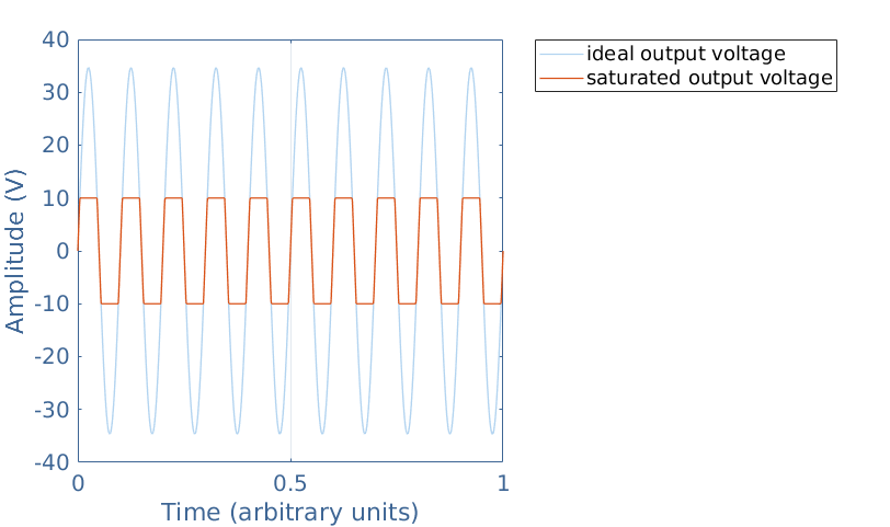

In theory, the voltage can here be amplified by a factor 34.65. However, as seen during the Introduction to Electronic Amplifiers tutorial, the output voltage is limited by the power supply votage. Therefore, the output voltage here reaches only 2×Vsupply=20 V peak to peak instead of 2×34.65=69.3 V peak to peak and a rather important saturation effect will be observed.
fig 4 : Saturated output voltage vs ideal output voltage
