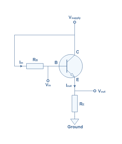

The first figure below is a simplified electric diagram with no particular biasing circuit presenting the CCA configuration :
fig 1 : CCA electric diagram
The main difference when comparing this architecture with the Common Emitter Amplifier (CEA) is that the output signals are taken on the emitter branch and the collector is always connected directly to the power supply, thus the name “Common Collector”.
It is shown further on that the voltage gain AV=Vout/Vin is approximately equal to 1. Moreover, the phase remains the same during the amplification process, the input and output signals are therefore very similar, hence the name “emitter-follower”. On the other hand, we will see that the current gain AC=Iout/Iin is high but has an upper limit.

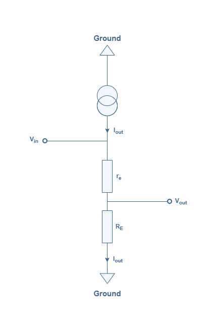

Equivalent circuit
We can consider the bipolar transistor between the collector and emitter to be an ideal current source of amplification gain β where Iout=β.Iin. It also presents a small resistance given by re=25 mV/Iout known as “AC emitter resistance” or  “small diode emitter resistance” and represents the dynamic resistance for small AC signals of the p/n junction of the bipolar transistor.
We see in Figure 2 an equivalent circuit of the CCA configuration of Figure 1 considering the transistor such as described above.
fig 2: Equivalent circuit of a CCA configuration
Voltage gain
It is easy to understand that in the configuration presented in Figure 1, the voltage gain is approximately equal to 1. Let’s indeed consider the voltage loop between the base and emitter. It comes automatically that Vin=RE.Iout=Vout and thus AV=1.
From Figure 2 we can clearly express the input voltage to be Vin=(RE+re).IE and the output voltage to be Vout=RE.IE. When expressing the voltage gain AV=Vout/Vin , the term IE disappears and we get the exact expression of the gain AV :
eq 1 : Expression of the voltage gain
From this formula, it comes that AV<1 but usually RE>>re so the approximation AV=1 is justified. Since the voltage gain is always smaller than 1, Vout<Vin : the CCA cannot provide any amplification for the voltage signal.

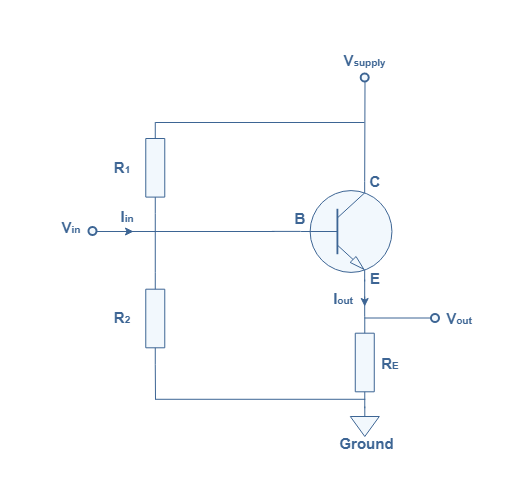

Biasing method
To provide better stability, the base of the bipolar transistor is biased with a voltage divider network such as shown in the following figure.
fig 3 : CCA with a voltage divider bias

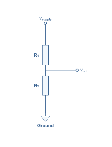

Since in a CCA configuration, Vin=Vout , the voltage divider network can be represented with a simpler equivalent circuit shown in Figure 4 :
fig 4 : Voltage network divider
Using Kirchoff’s laws or Miller’s theorem in the circuit of Figure 4, it is easy to express the output voltage :
For a faithful amplification (no distortion or saturation), the output voltage should respect the condition Vsupply=2.Vout. Thus, the bias resistances R1 and R2 should approximately be equal. However, to be more accurate, the threshold voltage between the base and emitter VBE needs to be considered. For silicon-based bipolar transistors, the threshold voltage is a constant equal to VBE=0.7 V.
The full expression of the output voltage is hence given by Equation 2 :
eq 2 : Output voltage as a function of the supply voltage
Input resistance
The CCA amplifier is characterized by a high input resistance. The expression of the base resistance RB comes from Ohm’s law : RB=Vin/Iin. We have previously seen that Vin=(RE+re).Iout, thus :
eq 3 : Expression of the base resistance
With the condition that RE>>re the final expression of the base resistance can simply be written RB=β×RE. For this reason, the transistor’s current gain β is the most important factor to set the input resistance of a CCA configuration.

Example : Voltage, Current and Power gains of Common Collector Amplifier
Having in mind the expressions and characteristics of the voltage gain, the input and output resistances, let’s consider the following circuit with a transistor gain of β=200 and determine the voltage, current and power gains.
fig 5 : Example of a CCA configuration
The output resistance is given by the emitter resistance RE in parallel with the load resistance RL :
The base resistance is given by RB=β.Rout=200×500=100 kΩ. The input resistance is thus given by the base resistance RB in parallel with the bias resistances R1 and R2 :
It can already be highlighted that Rin>>Rout such as mentioned previously. Let’s now calculate precisely the voltage gain AV. It is first considered that AV=1 so that Equation 2 is valid and therefore we can express the voltage drop across RE such as :
The current across the same resistance is thus given by IE=4.3 V/1 kΩ=4.3 mA. The small AC resistance can then be determined by re=25 mV/4.3 mA=5.8 Ω. Since RE=1 kΩ, we can confirm the hypothesis RE>>re.
Finally, the voltage gain is expressed by AV=500 Ω/505.8 Ω=0.989≅1.
In this example since R1//R2=10 kΩ<<RB=100 kΩ the approximation AC≅β is not valid and the current gain needs to be calculated with the formula AC=Iout/Iin.To compute the current gain AC, it is needed to determine the input and output currents Iin and Iout :
  • The output current is simply Iout=Vout/Rout and since Vout≅Vin , Iout=1 V/500 Ω=2 mA.
  • The input current is given by Iin=Vin/Rin=1 V/9.1 kΩ=110 μA.
Finally, the current gain is expressed by AC=2 mA/110 μA=18.2.
The power gain is given by AP=AV×AC=18. However, since RE=RL , the power given to the load is only half : AP,load=9.

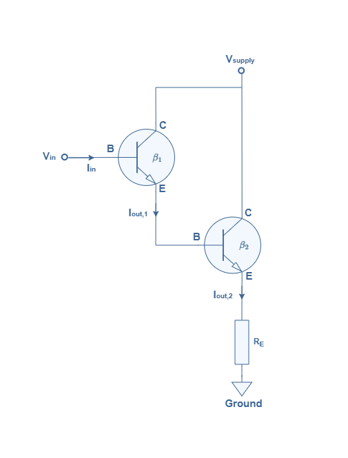

The Darlington pair
We have seen that the transistor’s current gain β is the factor limiting the total input resistance and the output current Iout=β.Iin. Indeed, if β increases, the base resistance RB=β.RE increases and therefore Rin increases as well.
A simple way to overcome that limitation without having to purchase an expensive specific high gain transistor is through the Darlington Pair (DP) presented below in Figure 6 :
fig 5 : Darlington pair
A DP consists in connecting together two bipolar transistor. The emitter of the first transistor is connected to the base of the second and both collectors are shorted to the power supply. We suppose the first transistor to have a gain β1 and the second is β2.
In this configuration, first of all, the input current is being amplified, the output of the first transistor is Iout,1=β1.Iin. This same current Iout,1 becomes afterwards the input current of the second amplifier which is a CCA configuration. The final output current is Iout,2=β2.Iout,1=β1.β2.Iin.
Finally, the total current gain of a DP is equal to Ω=β1.β2 which leads to a very high output current. Moreover, the base resistance can as well be expressed RB=Ω.RE which leads to a very high input impedance.
