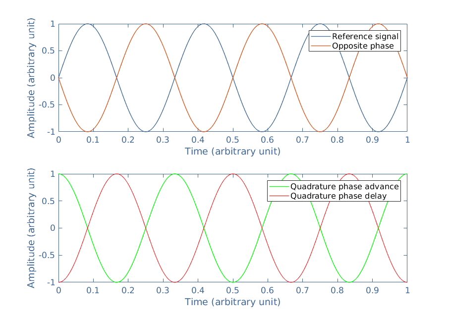

Let’s consider two sine signals that have the same frequency but different phases Φ1 and Φ2.  The phase shift φ is a constant value and it is simply defined by φ=Φ12. If we consider a reference signal of phase Φr=0°, three notable phase shifts can be highlighted as shown in Figure 1 :
fig 2 : Definition of phase opposition and quadrature. Plotted with MatLab®
An opposition phase is shifted of 180° or π rad with respect to the reference signal. Quadrature phases are shifted of +90° or +π/2 rad for the phase advance and –90° or -π/2 rad for the phase delay.

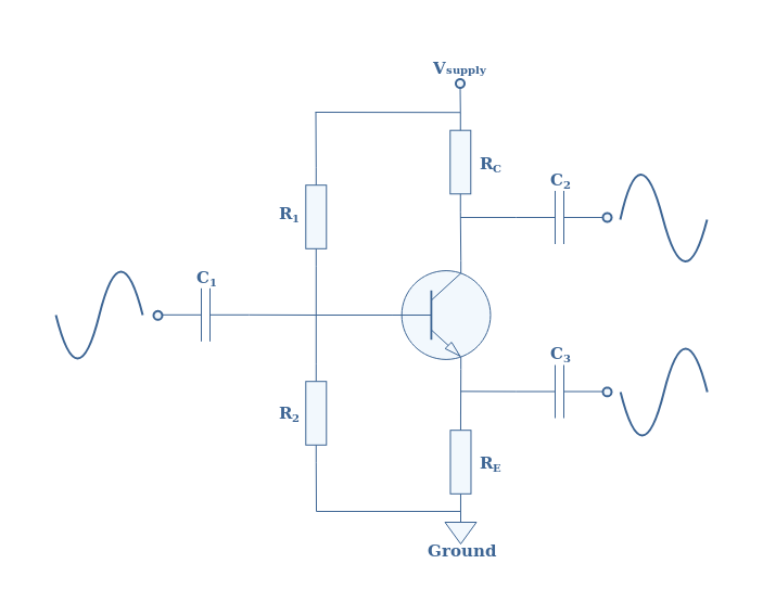

A phase inverter, that is to say a phase splitter that shifts the signals of 180° can be built with combining a common emitter and a common collector amplifiers. The architecture of the BJT-based phase splitter is shown in the Figure 3 :
fig 3 : BJT-based phase splitter
We recognize in this figure the emitter-follower structure wired to the emitter branch and the common emitter structure wired to the collector branch. Let’s analyze separately how these two architecture works, the reader should not hesitate to refer to the Common Emitter and Common Collector (emitter-follower) tutorials for the following.
Concerning the common emitter part of this design (RC and C2), the voltage gain is equal to -RC/RE. By setting RC=RE, the voltage gain becomes -1 so that the first output signal conserve the same amplitude as the input but with its phase inverted. This signal is commonly known as the inverting output.
For the emitter-follow part (RE and C3), the voltage gain is intrinsically equal to +1. The output is therefore conserving the same amplitude and phase as the input. This signal is known as the non-inverting output.

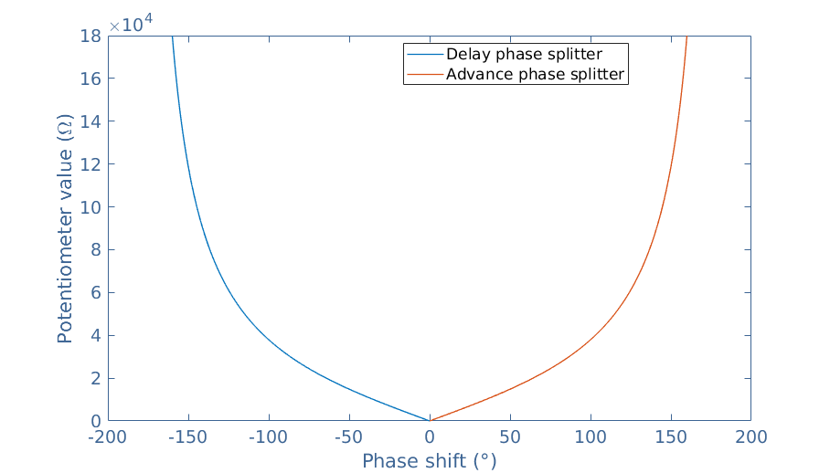

When combining the circuits of Figure 4 and 5 in cascade (in serie), a large range of phase shifts can be accessed as shown in the following graph :
fig 6 : Possible phase shift for a delay and advance phase splitter cascade. Plotted with MatLab®

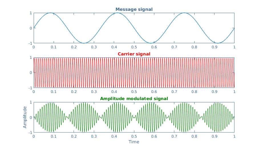

The most visual modulation technique is the amplitude modulation (AM) and represented in Figure 7. It consists in multiplying the message signal (low frequency) with a carrier signal (high frequency fc). The message is contained in the envelope of the modulated signal and can be recovered by using low-pass filters.
fig 7 : Amplitude modulation technique. Plotted with MatLab®

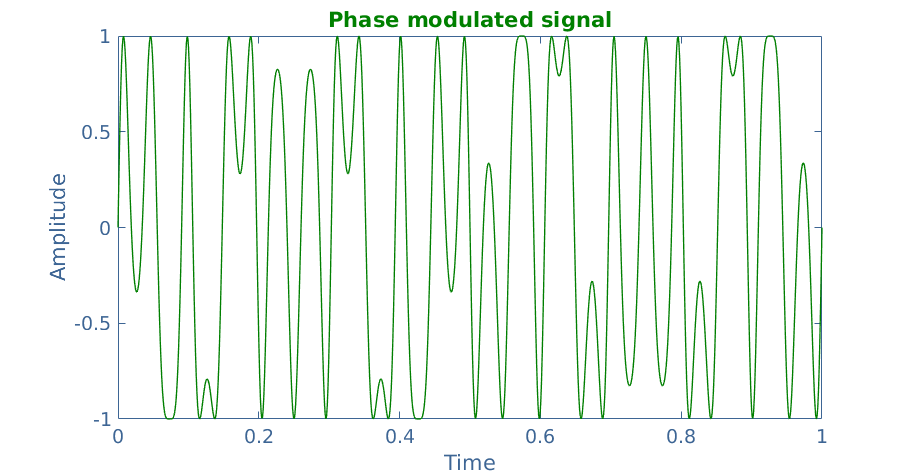

In PM technique, instead of modulating the amplitude, we modulate the phase. Unlike for the AM technique, it is not very visual and easy to estimate how the original message signal looks like by only observing the phase modulated signal :
fig 8 : Phase modulated signal. Plotted with MatLab®
