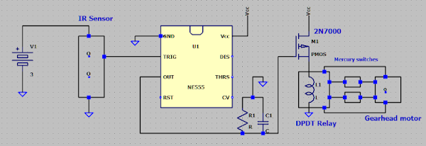

  8. Can you connect a 240v buzzer to the relay and get what you need? I don't know the circuit so I can not help much. Perhaps someone more knowledgeable will come along. I would think that the lead from the mains/transformer to the relay would be from the lead that has the fuse and power switch on it. The URL is here: https://www.electronics-lab.com/project/darkroom-timer-v2-0a-for-pcb-exposure-box/ What does this circuit do that a 60 minute egg timer could not do?
  9. The LEDs flash alternating. The flash rate is determined by C1 and R4. There are online calculators for determining these values. Just supply power for the hazard signals. Supplying power and disabling one or the other LED for the turn signal. Redraw the circuit with circuitlab and add a DPDT switch with center off perhaps for the turn signal.
  10. You should draw the fuse F1 as a blown fuse, you have a short circuit by the wire/conductor on the right. That was a test right? To see if anyone really looked at it 😉 Isn't the 7805 a voltage regulator? Not a flasher? What are the" flashers" connected to? Shouldn't they connect to the anode leads of the LEDs rather then the LEDs connecting to the Low Beam Terminal? What happens when the left and right flashers and the hazard flashers are on at the same time? Maybe okay. Could the DPDT switch be replaced with a SPST switch? Also on your SPDT there is no off position. Otherwise the schematic looks better than my poorly hand drawn schematics.

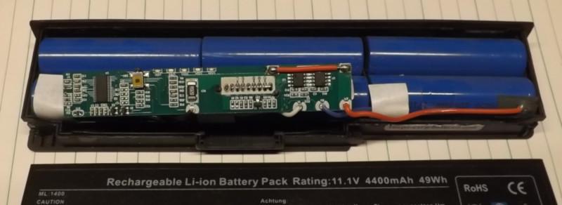

  14. For those who have not peeked in to a laptop battery the photo shows the interior of one. The battery is made up of 6 lithium ion cells of 3.7 voltages each in three pairs. Connected to each pair are connections for balanced charging. This battery does not have thermistors for monitoring temperature during charging as some do. At the upper left is a larger SMD IC that is most likely the processor or brains of the battery. To the right of the IC is a tan rectangle with a red dot on it. This is a switch that can be press through the case. It is used to display the status of the battery by the 5 LEDs just to the right of the switch at the upper edge of the PCB. There are 2 more SMD ICs at the upper right.

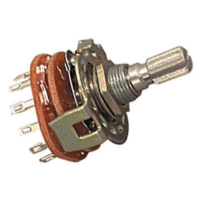

  16. There are only 6 unique numbers in each column above. If you used 4 rotary switches with one wafer each that would only require 6 * 4 = 24 contacts. A 6 position switch with one wafer:
