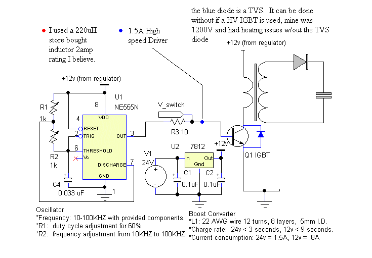

scuba14c Posted May 22, 2005 Author Report Posted May 22, 2005 The capacitors are DC. Don't they blow up when charged with AC?Could you post a schematic of how I would rectify the output using diodes?When something like this is charging, what should I expect for a charge time? Quote

scuba14c Posted May 22, 2005 Author Report Posted May 22, 2005 You lost me on the last post. Is the schematic you posted all I need to assemble to charge? If so I can get this done after school tomorrow and report back. Would it work if I just touched the battery to the transformer once a second, or do I need an electronically controlled switch to do this? Quote
Guest Alun Posted May 22, 2005 Report Posted May 22, 2005 No, it's just the output stage, the switch is the transistor in your circuit. Quote
scuba14c Posted May 23, 2005 Author Report Posted May 23, 2005 I set it up without using a switch, and two 6V lantern batteries and it gave me about 25V off of a salvaged transformer. I'm not sure what the winding ratio is, but plan to make my own. The only problem I noticed was that it would lose voltage very quickly. The capacitor that I was using was a photoflash, 330V. I'm not sure if this was because the capacitor was low quality, but I did have an ultrafast diode connected to it. Can a transformer be wound on any type of ferrite core? Is there any way to electronically activate the batteries so I don't have to manually switch the power? Quote
Guest Alun Posted May 23, 2005 Report Posted May 23, 2005 Just replace the "switch" in Edward's circuit with the transistor in your 555 circuit. Quote
Guest Alun Posted May 23, 2005 Report Posted May 23, 2005 Alright on second thoughts I'll show you: Quote
scuba14c Posted May 23, 2005 Author Report Posted May 23, 2005 Okay, that's kind of what I thought I needed to do. I will test it tomorrow and get back to you. Quote
scuba14c Posted May 24, 2005 Author Report Posted May 24, 2005 I tried to wind a transformer, but it didn't work. I used a square ferrite block and wound 1 turn of 24-26 AWG wire on one side and 32 turns on another. What am I doing wrong? Quote
audioguru Posted May 24, 2005 Report Posted May 24, 2005 A single turn of wire doesn't make much magnetism or pickup much in the core unless it is carrying many hundreds or thousands of amps, or unless it is used for low impedance, low level very high frequency circuits like the tiny balun transformer in a 75 ohm TV cable splitter box.Ferrite is good only for high frequencies.Try it again with 32 turns on both sides. If the coupling is good and the unloaded transformer doesn't use too much current, try 1000 turns on one side. ;D Quote

Guest Alun Posted May 27, 2005 Report Posted May 27, 2005 Higher voltages will make the capacitors charge up to a higher voltage and higher current sources will make it charge faster.Microwave transformers connected are very dangerous don't use them unless you know what you're doing as the output voltage and current is more than enough to kill, in fact it's a lot more dangerous than the mains.Using a microwave transformer in this project is a bit safer, but still dangerous as a 12V pulse can still create a back emf of hundereds of volts on the primary which can be steped up to >5kV.If you really want to use a microwave transformer in this project connect the mains side to the output transistor but don't blame me if anything bad happens.A DC mains adaptor transformer is perfect for this, cut it open and remove the transformer, connect the low voltage side to the output transistor and the mains side to the diode and capacitors, if the voltage is too low then try swapping the connections on either the low voltage or high voltage side.Be warned though big capacitors charged to high voltages can kill you and be carefull the voltage doesn't exceed the maximum rating of the capacitors or the will explode. Quote
