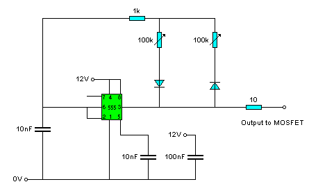

Guest Alun Posted June 3, 2005 Report Posted June 3, 2005 I've located the data sheets for you: MJE13007IRFP450 IRG4PH50KFirstly have you connect the connections to the right pins?The problem with the MJE12007 was base series resistor (R3) is too small, 10ohms is fine for a MOSFET or IGBT but not for a bjt as the base will act as a short to ground. I recommend you keep the 10ohm resistor and go with the MOSFET.You are currently only varing the frequency at the moment, try using this circuit to alter both the frequency and duty cycle:Also connect a big juicy 1000uF capacitor in paralel with the whole circuit. Quote

scuba14c Posted June 4, 2005 Author Report Posted June 4, 2005 Is there a way to change the 100k resistors to lower values? The most I have are 20k power resistors. I am connecting the 555 timer output (+) to the back of the transistor and the (-) to the left pin. The center pin is connected to the output side of the inductor. The right pin is connected to the negative terminal of the capacitor. To start it I give it a pulse with the timer and then touch the negative side of the battery to the right pin of the transistor. This will get me to ~28V in less than a second, but it takes 10 seconds longer for it to reach the 32V maximum.Is this the way it should be connected? Quote

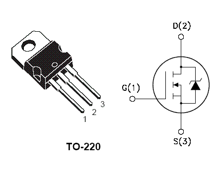

Guest Alun Posted June 4, 2005 Report Posted June 4, 2005 Is there a way to change the 100k resistors to lower values? The most I have are 20k power resistors.You don't need power resistors, two low power 100K potentiometers (variable resistors) are what you need. I am connecting the 555 timer output (+) to the back of the transistor and the (-) to the left pin. The center pin is connected to the output side of the inductor. The right pin is connected to the negative terminal of the capacitor. To start it I give it a pulse with the timer and then touch the negative side of the battery to the right pin of the transistor. This will get me to ~28V in less than a second, but it takes 10 seconds longer for it to reach the 32V maximum.Is this the way it should be connected?Look at the picture below:Pin 1 to the output from the 555.Pin 2 to the transformer.pin 3 to 0V.Connect the other end of the transformer to +V.All the connections to the transformer I've talked about in this post involve the low voltage side of the transformer.I hope this helps. Quote

Guest Alun Posted June 5, 2005 Report Posted June 5, 2005 I tried it but it didn't work. Was the ground from the timer supposed to go to the back of the transistor? What do you mean the back of the transistor?Source, Gate, Drain?Do you mean the metal tab as it's connected to the drain as is pin 2.I have a circuit layout from someone else who built a boost converter, but am unsure of one of the components he used. The diagram for the boost converter does not show it. Could you identify the device on the upperleft hand side of the board?It could be a transistor or a voltage regulator but I can't tell without the part number.Did you use stripboard this time, because connecting the components together with wires isn't the most reliable construction technique. Quote
