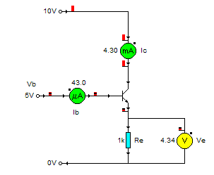

I think you're jumping in at the deep end here a bit, at this stage all you need is simple ohm's law and nothing more.
I know the following is a bad design but it's a model good for understanding things.
In the following simulation, Tr1 has a gain of exactly 100 and a Vb of exactly 664mV (the default transistor model)
We want the voltage across Rc to be half the supply voltage for maximum swing so:
Vc = VRc = 1/2 +V = 10 * 1/2 = 5V.
In order for Rc to have a voltage drop of 5V the current though it needs to be:
V/R = 5 / 1k = 5mA.
Tr1 has a gain of 100 so the current going into the bas needs to be 100th of the current though the collector so Rb needs to limit Ib to:
5mA /100 = 50uA.
Vb = 664mV so the potential differance across it is:
Vb = 10 - 0.664 = 9.336V
At 9.336V the resitor value to pass 50uA = V/I = 9.336 / 50uA = 186.72k, which is rounded to 187k on the schematic.
You'll see that if you use these formulae with componants having exactly the right characteristics then the voltages all round the circuit can be calculated exactly but as you know in practise this isn't true.
Do you understand all of the above calculations? Because you can't move on to the other circuits until you can grasp the fundermentals.

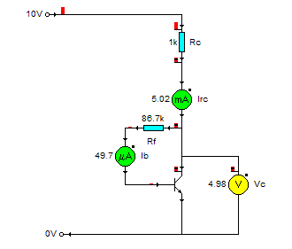

No Walid, this is self bias and the formulea isn't too differant from before:
Full full swing we need:
Vc = 5V
So we want Irc to equal 5mA and to do this the base curent needs to be:
IRf = Irc / 100 = 5mA / 100 = 50uA.
The voltage across Rf is:
VRf = Vc - Vb = 5 - 664mV = 4.336V.
So for 50uA to flow is value should be:
IRf = VRf / Ib = 4.336 / 50uA = 86.72k.
Now you'll see that there's some error here, this is because Ic isn't exactly IRc as some of the current goes though to the base. We could calculate the exact value for Rf using simultanious equations but why should we bother as it's only an error of 2mV and the transistor's gain will vary a lot and introduce a greater error than this?
This is often used with an input resistor to intorduce negitive feedback and even though the distortion is quite high compared with common emitter amplifier with large amounts of negitve feedback the output impedance is a lot lower.
About your other comments, all will be explaind later when I explain the emitter follower and then add the other resistors. I think we really need to teach people step by step as all of the articles I've read rush into things far too quickly.
I'm off to bed shortly so you'll have to wait untill tomorrow.

So let's look at the emitter follower.
When Vb is applied to the base the transistor turns on causing a current to flow through Re.
This causes a potential difference proportional to the current to form across Re until Ve is 0.66V lower than the base because it can't rise any higher as the base is a diode. This is known negative feedback, a signal enters the base, the emitter voltage rises in turn cancelling out the change that would normally occur in the other common emitter amplifier without Re I posted previously.
Now Ib is always 1/100 of Ic as the transistor has an amplification factor of 100 and as the collector current is dependant on Re the impedance at the base is 100 times larger than the impedance of Re.
In the previous examples I did the calculations for you, I still have, you have the answers in the simulation below, but I didn't show you how I got those figures. Try doing you own calculating to see for your self, experiment with different gains and values of Re.
By no you should beable to see that the base impedance is directly proportional to the gain of the transistor. For this reason the current in the potential divider needs to be significanty higher than the base current as the latter can be highly variable and affect the voltage in the potential divider. Don't forget we want to bais the transistor so it's gain has as smaller affect on the circuits behaviour as possible.
