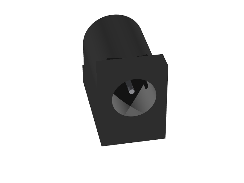

gogo2520 Posted February 22, 2006 Report Posted February 22, 2006 Not bad I dl it and got it running in less then 2 hours. This is what i got out. It dosn't do push buttons yet. have gogo Quote

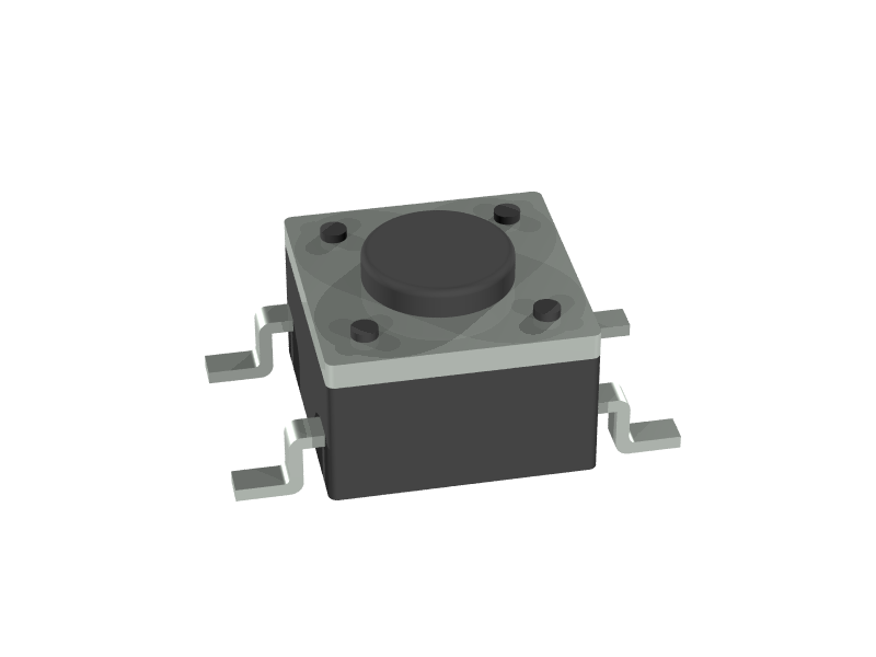

gogo2520 Posted February 23, 2006 Report Posted February 23, 2006 Nice Job GreekPic What package did you use for the push buttons. I couldn't get mine to work.I think I loaded the librarys in the wrong directory. Thanks gogo Quote

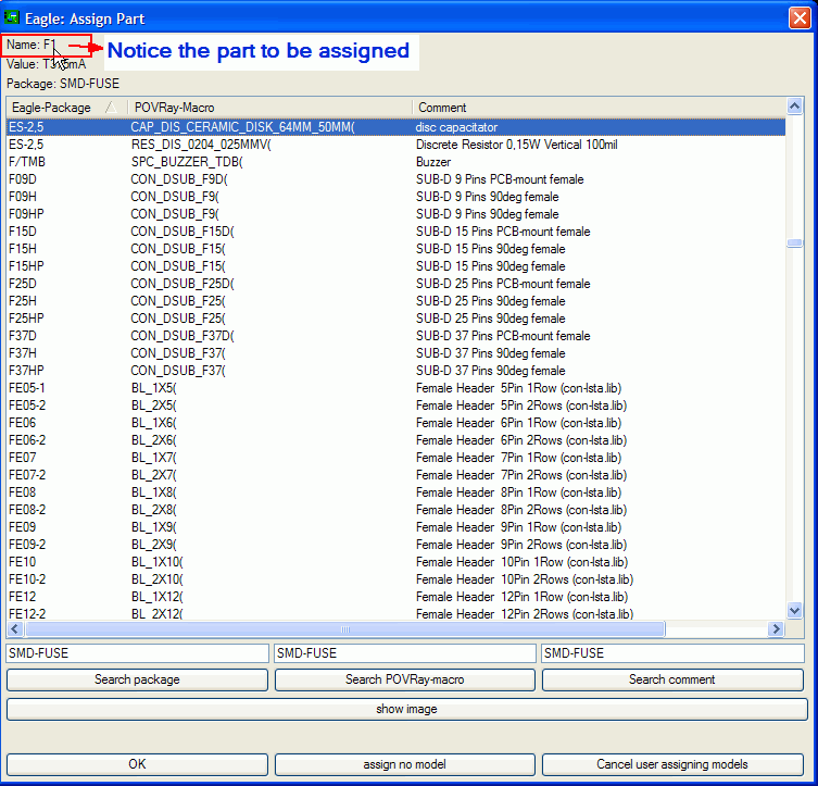

Guest Kasamiko Posted February 23, 2006 Report Posted February 23, 2006 OK..heres what I done so far..Form this:To this..WOW!!![img width=680 height=510]I did it!!rhonn ;) ;) Quote

Guest Kasamiko Posted February 23, 2006 Report Posted February 23, 2006 @gogo2520I think it's the SWITCH_PUSH_BUTTON_LSH43Yet another one..rhonn ;) ;) Quote
gogo2520 Posted February 23, 2006 Report Posted February 23, 2006 Cool thanks. Did you dl the librarys and if you did where did you install them. Also the dc input jack I can't even find that in egale so I dl'd of the site. gogo Quote

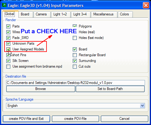

Guest Kasamiko Posted February 24, 2006 Report Posted February 24, 2006 Here's the trick I used..I don't know if this is the proper way of doing it :PBefore creating the POV File check this: Quote

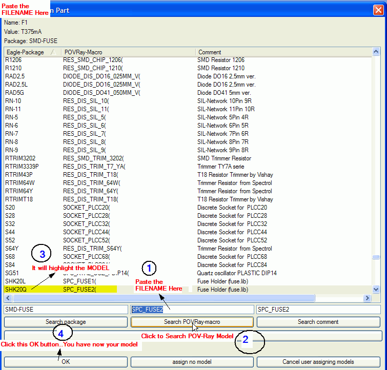

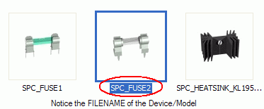

Guest Kasamiko Posted February 24, 2006 Report Posted February 24, 2006 Search for the MODEL in your POV-Ray Gallery..you can extract it anywhere.. Quote
Guest Kasamiko Posted February 24, 2006 Report Posted February 24, 2006 @gogo2520Maybe this is what you mean?FILENAME: DCPOWERCONNECTOR Quote

FH16 Posted February 28, 2006 Author Report Posted February 28, 2006 Nice Job GreekPic What package did you use for the push buttons. I couldn't get mine to work.I think I loaded the librarys in the wrong directory. Thanks gogoI'm UsingLibrary: switch-omronDevice: 10-XXPacage: B3F-10XX Quote
