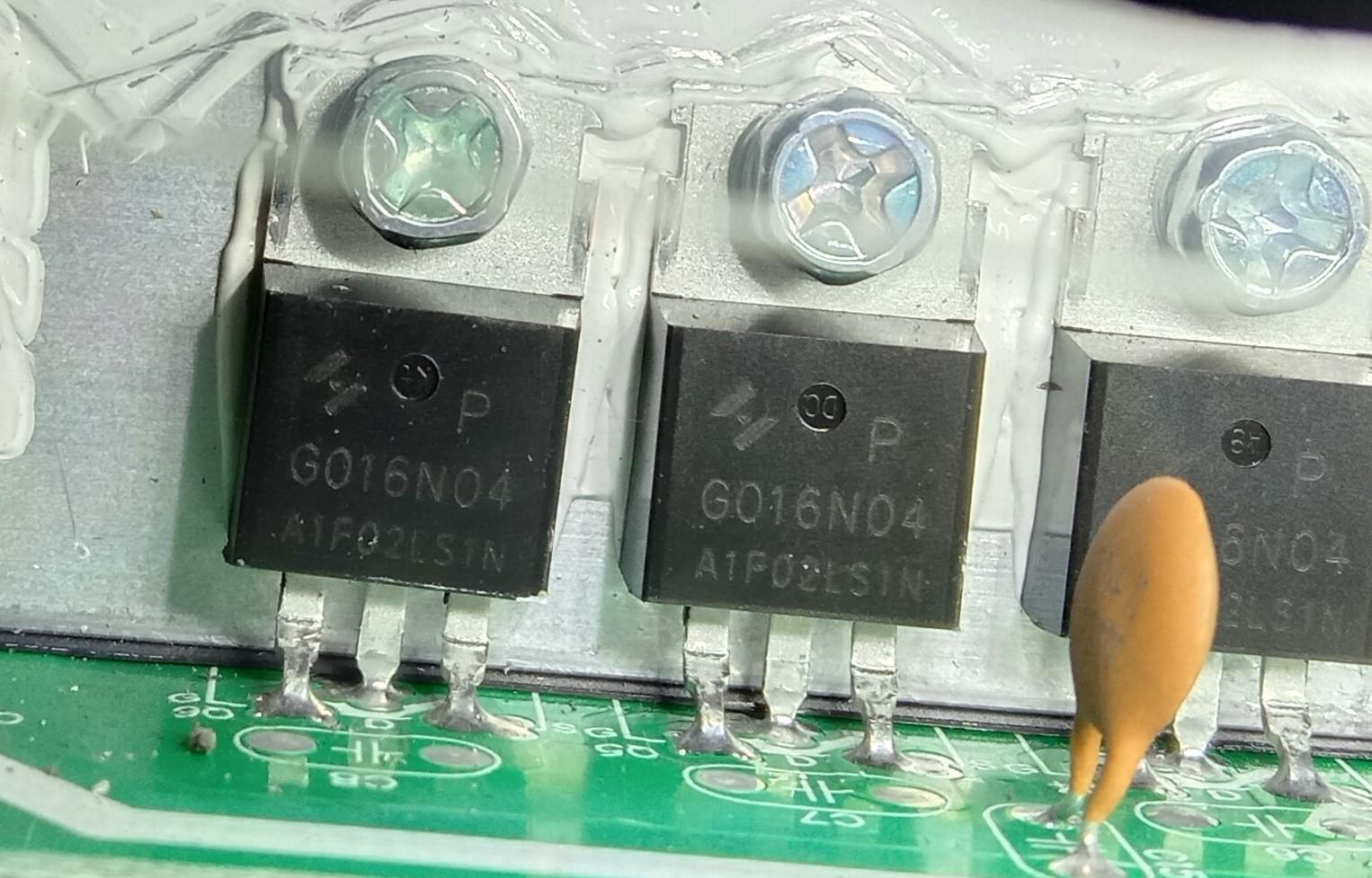

Hi I was hoping someone can help me? I’ve been trying to identify this MOSFET. I have a few blown ones on a 12 volt to 240 volt 3000 watt inverter/charger (Renogy) brand. Searched all the codes on the net, can’t come up with anything. Perhaps you can help with an equivalent mosfet? I suspect this may be some kind of proprietary build, so some of the numbers may mean something to someone out there?

The Mos is available as is, search for the data sheet :
HYG016N04LS1P/B
Specs are on the sheet of course, there are many substitutes that are available manufacturer from my original post is HUAYI
I ended up using Matsuki ME66N04T
also; PTP03N04N Perfect Intelligent Power Semiconductor Co package TO-220 will do the job.
