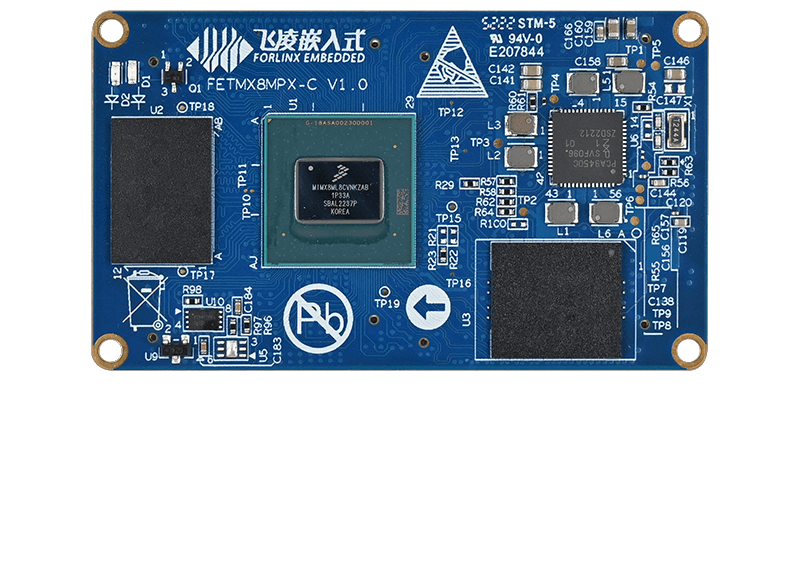

FETMX8MPL-C SoM dimensions
FETMX8MP-C System on Module specifications:
  • Processor
    • CPU:
      • FETMX8MPQ-C: NXP i.MX8M Plus Quad (Quad-Core Cortex-A53, Single-Core Cortex-M7)
      • FETMX8MPL-C: NXP i.MX8M Plus QuadLite (Quad-Core Cortex-A53, Single-Core Cortex-M7)
    • Frequency: 1.6GHz (Cortex-A53) + 800MHz (Cortex-M7)
  • Memory & Storage:
    • RAM:
      • FETMX8MPQ-C: 1GB/2GB/4GB LPDDR4
      • FETMX8MPL-C: 1GB/2GB LPDDR4
    • ROM: 8GB/16GB eMMC
  • Graphics & Multimedia
    • GPU: Vivante GC7000UL (3D) and GC520L (2D) with support for OpenGL, OpenCL, Vulkan
    • NPU:
      • FETMX8MPQ-C: 2.3 TOPS
      • FETMX8MPL-C: Not supported
    • Video Decoding:
      • Resolution: 1080p60
      • Formats: VP8, VP9, H.264, H.265 (FETMX8MPQ-C only)
    • Video Encoding:
      • Formats: H.264, H.265 (FETMX8MPQ-C only)
  • Interface Mode: Ultra-thin board-to-board connector (4 x 80-pin, 0.5mm pitch)
  • Power supply: 5V in via connector
  • Dimensions: 62mm x 36mm, 1.6mm thickness, 8-layer ENIG PCB
  • Operating Temperature: -40°C to +85°C

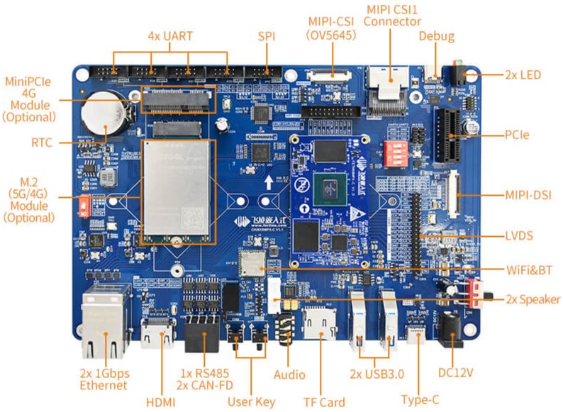

OKMX8MP-C i.MX 8M Plus SBC specifications
To support evaluation, Forlinx offers the OKMX8MP-C Development Board, which utilizes the computing and multimedia capabilities of the i.MX 8M Plus processor. The board includes dual Gigabit Ethernet ports (one with TSN support), integrated WiFi/BT, and expansion options via M.2 B-key and mini-PCIe sockets, with optional support for 5G and 4G modules. Previously, we covered i.MX 8M Plus-based SBCs, including the IBASE RM-N8MPL, AAEON SRG-IMX8PL, PICO-IMX8PL, DEBIX Infinity, iWave iW-RainboW-G40M, and others. Feel free to explore these products if you’re interested.
The module supports the Linux 5.4.70 operating system across all configurations, with the FETMX8MPQ-C model additionally supporting Android 11, while the FETMX8MPL-C is limited to Linux. The FETMX8MP-C System on Module (SoM), built on the NXP i.MX 8M Plus processor, is available in the following configurations: 1GB RAM/8GB eMMC, 2GB RAM/16GB eMMC, and 4GB RAM/16GB eMMC. For more details, visit the product page.
