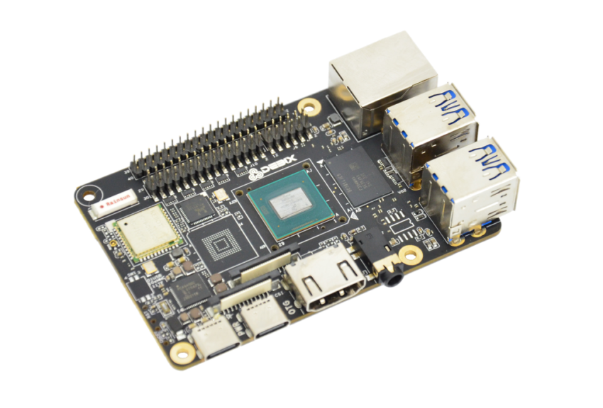

At Embedded World 2024, OKdo and DEBIX in a joint venture have announced DEBIX Infinity Industrial SBC. The SBC is powered by an NXP i.MX 8M Plus Quad Lite processor, and features dual GbE ports, dual-band Wi-Fi, Bluetooth 5.2, and many other features.
The NXP i.MX 8M Plus is a quad-core ARM Cortex-A53 CPU clocked at 1.6 GHz. It also has a dedicated 800 MHz Cortex-M7 processor core for real-time application. But the only downside of this SBC is that it does not have any NPU, ISP, or video decoding/encoding capabilities. Although there is no specific Video decoder in the SoC, the board supports HDMI, MIPI DSI, and LVDS for different display configurations.
As this is an Industrial Class SBC the paper specs suggest that it can be operated within a temperature range from -20°C to 70°C.
Taking a look at this SBCs expansion capabilities it has support for a PCIe x1 interface (accessible via a 19-pin 0.3mm pitch FPC socket) and a 40-pin GPIO header. It also includes USB 3.0 ports and various serial communication interfaces.

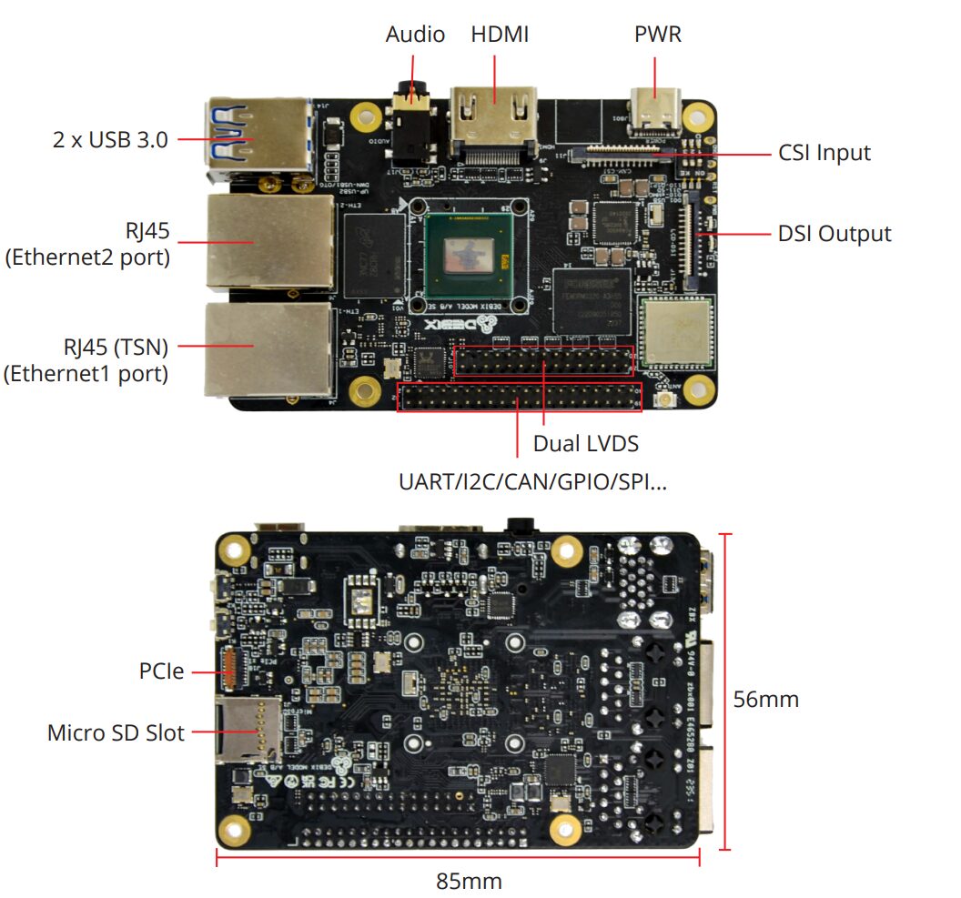

DEBIX Infinity Industrial SBC Specification
  • SoC:
    • NXP i.MX 8M Plus quad-core Cortex-A53 @ up to 1.6 GHz (industrial) or 1.8 GHz (commercial)
      • Arm Cortex-M7 @ up to 800 MHz
      • Vivante GC7000UL 3D GPU
      • Vivante GC520L 2D GPU
      • 2.3 TOPS NPU
  • System Memory: 2GB LPDDR4 (optional: 4GB/6GB)
  • Storage: Micro SD card (optional: 8GB, 16GB, 32GB, 64GB, or 128GB eMMC flash)
  • Video Output:
    • HDMI 2.0a up to 4Kp60
    • 1x LVDS header, single & dual channel 8-bit
    • 1x 4-lane MIPI DSI FPC socket
  • Camera Interface: 1x 4-lane MIPI CSI FPC socket
  • Audio:
    • 3.5mm audio jack with headphones and microphone signals
    • 1x SPDIF digital audio input/output
    • Digital audio via HDMI
  • Networking:
    • Gigabit Ethernet RJ45 port with optional PoE
    • Additional LAN port via 12-pin header
    • Dual-band (2.4GHz & 5GHz) Wi-Fi 5 and Bluetooth 5.0 via KEIIOT K019-CW43-DW module from KERTONG Polytron Technologies, ceramic antenna
  • Expansion:
    • 40-pin headers with 3x UART, 2x SPI, 2x I2C, 2x CAN, 1x PWM, 2x GPIO, 5V power supply, system reset, ON/OFF
    • 1x PCIe x1 FPC socket
  • USB:
    • 2x USB 3.0 Host Type-A
  • Power:
    • 5V/3A DC (via Type-C)
  • Operating Temperature:
    • -20°C to 70°C
  • Dimensions: 85.0 x 56.0mm
