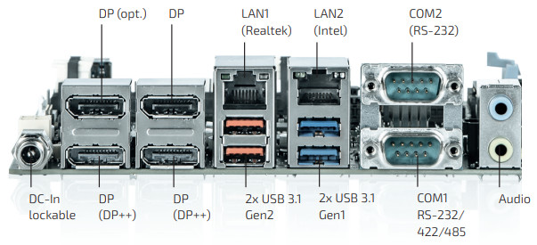

Ideal for demanding graphics applications in professional casino gaming systems, medical displays, thin clients and industrial PCs through AMD Radeon™ Vega Graphics Kontron, a leading global provider of IoT/Embedded Computing Technology (ECT), will present the D3713-V/R mITX industrial motherboard based on the AMD Ryzen™ Embedded V1000 and R1000 line at this year's embedded world tradeshow. It features the SoC integrated AMD Radeon™ Vega GPU with particularly brilliant graphics and supports up to four independent displays in 4K resolution via DisplayPorts, one Embedded DisplayPort and a dual-channel LVDS (24bit).

D3713-V/R mITX port details

The D3713-V/R mITX motherboard optionally offers different processors of the AMD Ryzen™ Embedded V1000 and R1000 line: AMD Embedded SoC V1202B, V1605B, V1807B, R1305G or R1606G. Due to the Intel® i210LM Ethernet Controller with 10/100/1000 MBit/s the board supports protocols such as EtherCAT or TSN. Furthermore it offers 2x SO DIMM sockets for up to 32GB memory. The use of a data carrier or extensions is possible via 2x Serial ATA III 600 interfaces (up to 6GBit/s), a Mini PCIe (halfsize/fullsize), a PCI Express® x4 Gen3, an M.2 PCIe x2 Key-M and an M.2 PCIe x4 Key B. It also offers various interfaces, such as USB 3.1 Gen1/Gen2, USB 2.0, serial I/O, GPIO and High Definition Audio Input/Output via the Realtek ALC256 chip codec. The board contains an AMI Aptio 5.x (UEFI) BIOS, a HW Watchdog, a BIOS integrated HW Diagnostic Tool, AMD integrated TPM V2.0 onboard, and a socket for an optional TPM module.
