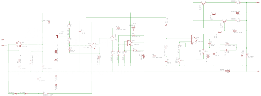

hey.
Thanks for fast replay. My 3A supply is working perfect, now i will try 5A. i did scheme for 5a, as u said, can u check scheme and tell if everything is ok?
thanks alot!

Hi Srecenvid,
The 5A version has only a few changes from the 3A version:
1) More powerful transformer, 28VAC/200VA or 30VAC/212VA.
2) Medium size heatsink for the 10A rectifier bridge module.
3) R7 changed to 0.27 ohms/10W.
4) Three output transistors on a huge heatsink with fan and a 0.33 ohm/2W emitter resistor for each output treansistor.
I didn't save the design by PicMaster. I think he changed the calibration trimpot positions and changed all the parts designation numbers which makes talking about it difficult (R7 is now his different number etc).
