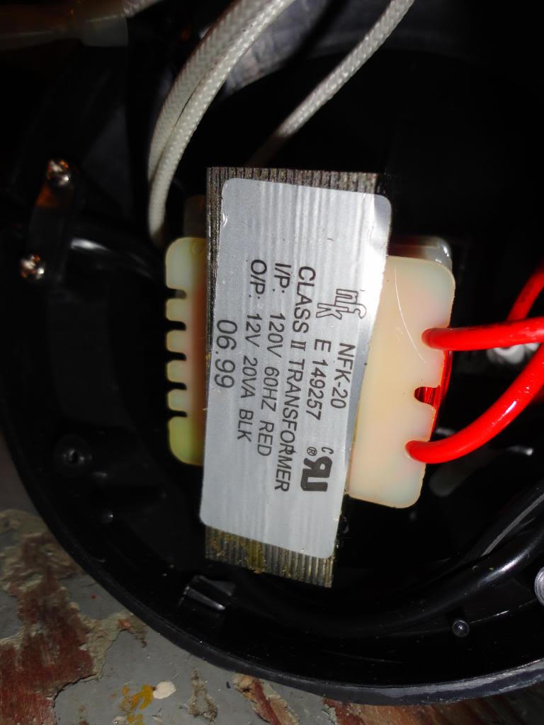

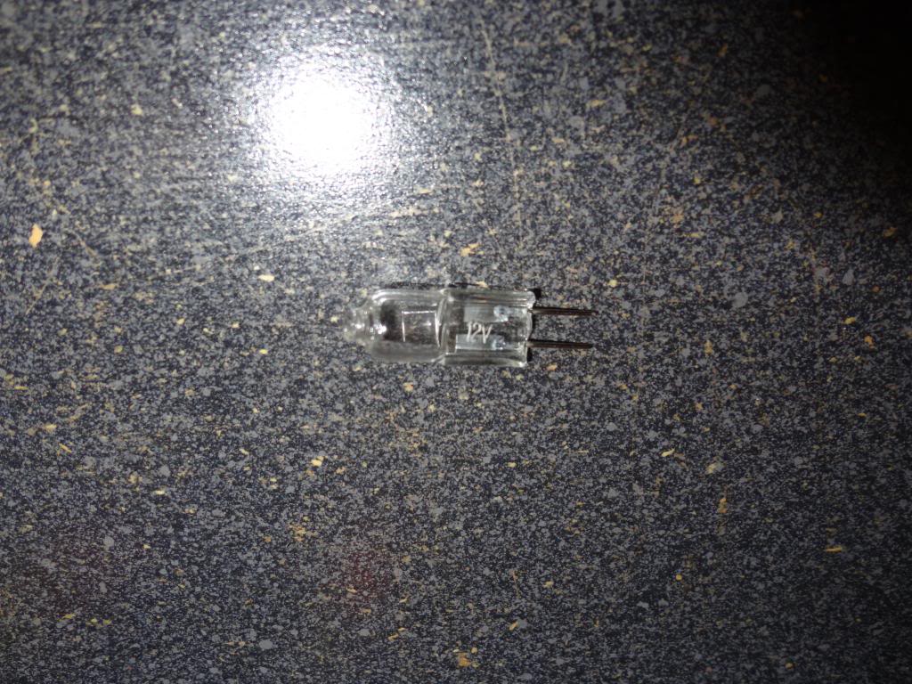

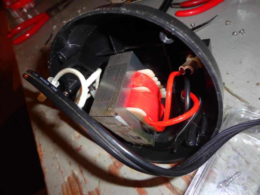

The lamp has a transformer coil inside it. I took 2 pictures of inside the lamp still unmodified (2nd and 3rd pictures below). The voltage on the load side is about 14 volts AC (measured with a DMM). Its rated "12V." The bulb looks like a car headlight (1st picture below).
In order to run an LED, I need to convert the AC signal to DC. So I figured I'd make a bridge rectifier out of 4 diodes and use a filter capacitor to smooth out the bumpy DC.
I made a cheap diagram in MS Paint to denote the modification I plan to do (the 4th picture below). I plan to cut the output lines coming out of the transformer coil (that originally go to the bulb) and solder the home-made module there. The home-made module I'm adding is drawn in blue. It entails the bridge rectifier, the filter capacitor, and the resistor.

- The bulb is a 12V incand/filament bulb. The lamp hood says, "Use 12V/20W JC Type T or Smaller <bulb picture> G4."

- The measured output voltage on the load side is about 13.8VAC. I measured this by sticking the DMM probes into the socket holes where the bulb plugs into.
