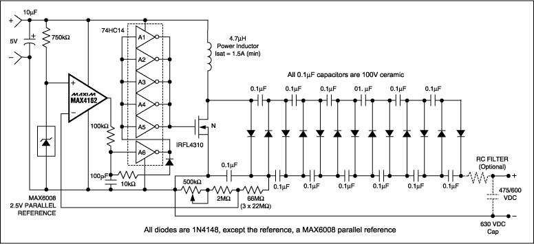

Do you think a boost converter such as this could possibly work? (I have all the necessary components)
Taken from Here.
Or is the current too low... Perhaps it can be slightly modified.
If not, can you point me to a better idea?

That's one option, but if you google for a dc-dc switch mode boost converter you'll find better circuits.

The calculations would be different for a boost converter. I suggest you try that out as well to see if it is feasible and what kind of inductor you need.
