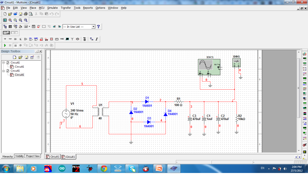

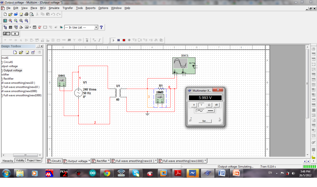

Is this consider as stpe by step seperate circuits used to build up a AC to DC power suppply ? I wish it is and I get what my lecturer want so that I didnt waste my time on it. No matter how my friends and I do, always wrong. So I hope that I am correct this time. This is the lab sheet for the project :)
Labsheet :
Sorry that it is in malay ><
step 1 : Output voltage from rectifier
I manage to get 5.999 from a 6V trasnformer

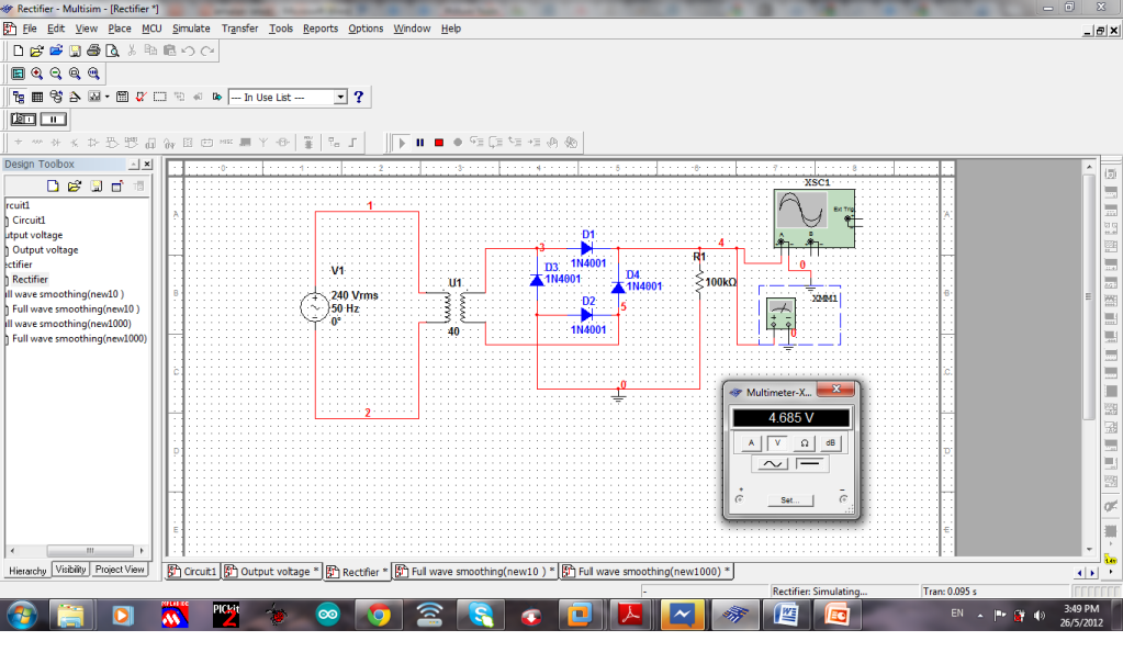

step 2 : Rectifier using 4 diodes as bridge
Output voltage meausred from multimeter = approximate 4.6 ( 6 - 0.7x2)

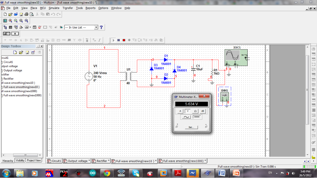

step 3 : smoothing(adding in a 10uF) Capacitor
Output voltage meausred from multimeter = 5.636V ( why increase from 4.6 to 5.636 ??)

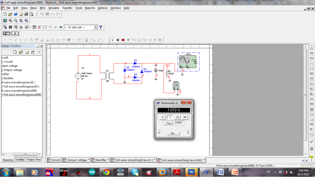

smoothing(adding in a 1000uF) capacitor
Output voltage meausred from multimeter = 7.073 ( why higher ?? Average voltage ?)

that looks good the way you have looked at each section (not being your teacher, I cant say exactly what he/she expects from you)
do your simulation, with an oscilloscope across the output of the bridge rectifier and see what it shows you... hopefully it will show what I am expecting, I will await a response from you befor posting a pic

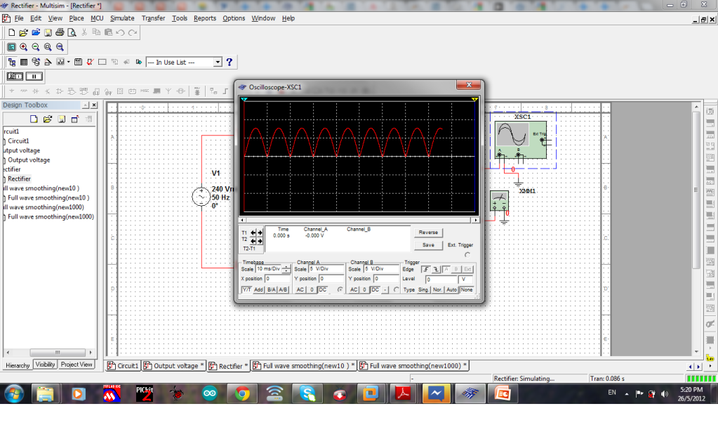

Yea..The oscilloscope show the output I expected. Sine wave, then sine wave with negatie side flipped then a DC with ripple :)
davenn
Sep 5, 2009
14,487
Sep 5, 2009
14,487
ok excellent
so you can see that altho we call that a DC output from the rectifier, its pretty unstable, varying in pulses from 0V to max volts
ok now stick you 1000uF cap across the output and look at the waveform again
what do you get ? ( again post an image ) :)

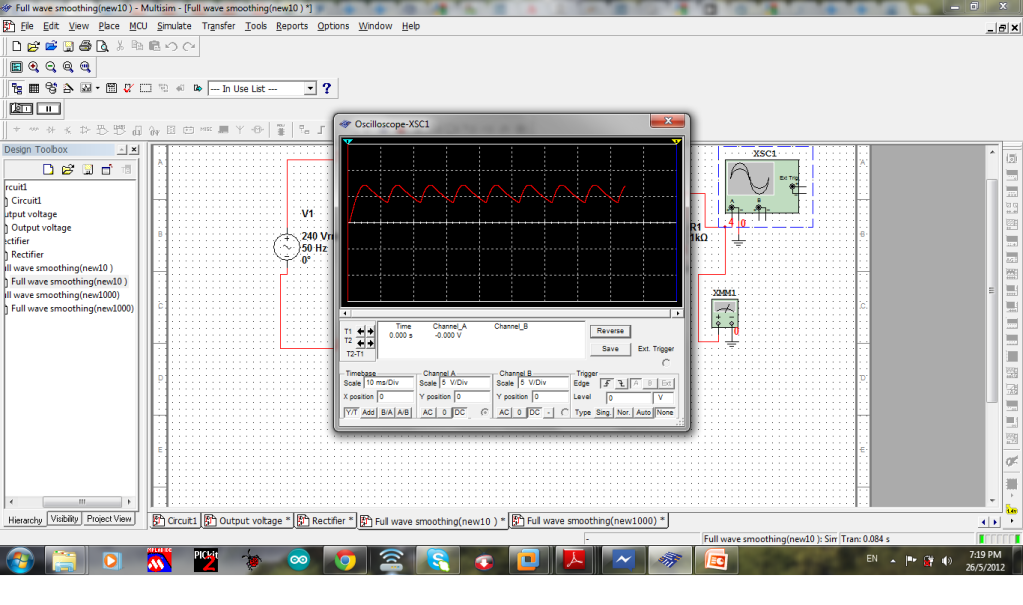

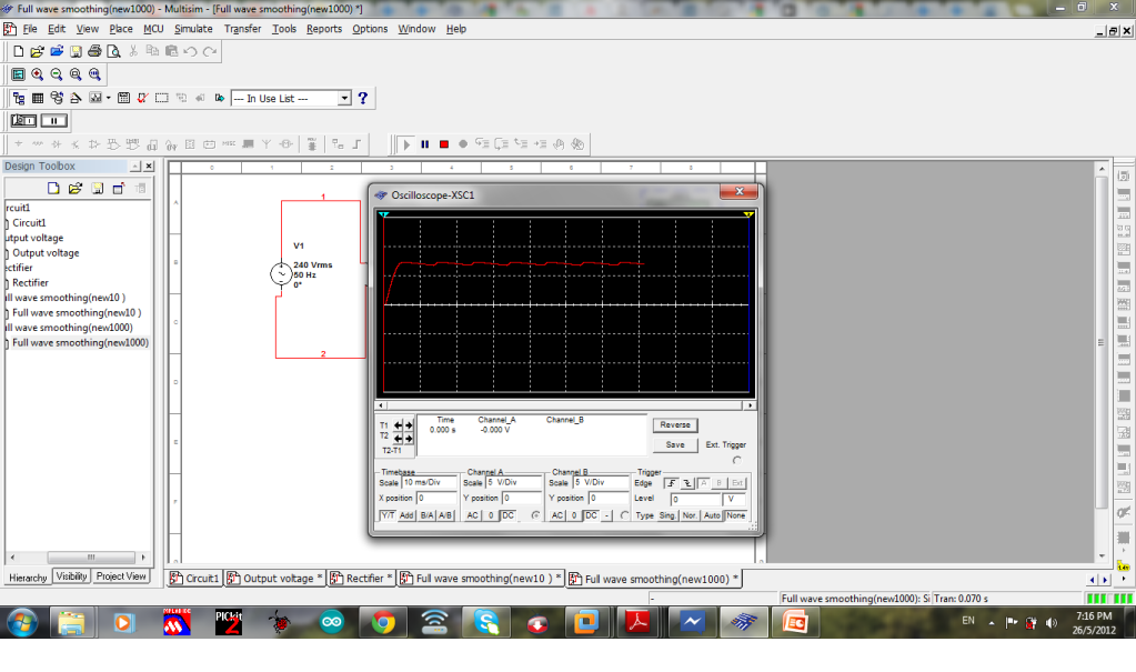

Waveform with a little bit ripple if I use 1000uF capacitor. How does the capacitor do the smoothing process ?
Below show another smoothing action with 10uF capacitor which shows a poor smoothing effect.
My question is that, why when smoothing, the voltage will be increased ? After rectified, the voltage will be around 4.6 . But why when smooth with 10uF, the voltage go to 5.5+ ? and when with 1000uF, the voltage rise to 7.0 + ? WHY ?
Thank you

hi Vick
your scope is showing you the peak voltage out of the the transformer, where as the transformer is usually rated by its RMS voltage. That is.... if you transformer has an output of 10VAC... that is its RMS voltage. Its peak voltage is the RMS value x 1.414
your DC voltage out of the rectifier is the RMS value minus the voltage drop in the diodes ( ~ 1.7V for 2 diodes). You need to remember that the diodes are only conducting current in brief bursts. And when you add a capacitor to the output, the current through the diode charges up the capacitor, which then slowly discharges through the load till the next burst of current from one of the diodeson the other 1/2 cycle.
So the capacitor is holding up the voltage during the time that the diodes are not conduction. If you have only a small capacitor, then the voltage is going to drop more ( cuz it holds less charge) than a larger capacitor.
this is where your ripple comes from....
The rectifier diodes will charge up the filter capacitor, to the peak DC value, and between non conducting cycles of the diodes, it will discharge into the load resistor. This creates the sawtooth waveform known more commonly as ripple voltage. The value of the ripple voltage is dependant on load current, power supply frequency and capacitor value. Approximate ripple voltage is calculated using:
Δ V = I / 2fC
where V is ripple voltage (mV), I is DC load current (mA), f is frequency of AC supply and C is smoothing capacitor value (F).
have a ponder on that.... I need to go out for some hours

hey, how does the load resistance affects the output waveform ?
See below :
This is produced when I have a 1k ohm load with 10uF capacitor
This is produced when I have 10k ohm load with 10uF capacitor
Any idea?
Any idea?
Thank you
basically, the greater the load (the lower the resistance) there will be more current
flowing so therefore for a given value of smoothing capacitor, the more difficult it will be to maintain that output voltage between peaks and the output DC voltage will drop. The ripple voltage will increase and you will need a larger capacitance to hold up the voltage between charging cycles from the diodes.
You can see that in your sim's where there is a larger current flowing through the 1k resistor than through the 10k resistor. And as a result the ripple is higher when there is only a 1k load across the supply.

I didnt get you.Why more current the output DC voltage will drop ?
davenn
Sep 5, 2009
14,487
Sep 5, 2009
14,487
because as the current increases, the capacitor struggles to maintain the average DC voltage. It results in a voltage drop, mainly caused by the increase in ripple voltage.
So as you again increase the value of the capacitance to overcome the increase in ripple voltage, it also has the effect of holding the average voltage up.
