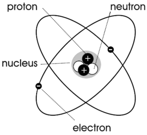

Hello,
We generate electricity from Hydro power DAM /photovoltaci cell and then we get fan rotating.
there is circulation of electron after fan where it go?

Generating electricity doesn't actually create electrons; it just causes existing electrons in conductors to move around a circuit.

So, we have lots of electron near us? ...
Electrons surround every atom in everything. The electrons in your feet (or shoes) support you because they are repelled by electrons on the ground beneath your feet. We live on a sea of electrons that shield the positive nucleus of every atom.
more than you can count
do you know what an electron is ?
