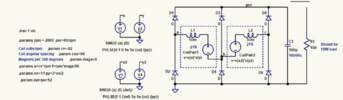

Here you go, assuming the 120 degree offset:

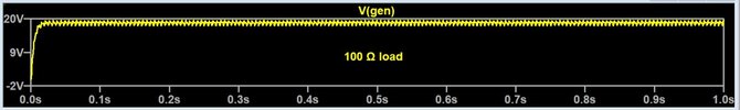

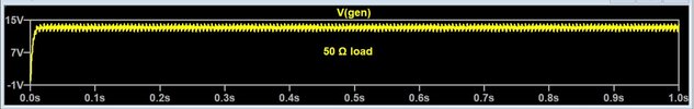

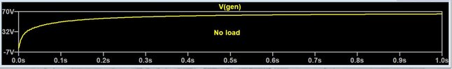

The generated voltage using the four 54 Ohm coils arranged as two pairs depends a lot on load, as the traces below show :
In practice, allowing for an ~85% efficient inverter, the power required from the generator will be ~18W, so even with the present coils parallelled it doesn't look possible to provide that unless your wheel rotates at an alarmingly high speed.

why is the 100 ohm resistance run at a higher voltage than the 50 ohm? thanks

Is this taking into account the 50 ohm of the resistance of the coils? nevermind says 27! what is the 50m part and what is (v) for on the what is (a) and (f) nad what is (pp) and (del) going to measure the voltage of the new 7 ohm coil and see what it puts out!
Ohm's Law. 100 Ohm load means less current draw, hence less voltage drop across the internal resistance of the coil.

what is cv -= 0.2 mean
Output voltage of a coil is proportional to rate of change of flux, hence wheel rotation rate. My sim was based on an assumed 40V peak out for a 2000 rpm speed, hence a conversion factor cv = 40 / 2000 = 0.02. Your mileage may vary.
