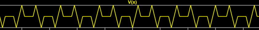

From the above pic it seems an N pole will be passing all four coils at the same time. Is that what you want? This should allow for a greater current by parallelling coils, but at the expense of greater ripple in the voltage. Isn't it usual with this type of generator to have a magnet number which is not an integral multiple of the coil number, to minimise ripple?
By having alternating magnet poles per face of the disc I think each coil will produce an output voltage vaguely like this (but with more rounded peaks) :
yes this is the correct wave I think do you mean that I should have more than eight magnets either side? It's possible to be 10 on either side I think

that wave you mentioned I like the look of it
The wave won't be a true sine-wave, because the coil inductance will vary as a magnet moves near it and the coil energisation is discontinuous.
