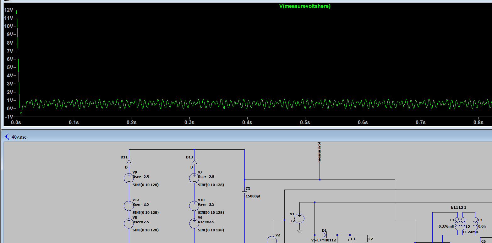

oh ok that L5!! so is that wired up correctly because this image looks wrong to me surely it should be more voltage!!??!! 1727291302019.png
Alec_t
Jul 7, 2015
3,821
Jul 7, 2015
3,821
It would be if the bottom of that set/array of coils had a connection to ground.
But the reactance due to all those coil inductances forms a voltage divider with the load they're driving, so the voltage across the load is lower than you're hoping for.
Edit:
As the coil voltages are being only half-wave rectified, that's another reason for low output.

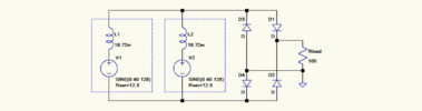

Since all eight coils are nominally the same you could sim the combination like this:
The contents of a dotted rectangle represent four coils in series. Rload is arbitrary here.
Alec_t
Jul 7, 2015
3,821
Jul 7, 2015
3,821
Use the inverter circuit as a replacement for Rload.
I think reality will differ from the sim significantly because (a) the coils are not identical, (b) they may be slightly out of phase, (c) I suspect they have greater inductance than the values you are currently using in the sim.

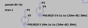

"some points:
1) if the supply of the logic chip (that generates the signal) is 3.3V ... then the signal itself will always be less!
2) to me it seems the V_IH for 5.0V supply is about 3.5V according the diagram. Mind: vertical it´s 3V/div
3) if your weigth is 80kg ... and you go on a bungee jump ... and they say the maximum the rope can handle is 80kg .... would you do the jump?
Some hobbyists may have no problem with it...
But for me - as a designer for reliable industrial electronics - this is an absolute no go.
One has to consider that the supply voltage (3.3V) will have initial tolerance, thermal drift and drift with load. So in worst case it may be 15% to 20% less than nominal.
And also the supply voltage (5V) and the thresholds of the IR2110 will drift (to more positive in worst case)
If you get 3.3V (nominal supply voltage) signals and you want to feed the IR2110 (5V supplied) .... I recommend to use an 74HCTxxx logic device (supplied with 5V) as level shifter."
what are your thoughts on that Mr Alec_t
I have a 75HCT chip to hand here is the circuit that I have right now forgetting the coils and such lets just say that its a 12v source, so, when I set the VDD to 5volt the circuit doesn't work if the signal is not also 5volt but in reality I want the signal voltages to be approximately 3.3volt because that is the max that it should be!! thanks 1727456127939.png I know that it is stupid but this is correct right1727457153553.png
