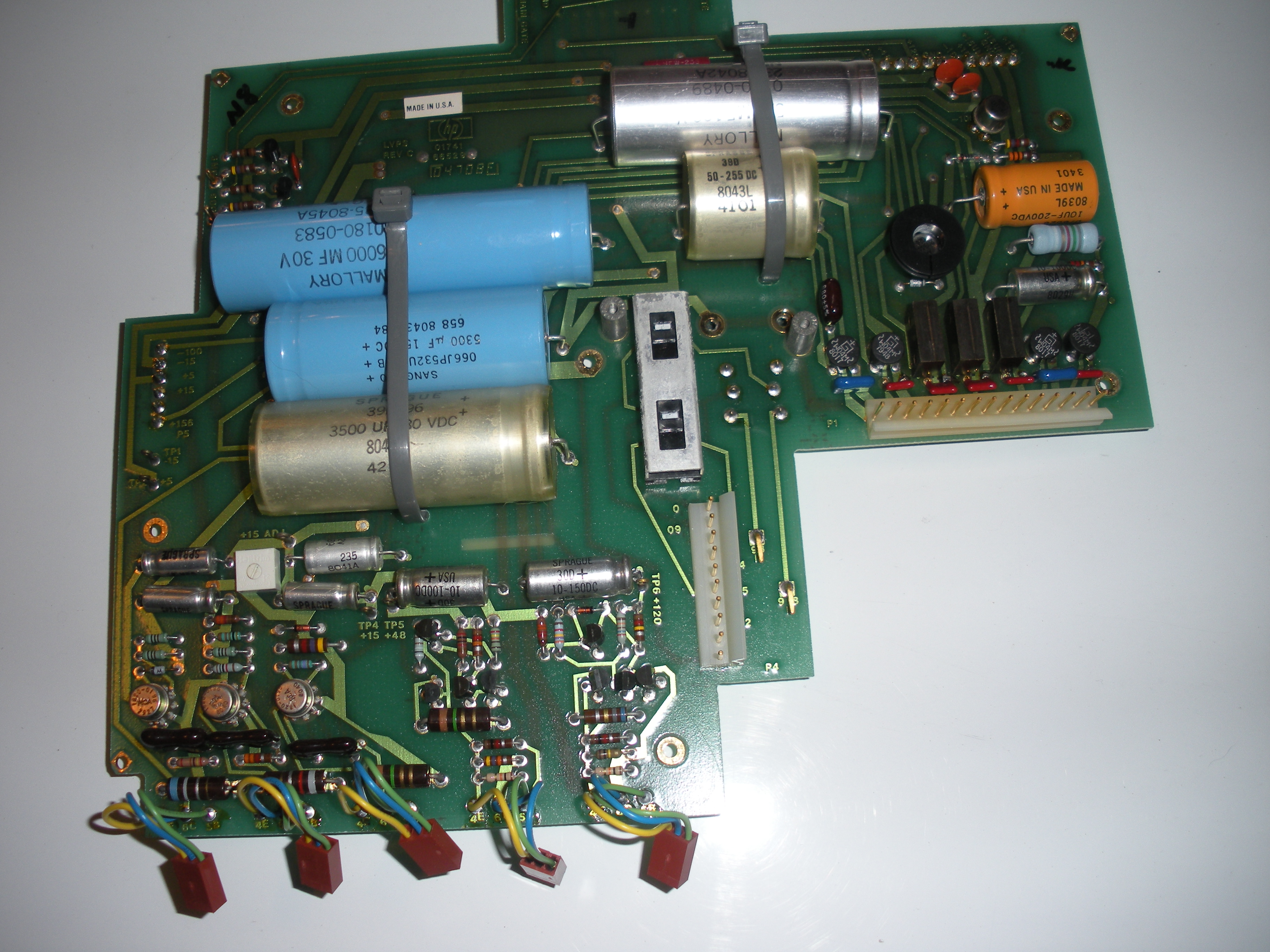

Perhaps I wasn't clear enough about where to connect the negative multimeter lead. Try this.
1. positive lead to Q1 base; negative lead to 0V (available at bottom end of R6)
2. positive lead to Q1 emitter; negative lead to 0V (available at bottom end of R6)
3. positive lead to Q2 base; negative lead to 0V (in other words, measure across R6)
4. positive lead to Q4 base; negative lead to right end of R2 (in other words, measure across R4)
5. voltage across R2.

OK. I can translate those measurements into descriptions with reference to the picture you posted in post #60.
First we need to fix the markings of Q2 and Q3 on that picture - you have them swapped over - and add markings for the other components. Can you post an unedited copy of the original picture? I will mark up the component references and repost it, along with instructions for where to measure.
KrisBlueNZ
Sadly passed away in 2015
Nov 28, 2011
8,393
Nov 28, 2011
8,393
OK. Here are the measurements I need.
1. Positive lead to R1 east; negative lead to R6 west. (Q1 base wrt 0V.)
2. Positive lead to R3 east; negative lead to R6 west. (Q1,2 emitters wrt 0V.)
3. Voltage across R6 (positive to east end). (Q2 base wrt 0V.)
4. Voltage across R4 (positive to north end).
5. voltage across R2. (positive to north end).

I took each measurement twice, second time using low voltage mode for higher precision.
First reading was 1.6, second reading 1.93
First reading 1.4, second fluctuated between 1.35 - 1.36
First reading 0.7, second reading 0.75
First reading 0.2, second 0.207
First reading 0.1, second 0.16

Hmm. Those voltages don't entirely make sense. It looks like something is pulling the voltage on Q1 and Q2 emitters down, but it's pulling it towards 0V, not towards -160V which is what I would expect if Q1 or Q2 were shorted or leaky.
Can you make a few more measurements please?
1. positive lead to R3 east; negative lead to R5 east. (Q2 base-emitter.)
2. positive lead to R3 east; negative lead to R4 north. (Q2 emitter-collector.)
3. positive lead to R1 west; negative lead to R6 west. (15V rail incoming.)
0.602
182.8
14.6

Well, I'm not sure what's going on with the circuit. But this back-and-forth is a very slow way to figure it out, so this is what I suggest.
First, R1 could be faulty. You can replace it with a 33k 5% resistor; it doesn't have to be 33.2k and it doesn't need to be highly accurate.
If that doesn't help, I suggest you just replace all of the small semiconductors on suspicion, since they're pretty cheap. The replacements are:
A16CR8: 1N914
A16Q1: MPSA92
A16Q2: MPSA92
A16Q3: 2N3904
A16Q4: MPSA42
The 2N3904 is extremely common and should be available from Radio Shack or whoever, but the MPSA42/92 are not so common. If you have a specialist electronic parts shop nearby, try them. Otherwise you might need to mail-order them, and the freight charges can be pretty high. If you have to go that route, get a few extra of each type, and a few 2N3906es as well.
