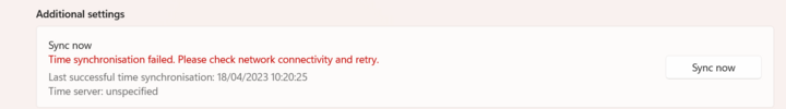

1716663197367.pngI think the time setting is fudging it the clock wont set!!

I'm not an expert but it's something to do with the certificates and actual time1716665060066.png

Hello,
You can always set the time manualy.
Bertus

tried it, believe it or not I've been getting this error on certain sites since I've had my connexion kinda just gotten used to it although you given me a few more options to explore I think I've spent enough time trying to fix it and geting on with it regardless but again thank you for the time and effort. If you have any info on the cam normal to force of 3.05Newtons (what torque I'd need) I'd be well happy
