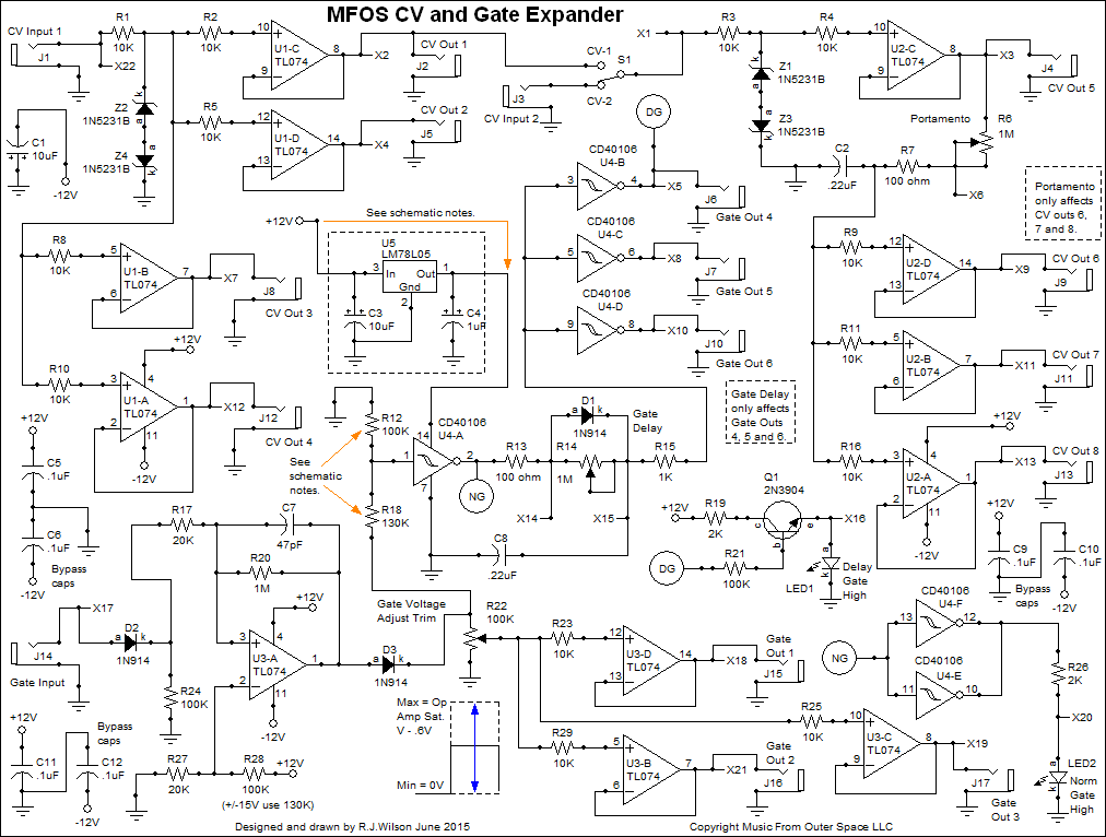

The circuit i am having problems with is a "Music From Outer Space, CV and Gate Expander module". http://musicfromouterspace.com/analogsynth_new/CVNGTEXPANDER2015/CVNGTEXPANDER2015.php
Here is the schematic;
And panel wiring;
The issue that i am having is that I am reading 5v on J10, J7 and J6. Also 5v on Led 1 (x16)
I have the a duplicate of the module that is working and thought I'd just be able to compare the readings to figure out where i have gone wrong but 4hrs later and i'm non the wiser so thought I'd ask here.
I've compared all wiring several times and nothing appears to be different between the two modules.
All pots are turned anticlockwise to the furthest point. Switch 1 is switched to CV1
The working module will be (A) and the faulty module will be (B)
U1 and U2 have the same readings on their pins for each circuit.
U3 has slight inconsistencies, scroll down
U4 has the most inconsistencies and appears to be the area where the fault is, scroll down

U3 has inconsistencies on some pins;
1. -10v

U4 is where the fun begins with inconsistencies and where I suspect I've gone wildly wrong and haven't been able to work out how.
1. (A) -00.1mV (B) 0.1mV

I also removed U4 and took readings from it's respective pin sockets.

Q1.
C. 12v
B. (A) 001mV (B) 5v
E (A) no reading, or i'm miss interpreting the DVM, the screen falshes on and off with a reading of :0L (B) 5v
What have i done?
I swapped out U3, U4 and Q1 for known good ones to no avail, no surprise there. I checked all components to make sure i hadn't made a mistake several times (but this was after a few hours of fault finding so i may be mistaken, I checked all wiring.
I have tried both modules CV and Gate function. I get no gate delay function on Module (B)

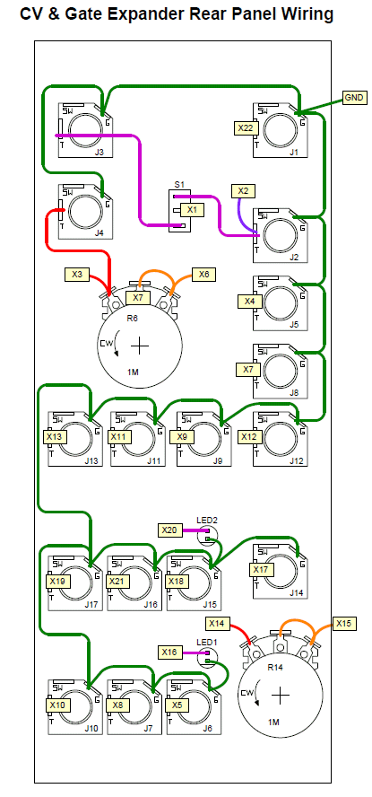

I also noticed that the portamento function seems to be a bit limited in that there is only a tiny bit of change for the first bit of movement for the potentiometer. I am concerned that the panel wiring diagram is incorrect. In that connections x7 and x6 should not be connected as shown.

Drew out the schematic this morning to make notes, got around to testing module B and it suddenly started working. Possibly I hadn't secured a component properly. Anyhow, apologies if anyone had spent time reading this. Concerned the problem may return. But for now it works and have resoldered all components for the gate delay section. So fingers crossed.
darren adcock
Sep 26, 2016
463
Sep 26, 2016
463
Cold solder on out of R13 before R14, D1 and x14 connection was the culprit. Must remember to check soldering more thoroughly when debugging.
